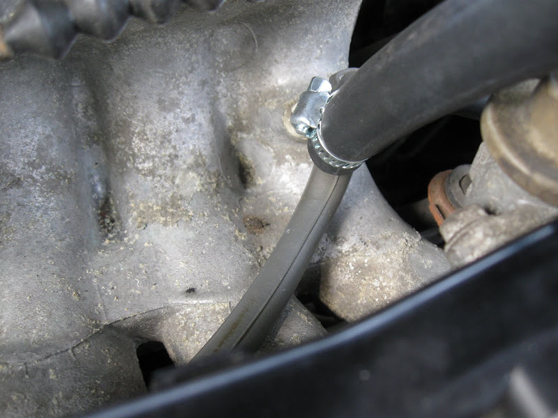

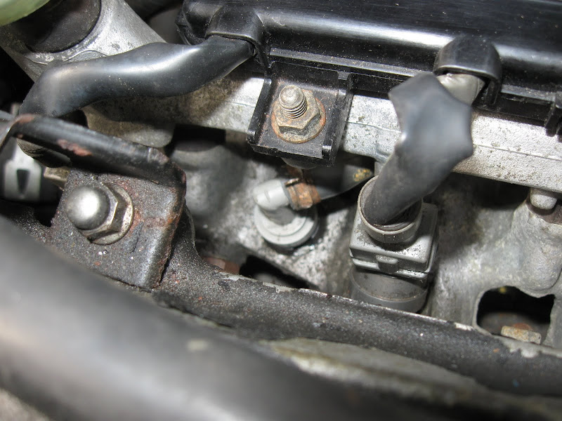

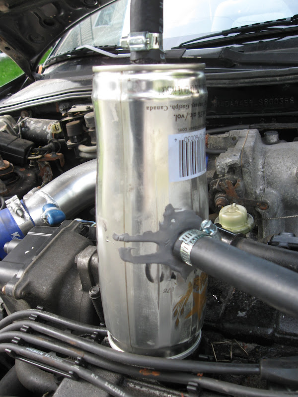

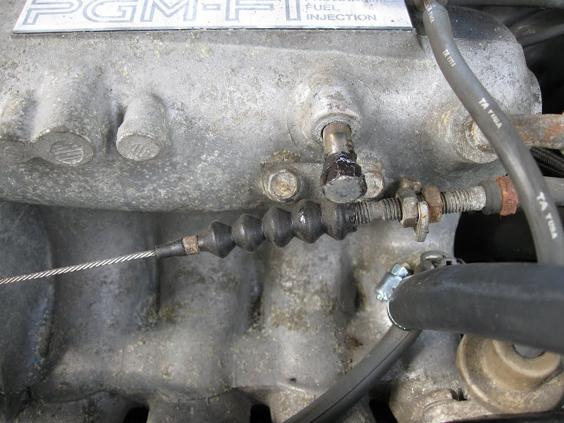

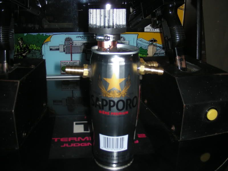

Yo, here is my rhmt beer catch can setup.
It is a Sapporo JDM (I only put JDM in my car ;) ) beer can that is very thick. Can itself weight about 100g.
I cut the stock PCV valve to remove the spring and sleeve then I hook up a 1/2 hose to the catch can.
The vacuum source is preturbo. I used the stock plastic intake and JBkwik a 90 to it. I don't know if the intake pipe is long enough to produce Bernoulli effect tho... I kept the stock PCV valve hose cause I bought the wrong 90 fitting size and I was too lazy to return them lol

so i gotta ask a newb question. where do all the other hoses go. and what are they for.
yes i looked at the pics but thats all greek to me.
my catch can is just a hose from the valve cover sticking into a water bottle. not sealed or anything.
most homemade thing ever. it took like 37 seconds to build.
