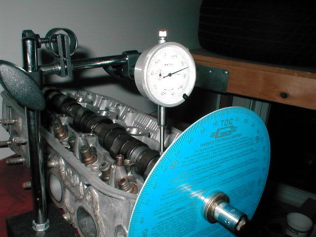

One the cams, yes I know. I believe I measured the B1 cam, but it sucks.  B2 and B7 cams are the same.

Nope, it was a B2 OEM cam, I still have it. 90 DX motor got sludged, supplied no oil to the cam and it seized. The car was serviced by local Honda and the head was replaced. I got the old B2 head. Still have the cam and head.
Made a great fixture.
About the B7 springs being better.....depends on when Honda changed oevr to use up old stock. 1992 and early 1993 production used D15 springs, but at some point in 1993 Honda started using D16A6 springs which are slightly stiffer.
