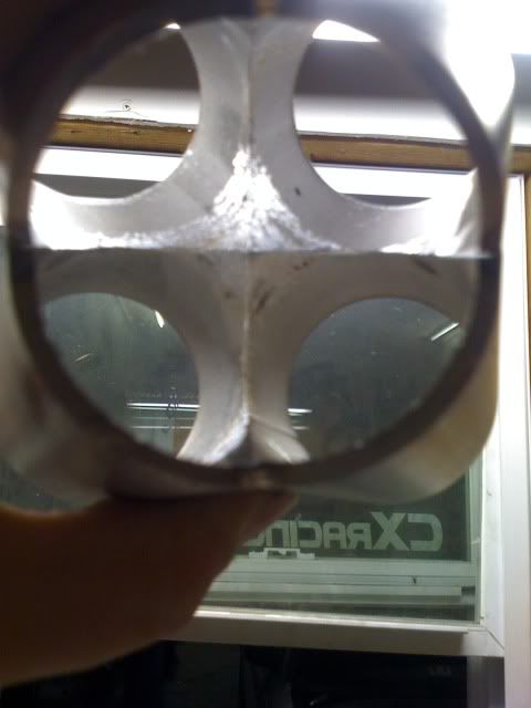

6.After the first angle is cut on all 4 pipes you may be left with a small step at the end of the cut.
To flatten it out I just put it on the belt sander to smooth the last bit out.

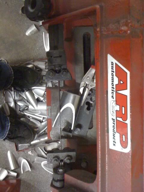

Here is a comparison of before and after.
Be sure to deburr the inside of the cut as well.

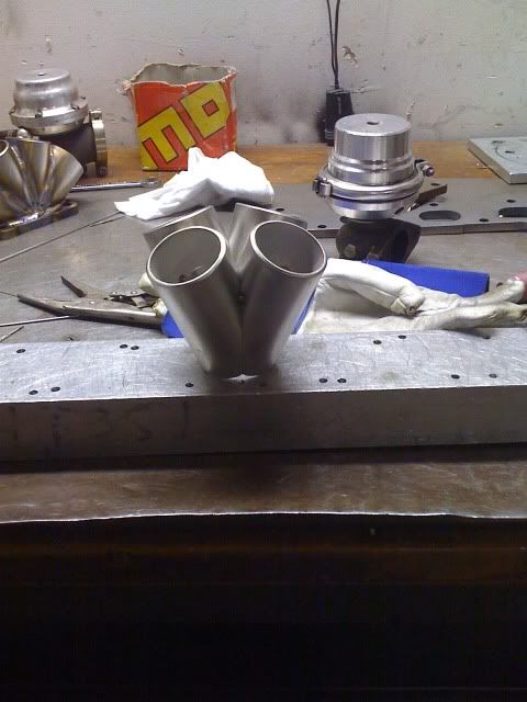

11.The end result should look something like this, but you aren’t finished yet.
When you lay the flange over top of the collector pipes it should sit flat and if your measuring was on, it should poke inside the inlet slightly on the sides.
There are a couple different ways to flatten these out.  One way is to just squeeze the sharp points flat in a vise.
Another way is to partially weld the pipes to the flange and use the round end of a ball peen hammer and hammer them out to match the port in the flange.  I usually do this to push the pipe out of the port in the corners.  The end result should look similar to this.
12.The finished collector should look something like this.

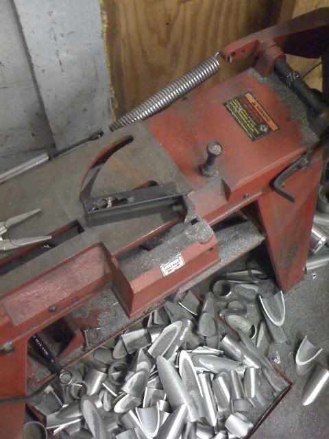

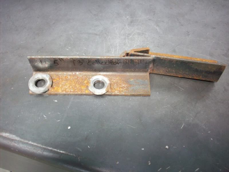

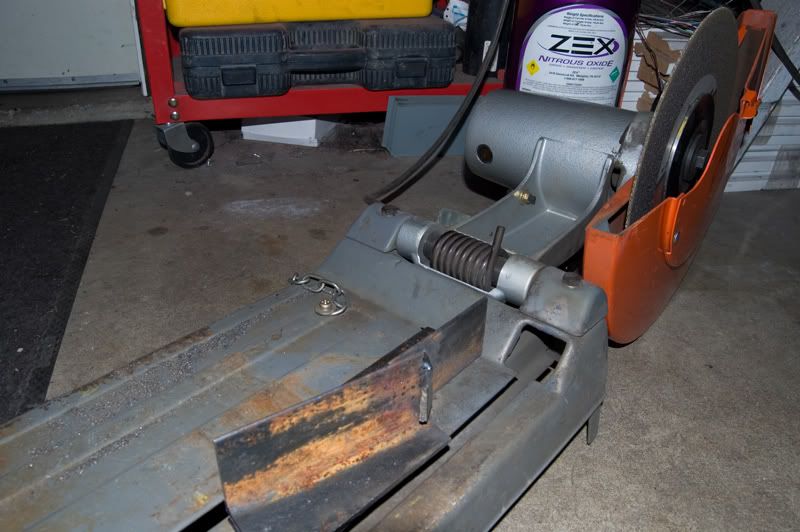

ok here is one of my jigs, there not perfect but they work fine.
ok here is the jig, i used washers to locate the jig onto my band saw.
here you can see how you mount the pipe onto the jig, the tab on the right acts as a stop and holds the front of the pipe. make sure you can clamp so the pipe stays flat. i have made this mistake before and it ruins your repetability.

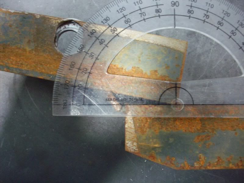

After your first cut rotate the pipe 90*. now i don't get to high tech here, just turn the pipe untill it is level on top.
you can use a protractor to get close on the angle of the cut needed.
eh hope this helps

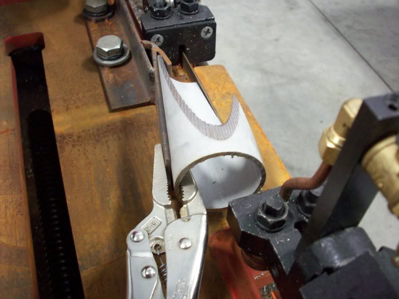

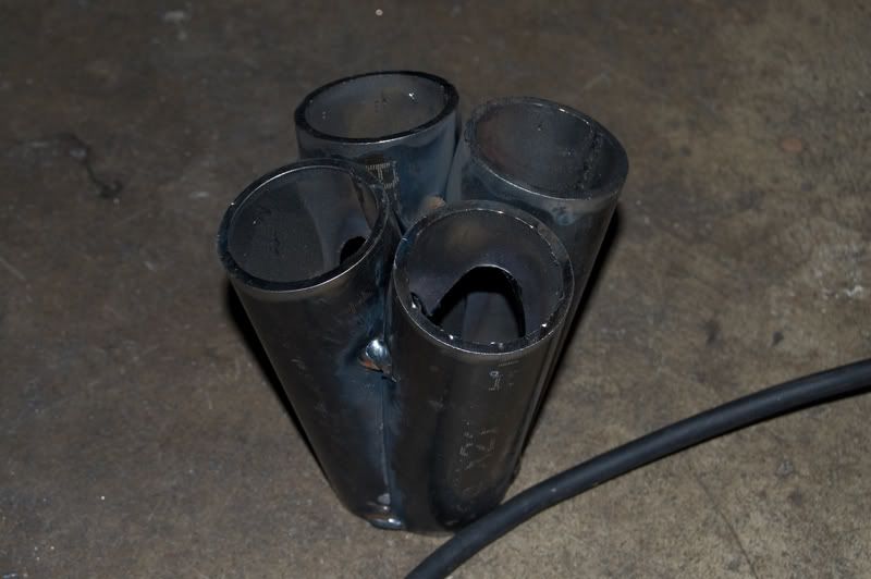

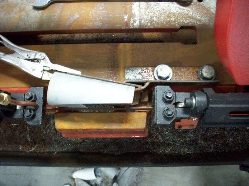

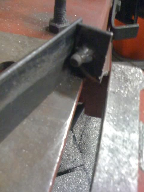

i took some pics of my jig and the end product tonight because i was in a picture taking mood.
jig is just a piece of angle iron with a piece welded at the end for a stop and a nub of 3/8 round stock to hold the pipe in place, and a pair of needle nose vise grips on the other end to keep it clamped. all the holes on it are for different angles for collectors which i do by eye.
this is the second cut on the collector which is supposed to be 90* fromt he first. i dont have any marks or stops for this cut so i line it up by eye cause im good like that. i highly doubt anyone could use my jigs but me because of this.

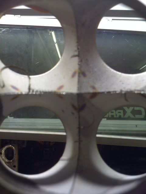

finish cut and just tacked together before and after being deburred.
all this is done a $200 harbor frieght band saw that ive had for a few years now. still cuts great.
