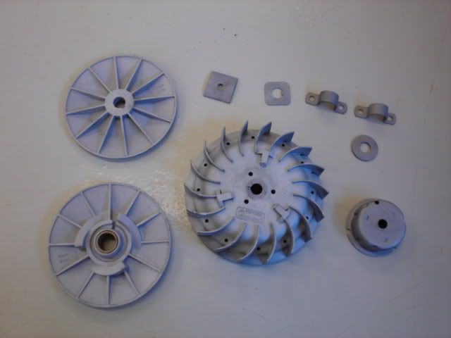

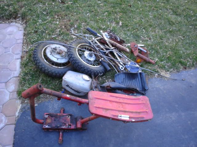

Just a little update its all ripped apart and getting ready for paint and a rebuild on the motor:

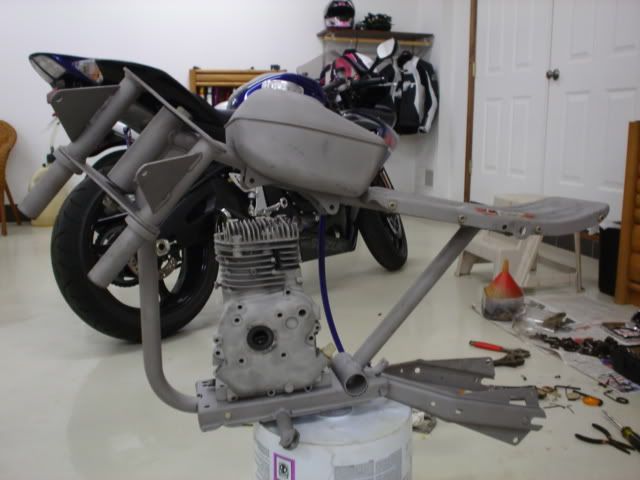

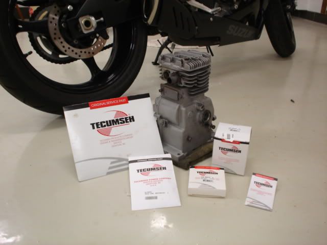

Just a little update everything came in to rebuild this pig:
I also just finished sandblasting more frame parts:

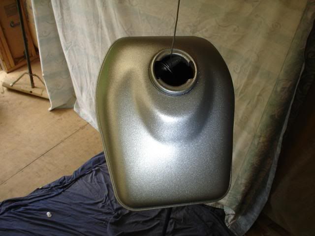

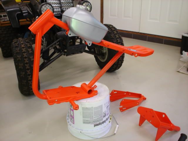

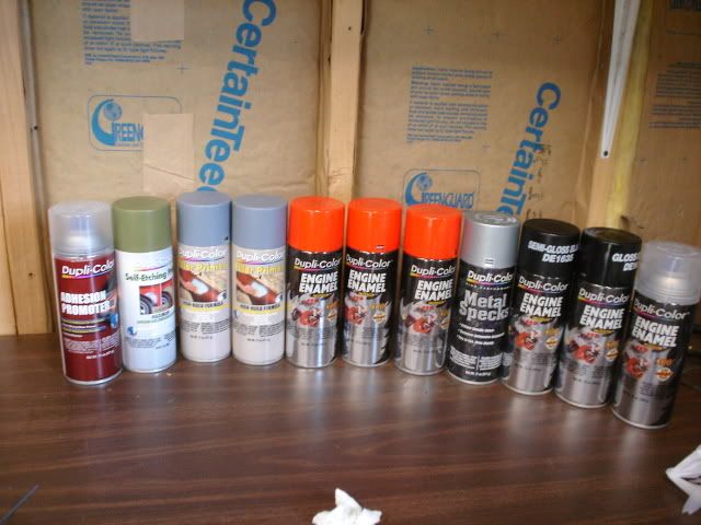

Just a little update, painting process has begun.  Went and bought some paint:

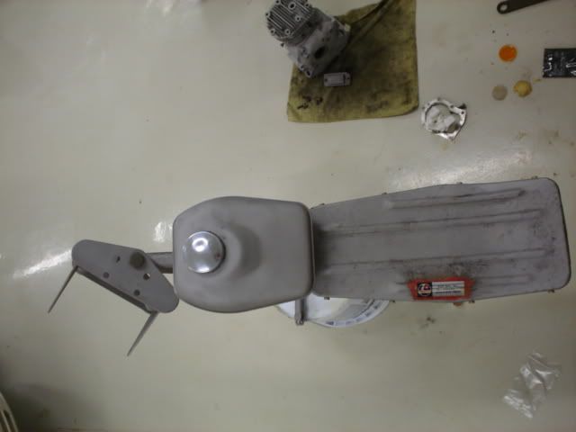

Primered parts:
Painted the tank with the metal speck silver:

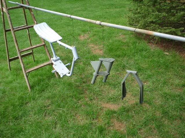

Frame parts:

« Reply #49 on: May 19, 2009, 06:32:40 PM »
For the chrome fenders, you'll have to put some serious elbow grease into them. Start sanding. Start off with 800 or 1000 grit and work your way to the finest grit you can find. Then polish it using various stage polishing compound/liquids. It'll turn out like glass.  :yes:
Sweet project.

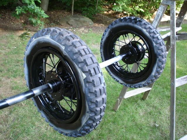

Progress has been slow on this thing but I'm getting my act together to finish it.  I finally got the wheels disassembled, sandblasted and painted.  The drum brakes were siezed together becuase of all the rust and was a fucking pain in the ass to separate.  I didn't dismount the tires so its like a Macco job where they paint your tires for free:

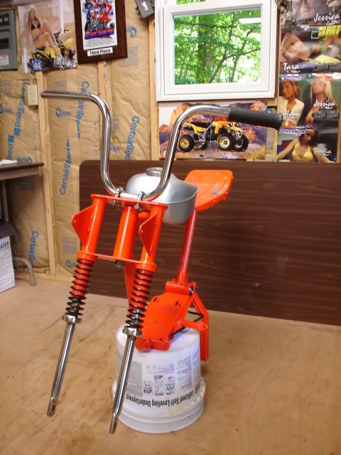

Here's how it sits today:
