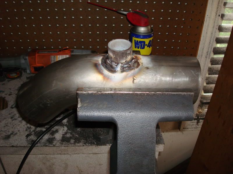

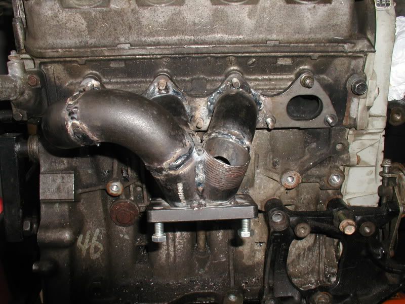

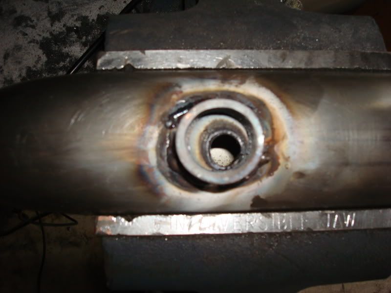

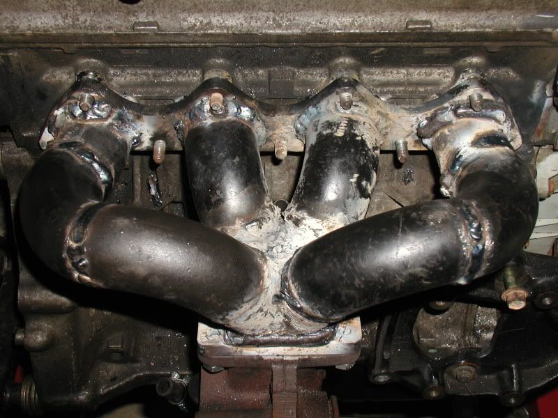

Update
3 out of 4 ain't bad
Finished, and don't worry Hotrex, the threaded part wasn't hard to weld to at all
Just need to get rid of the slag and clean it up a bit
Anyone have any suggestions for a high temp paint that will actually stay after use?

nice job on the mani
where did you get the bends?
Re: 350 or Bust - Love me some D Manifold = Done like a cake
« Reply #97 on: July 29, 2009, 09:39:46 PM »
Ace Stainless like a year ago.  The ELs and the straights are sch. 40

im sort of a newb in the welding department, what are the strength differences between what you have hear and say something tig welded? i can mig weld and id like to make my own manifold but im not sure if id just be wasting the money if the thing is going to crack every 10 mins.
90 hatch
« Reply #99 on: July 29, 2009, 10:21:10 PM »
You can have something crack no matter what process you use.  If it is a quality welding job (i.e. proper filler material, proper voltage or amperage setting, proper flux or shielding gas) then it doesn't matter what type of welding takes place.  I have the ability to arc weld, and that's what I feel the most comfortable with so that's what I used.
I feel sure there is a more technical answer, but for what I'm doing and probably what you would be doing, how you weld is way more important than what you weld with.

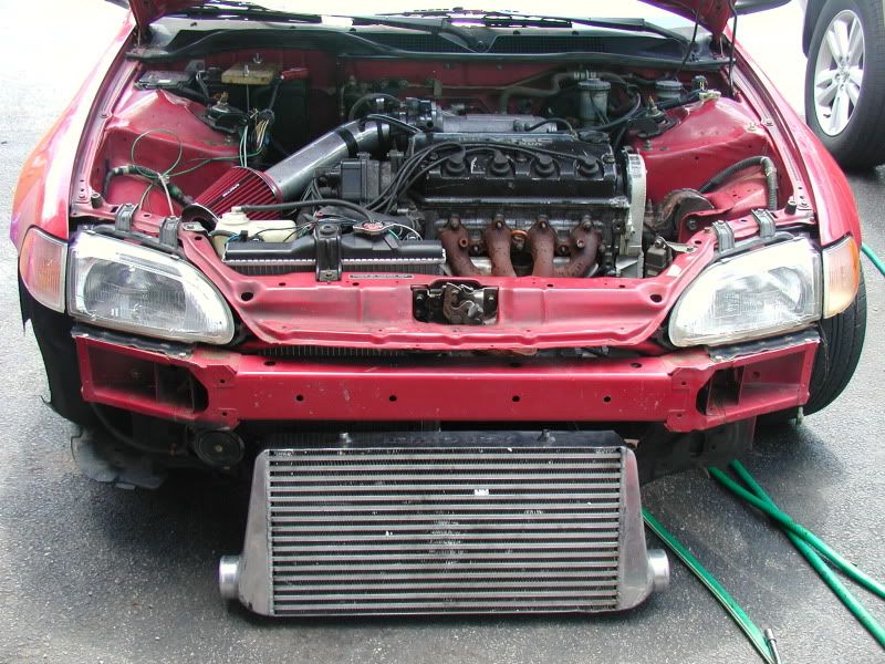

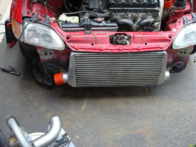

Huge 23 lb. intercooler bought off ApexSilver06MR for 100 bones shipped.  Great guy, great transaction.  It's in used shape but thats fine with me.  I plan on straightening out the bent fins when I get some free time
I had a bumber from a previous build that had most of the back cut out, just had to trim a little lower and it fits like a glove.  And of course, it started pouring right as I was finishing up
I had to remove the bumper support, trim the lower raidator support, and trim the upper rad/hood support to get it to fit like I wanted.  Here's a shot of how I attached it to the chassis.  I was pleased with how it turned out

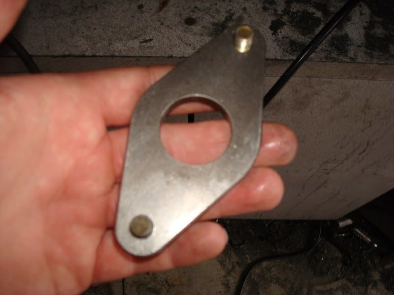

Thats all for now.  Plan on starting the charge piping soon.  I need a HX/HY-35 outlet flange with a 3" hole so I can make an exhaust.  The other option is if someone has a 2.5" v-band assembly for cheap or even a used one foot pipe with the 2.5" v-band on it I'd be able to use the stock cast outlet flange.  Let me know what you got.

do me a favor? see that relay hanging of the back side of your drivers headlight? remove it and the wiring that attaches to it... just fallow it till it hits the harness on the pass side, save you 2lbs ::) and look cleaner since its for AC, and you dont have it...
btw looks ghetto, congrats... :yes:
Re: 350 or Bust - Love me some D: Interfooler mounted
« Reply #106 on: August 02, 2009, 02:01:54 AM »
It's on my to do list.  I was worried they were to something else other than the A/C and was going to look it up first but with the tip I'll just go ahead and remove it

naw its fuckin useless... my buddies car was in my garage for like the millionth time and that shit was annoying me so i just ripped it out when his back was turned lol... along with half of his PS shit still left in there... infact i have done it a couple times now, did it on a car i helped with a turbo install too...

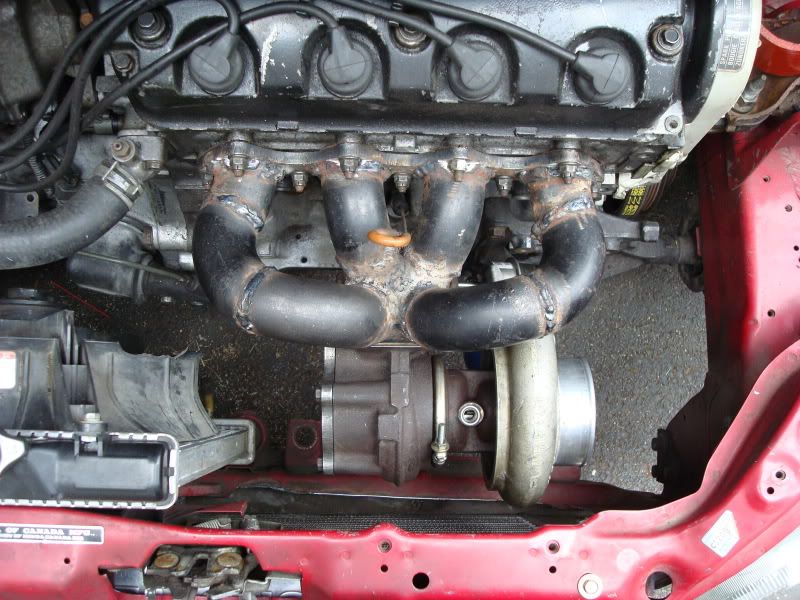

Turbo doesn't spin at idle!  Can't wait to see what it does at 8k.  My camera broke so I've been taking pictures with this other camera that I don't have a cable for.  Turbo is on the car and getting oil, an 'exhaust' is on the car, charge piping and bov are on the car, only thing I have left is injectors/resistor box/tune.  The wideband sensor is there, just haven't got the controller hooked up yet.  Better update soon.

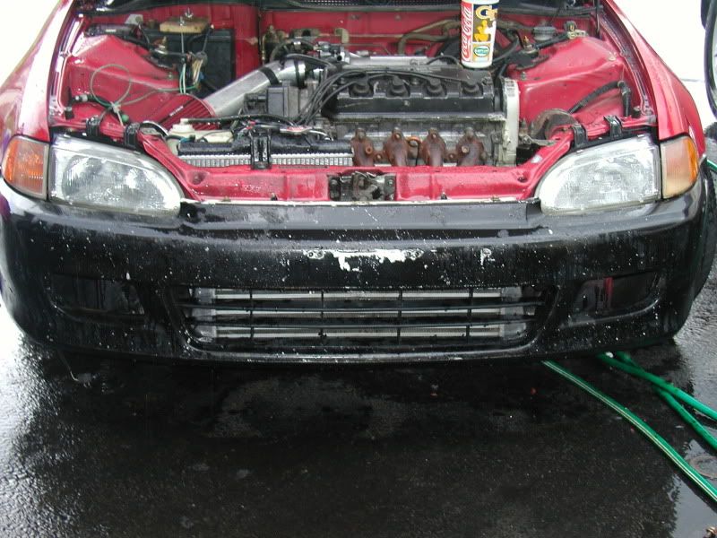

Turbo on and waiting for DP
Shot of the IC with the bumper off

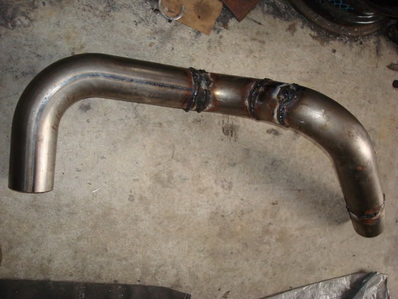

Part of the cold side IC piping
BOV as close as I could get it to the TB

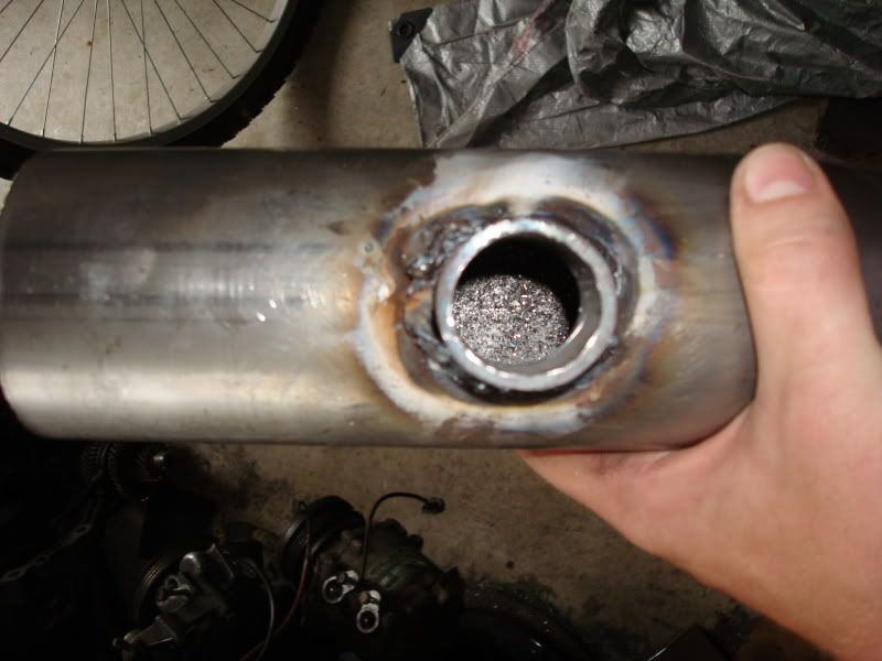

WIER flange, just needed tapped
The 200 amp drill bit
Post die grinder action
That is all for now, gotta get pictures of the oil line and return as well as the exhaust and hot side IC piping

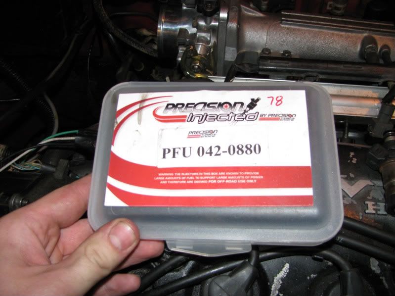

Got a question about these Precision 880 injectors.  Any help is most appreciated
They aren't as long as the stockers, are they cool to use?  Should I just get rid of those black plastic spacers and use flat washers until the fuel rail sits flush?  Also, I'm guessing I don't need that brown o-ring, right?

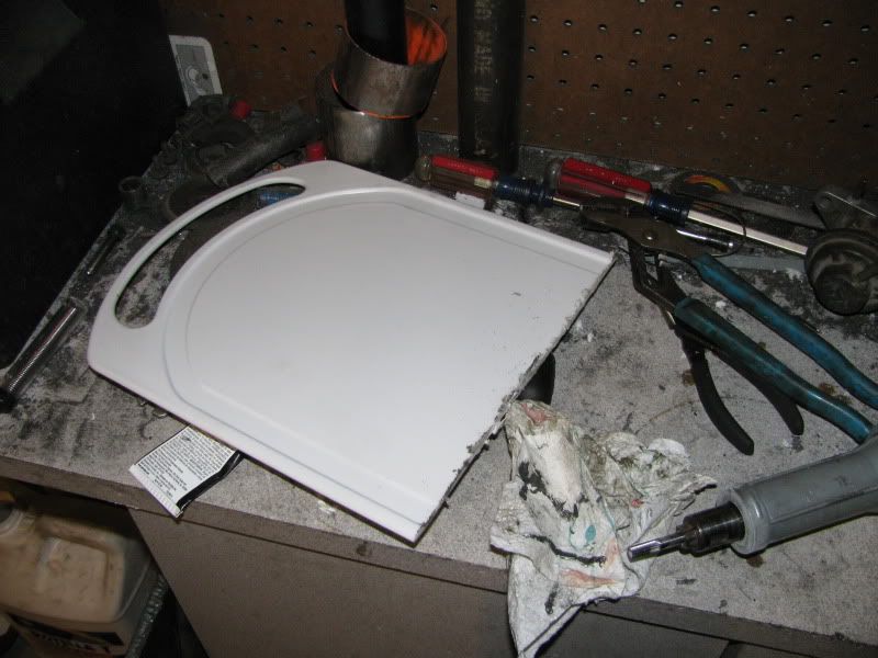

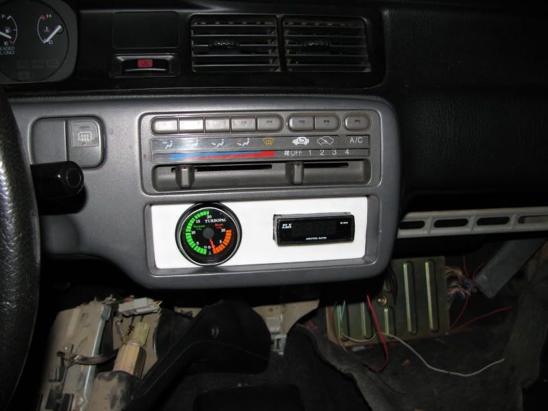

Cutting boards make great gauge bezels.  I'm out of flat black rattle can magic so it's white until I go to the store again.  Gotta love inches of Hg egay boost gauges

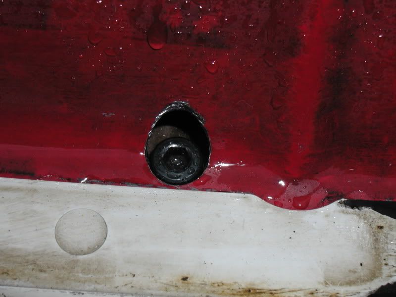

Other useful thing I did today, dodge garage BOV mod.  On a scale of 1-10, it was an 3 for difficulty.  I'll let you know how it works soon enough

injectors look same rail to mani length to me ???
Should be close because of that black slever or whatever it is on top of the stockers that crush when you tighten them down.  The 880 don't stick so far into the manifold.  Do they make it up with spray pattern?
Re: 350 or Bust - Love me some D: almost finished!
« Reply #116 on: October 01, 2009, 12:58:03 PM »
I have the Delphi 75# which are the same as precision w/o the sticker and they bolted in fine. :yes:

dodge garage mod = compressor surge.  at least, it did for atticus.
« Reply #118 on: October 01, 2009, 11:52:27 PM »
Well I'm going to give it a shot, and if it doesn't work then I'll just hook a vac line from the turbo to the port I added.
