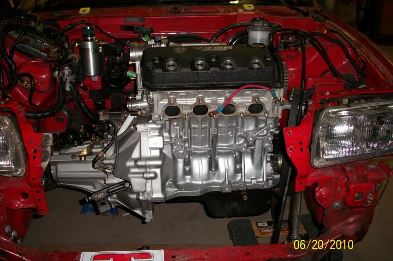

 Engine and trans installed
WTF, did you paint that block??
Hasn't this been covered already?
What about the inadequate ground for the fuel pump?
 :P

HE DIDN'T WIRE THE FUEL PUMP!?

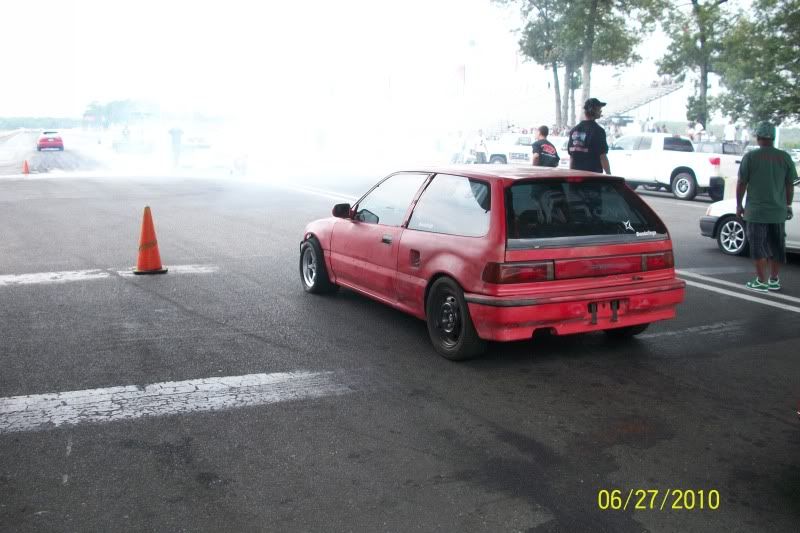

I ran an 11.9 granny shifting at Raceway Park on Sunday. Car runs well and I hope to get some more seat time during the season at test and tune days.
BTW outside temps were over 90 degrees.
What kind of trap speeds were you pulling?

« Reply #188 on: July 03, 2010, 03:48:45 PM »
Stop granny shifting ;)
