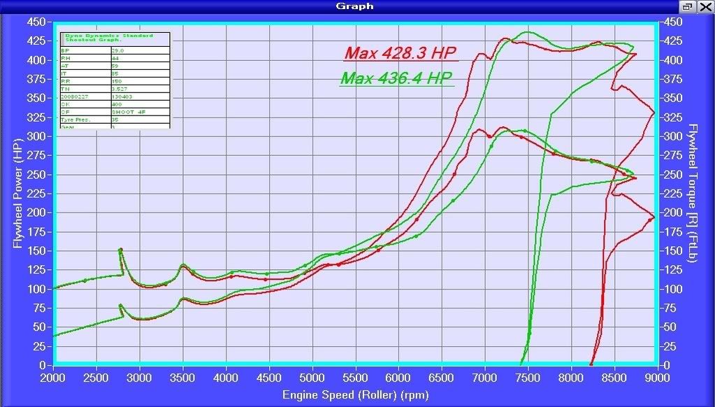

slowly made pulls.. and it was getting around what Chris considers iffy for pump gas..
so at 13.8psi (14psi).. the car made 436whp
*the red graph is the same psi but with a failing spring in the gate (crazy ass dipp at around 7100RPM)
* the green graph is the same 13.8psi , but with the problem corrected
this is the lower hp pull

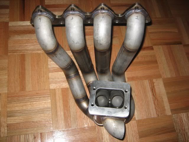

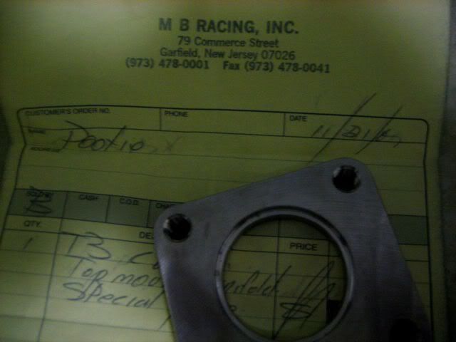

i called up Roland @ MB Racing to get some hardware (-AN fittings, clamps , couplers, etc).. and while talking to him , i told him my plans and power goals.. i also mentioned what a shittt time i was having finding a manifold!!

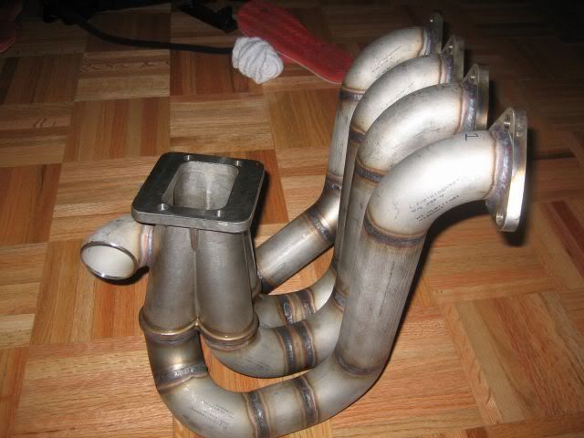

he said he can make me one.. i had seen a few and they looked good!! ( but no real research on them, or gains or losses) so it was sort of a gamble on my part.
i asked how much and how fast ... (he gave me a greattt price, and said it would be made from scratch , custom for my car .. and would take 3-5 days)..

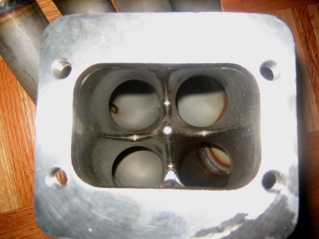

to make a long story short,, 7 days later it was delivered to my job in Manhattan . I had to check it in at security because they didn't know what kinda weapon it was, lmaoooo

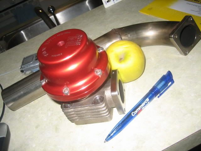

few pix.. T3/T4 topmount manifold, with a free 40mm Tial gate flange!!
don't mind the random flip-flop!!
new 40mm Tial gate and dumptube

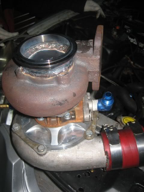

Pootie
  • Posts: 259

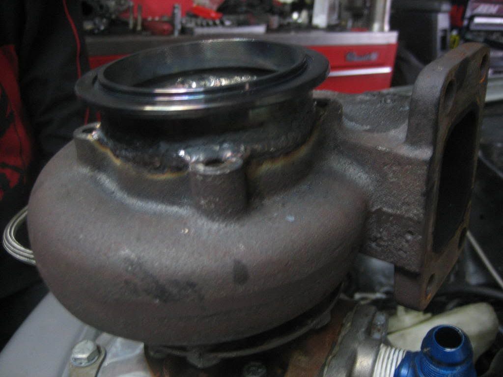

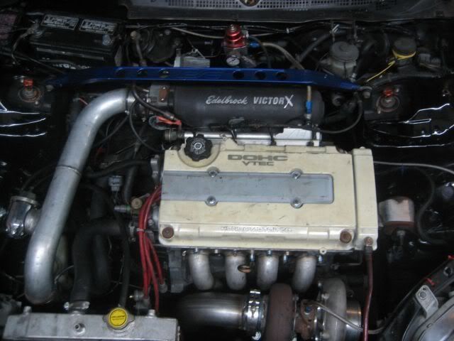

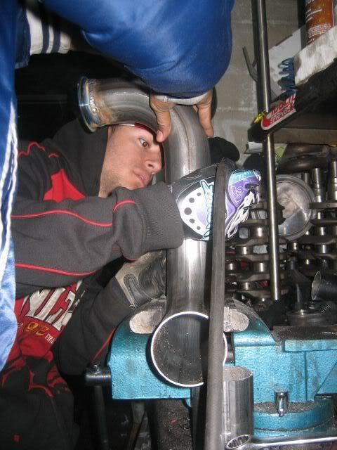

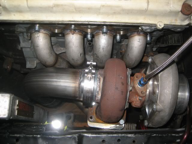

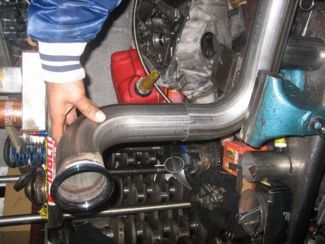

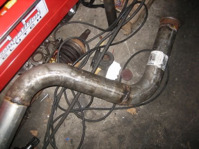

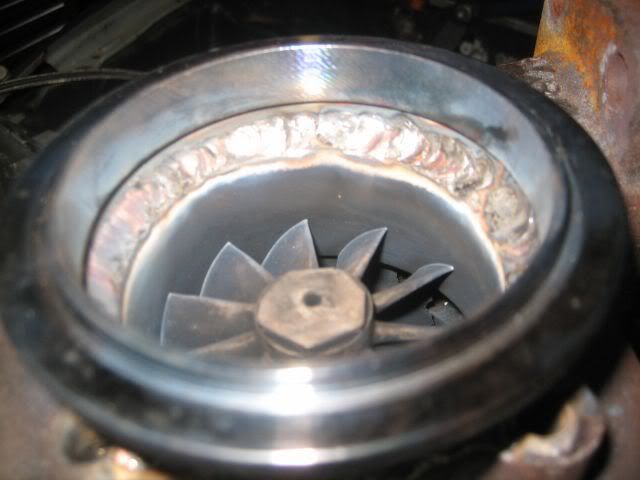

ok so first order of business was to convert my current turbo (T67) to Vband from 4 bolt... Because it's just EZer on life!! lol
 i LOVEEEEE V-BANDDDDD!!!!!!!!!!!!
BIG THANKS TO MY FRIEND TOM FOR WELDING!!
 AND MATCHING DOWNPIPE!!
then
New stuff almost buttoned up!! ( little dirty) :-\
 and a quickt 3" exhaust!! ( so the cops don't mess with me tooo much) V-band in 3 sections!

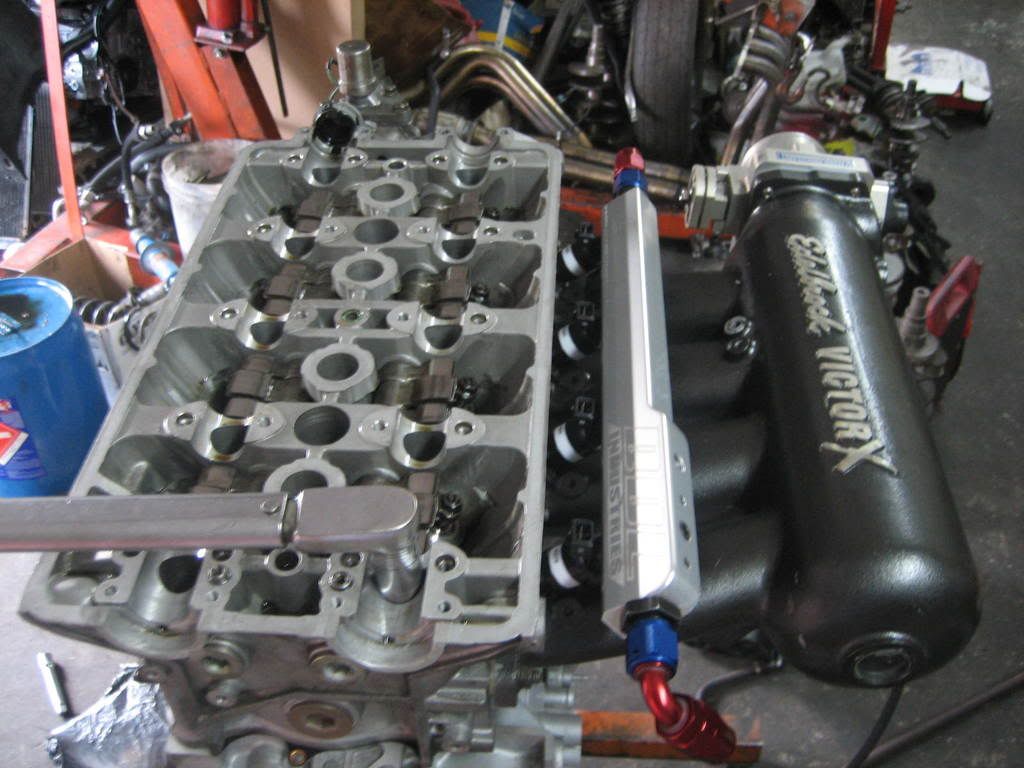

Pootie
  • Posts: 259
TIME TO GO SHOPPING!!!
time to go shopping!!
i still had to come out of pocket a few hundred bucks, but hey lol
the parts list went like this!!

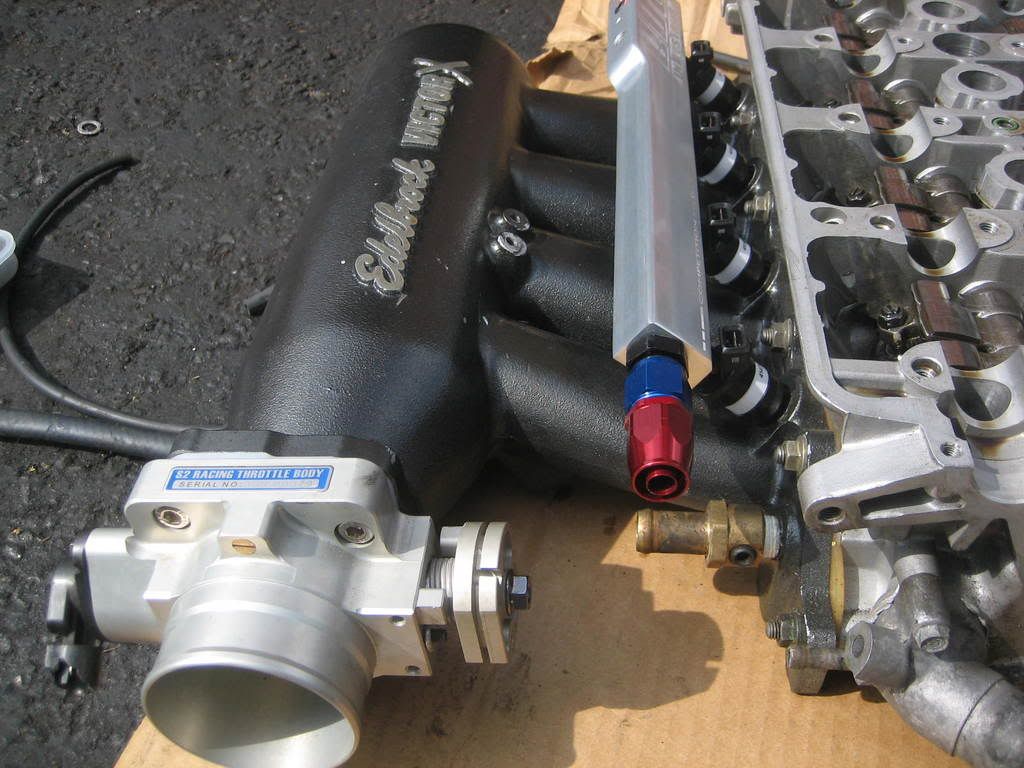

New "used" head (came off a back-up block i had that spun a bearing lastyear)
P&P
Skunk2 Tuner stage 1 cams
Skunk2 valvetrain
Powder coated Victor X manifold
Skunk2 70mm TB

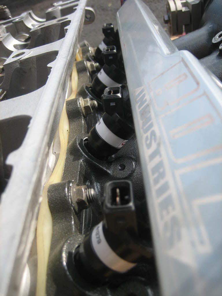

Precision 1200cc injectors
BDL fuel rail
New Block
84.5mm GSR
9.8:1 CP Pistons
Manley turbo tuff rods
ACL bearings
stock GSR crank
Golgen Eagle headstugs
Cometic headgasket
Copper O-ringed

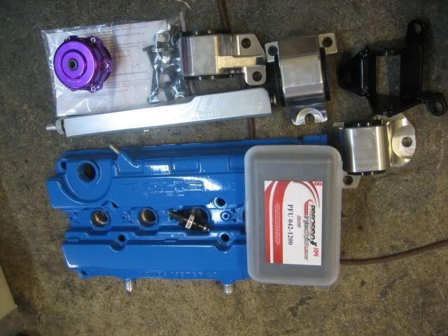

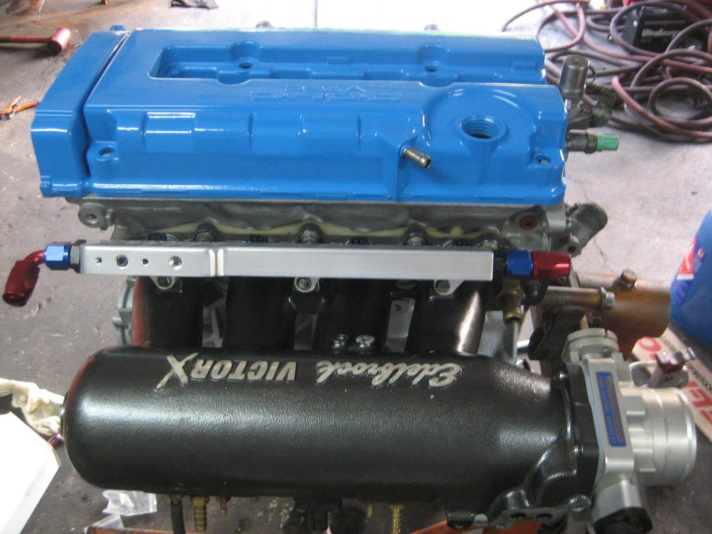

then

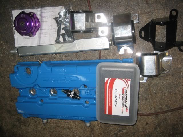

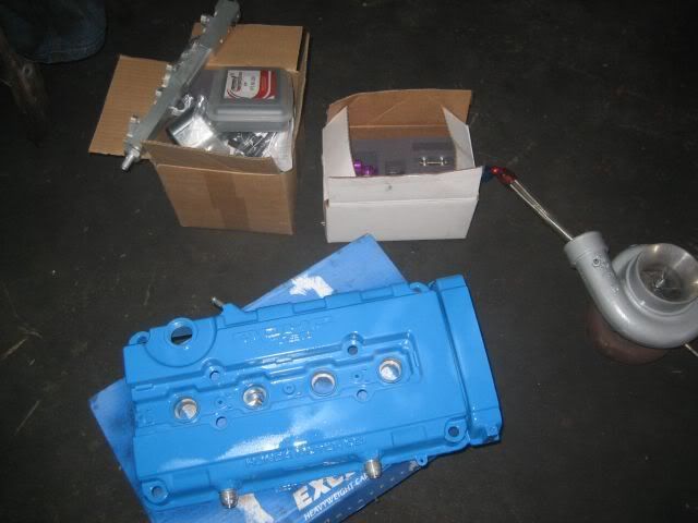

i hateee waiting for parts!!
so props for MB Racing for having 95% of my needs INSTOCK!!
GE headstuds
Tial "uber gay" Purple 50mm BOV . but i like it , lol
Avid race mounts EK-Bseriese
BDL fuel rail

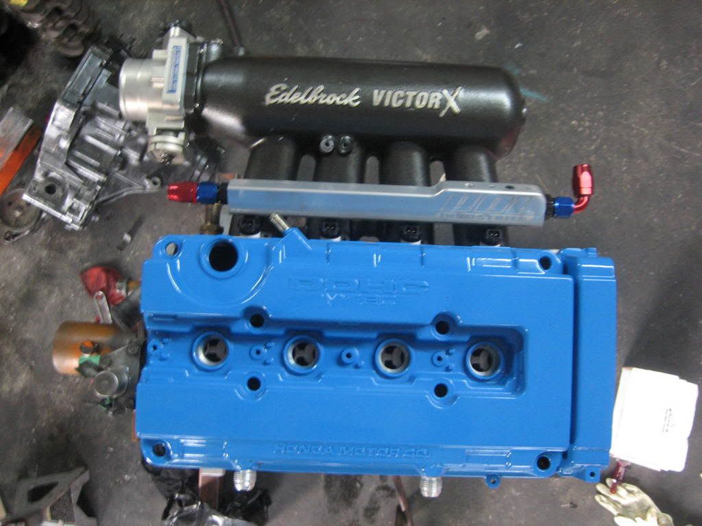

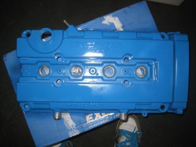

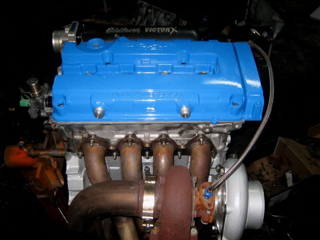

The Valve Cover was vent-welded by my friend Tom , and painted by me!!
 few more shots of the Valve Cover!
Other Random Parts!!
can't forget this lil puppy!

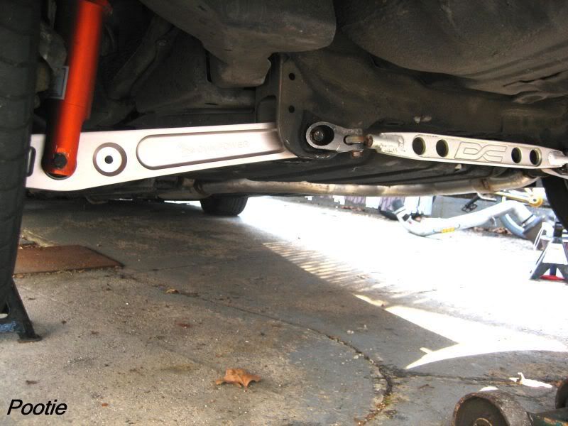

Omni Power rear lower controlearms

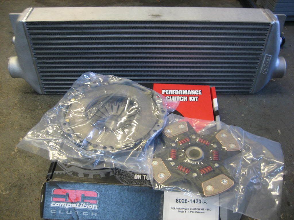

Clutch (Competition Clutch stage 6 lol).. it's the Dual diafram pressure plate with 4 puc sprung!!
PP is good for 400+ foot pound of Tq

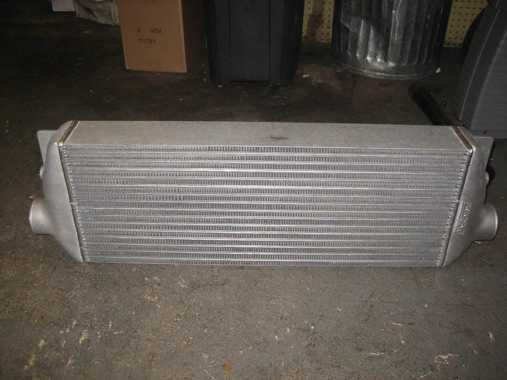

 oh and my new Precision 825hp cooler .. anyone needs a cold beer, because i got a Fridge!
truth be told the old cooler was bigger,, but had a few bent fins,, so it was sold !

Pootie
  • Posts: 259
Mr Head meet Mrs Block!!
Test fit!!
 all looks well!!don't mind the Rust ( backhouseing will be cleaned soon)
Tuned by you know who! ;-)

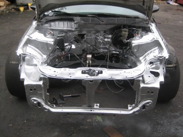

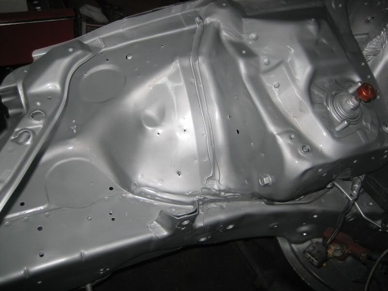

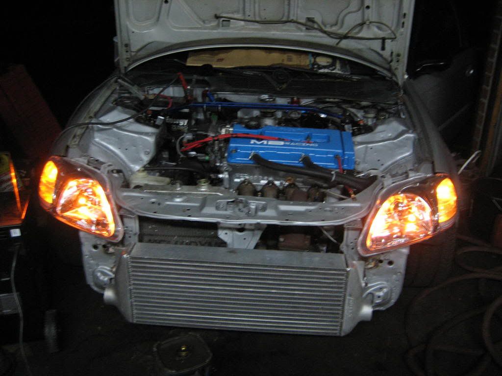

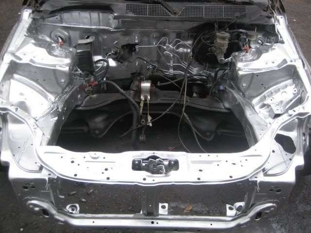

Ok, so u guys remember teh flatblack Engine Bay... well i figured it was time to go back to Silver!!
ABOUT 2 COATS and no Clear!!
 after 5 coats of paint and about 3 coats of clear!!
wireing up the citylights and doing a 1/2 tuck (i know it looks ugly with the engine harness n all, but it should look good once i clean everything up!)

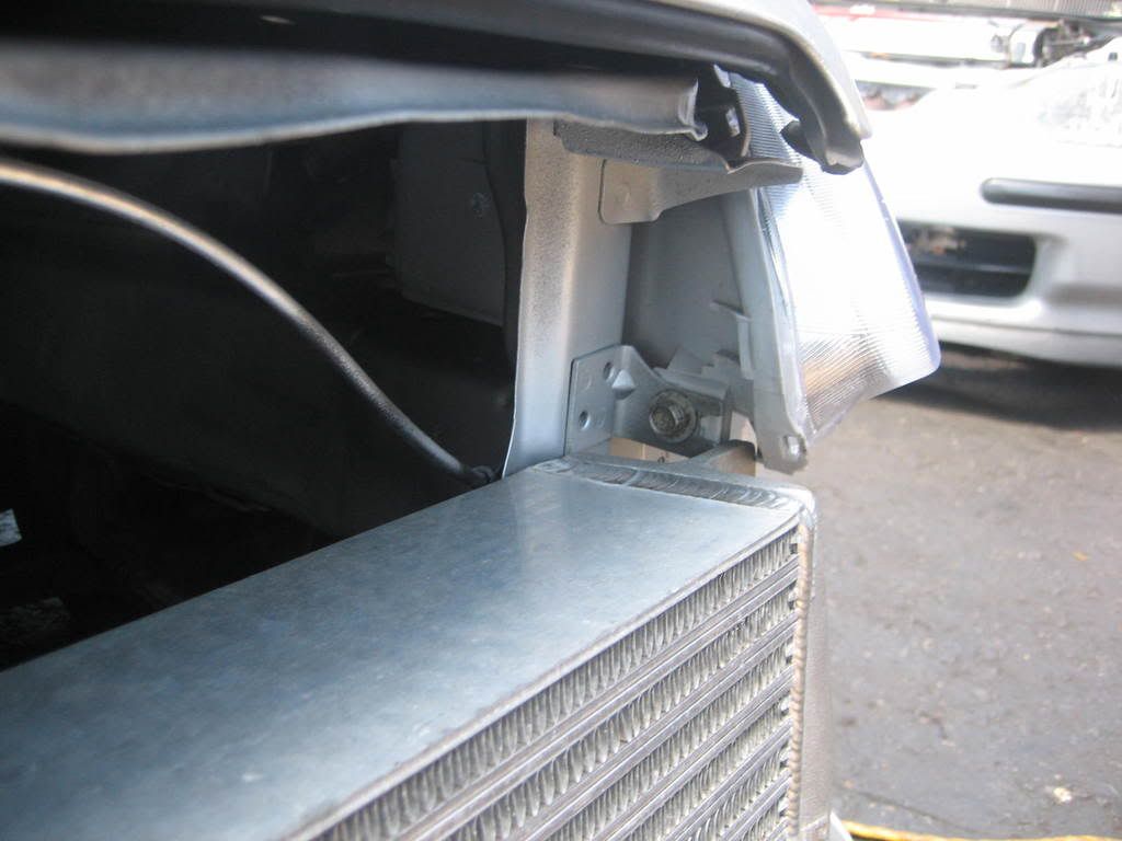

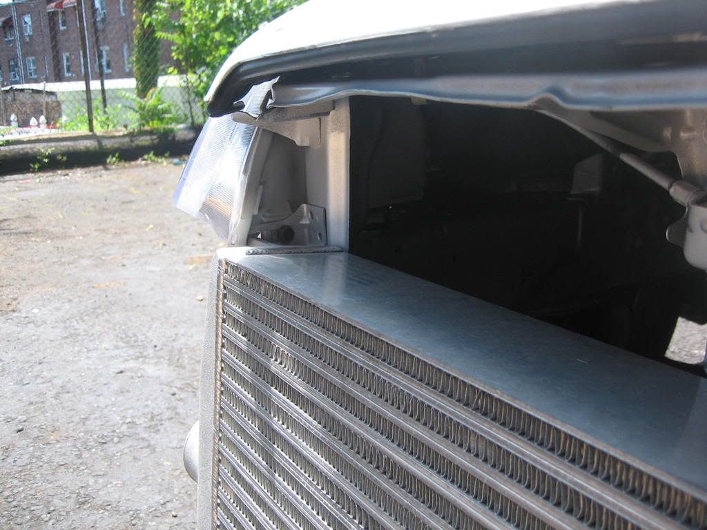

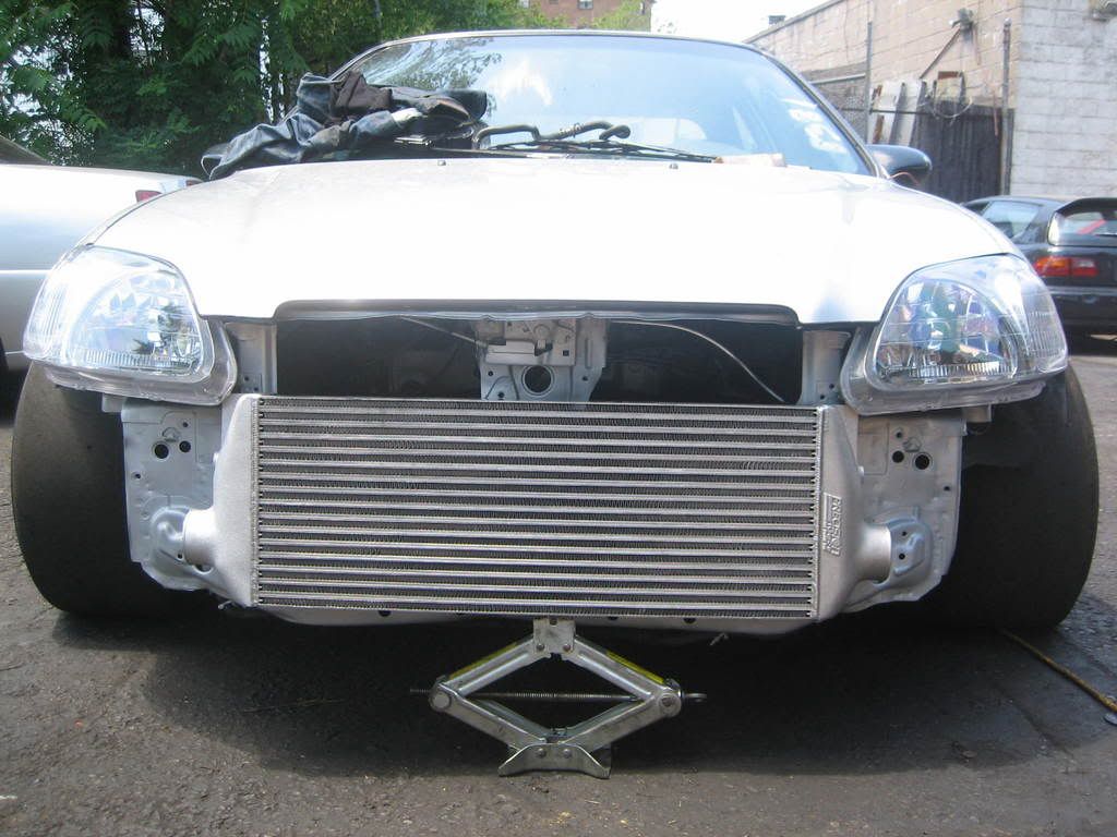

Ok so i went to the hardware store and got these spiffy cooler mounting tabs , lol
i wanted the cooler to sit out a bit from the Radiator support because of the gate placement.. it cleared the cooler,, but it was still 1/2 inch between the two .. and i was worried that under load if the motor moved the gate would reach the cooler.
EZ fix!!
Wind-up jack FTW, lol!!
40 pound cooler = hard to hold up by hand for long!
 it actually tucked very nicely up under both headlights!!

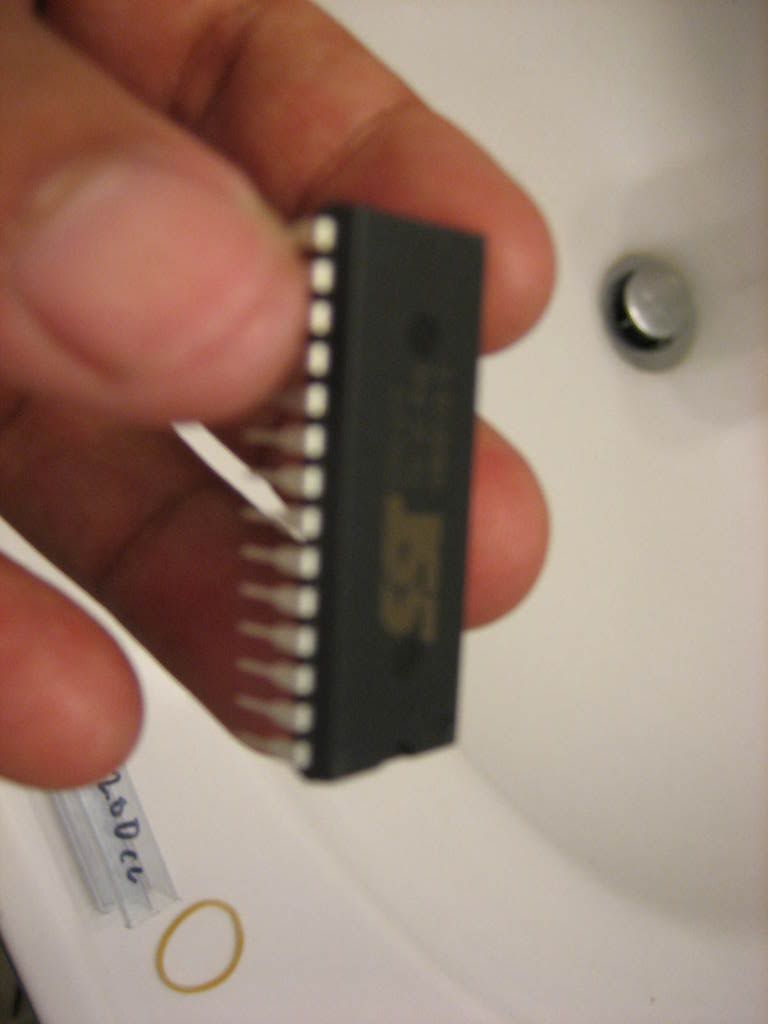

so i was tuned on 1000cc injectors b4.. and i have since went up to 1200cc's!!
i called my tuner Chris @Xenocros with my concerns about not being able to start the car (or starting it tooo rich).. he asked for my adress and , this came in the mail!!
.. eCtune chip with a map for 1200cc's just to get the car started and running good,, then tuneeeeeeeeeeeeeeeeeeeeee!! :D
FTW!!

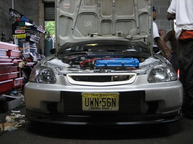

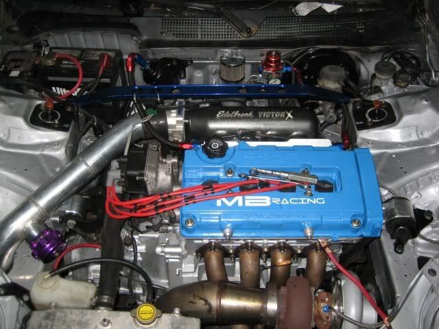

ok so motor is in and 90% buttoned up!!
still need a few fittings for the ValveCover breather
STILL NEED COOLER PIPEING AND CHARGE PIPE,, AND COUPLER AND CLAMPS!!! 3" FTW!!!
FEW STATS.
*car is 2456lbs in race trim ( full interior, no AC, but i love HEATTTT!!) no cage and chute yet (( should be about 100lbs-125lbs more once caged ))
*im 150lbs
*running a 67mm Full-Race T67 (.70/.82) for now .. by spring i'll be running a Borg Warner S366 or a S386
*car is on eCtune chipped P28
*1200cc injectors w/ dual Walbro 255s for now. ( if they can't support the power, i'll run the A1000)
*24.5 x 13 x 9" MT full slicks ( i also have 235-60-15" ET streets .. for the Turbo Street class ,pretty much a 26" tall tire)
* K Sport drag suspension
*all metal body/all stock glass!!
*Boost By Gear FTW!!

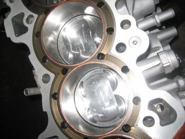

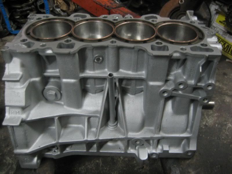

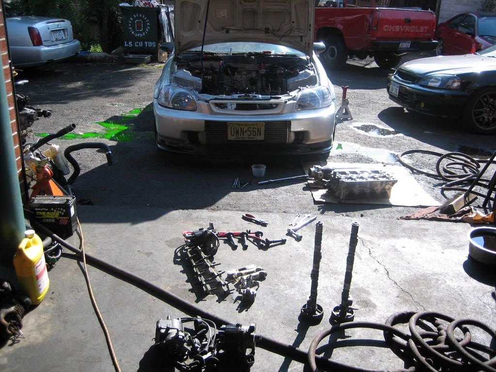

 well here is the situation.. the block was originally a 1.8L (81mm)Acura Integra GSR block... it was Darton sleeved and bored to 84.5mm.
the block was also decked unevenly by the machineshop!!! <~~ this is where it gets depressing.
so now the block is slightly shorter from the shave job... :7
that being said... this is how i was sitting pretty b4 start up!!
NOW HERE IS THE BAD NEWS.. sorry but i was soo sad and could not bring myself to take pix
* i put the basemap in the ECU..
* checked everything, and checked it again!!
* crank, STARTTT

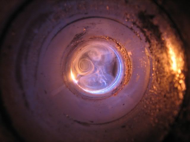

*let it run for a bit.. and was checking out the fuel stuff (checking for leaks because im scared to death of flames, lol)
* NOTICED SOME ANTIFREEZ BY THE BLOCK. WHERE THE HEAD MEETS THE BLOCK BY THE TIMEING BELT. TURN CAR OFF..
*pulled plug #1 and looked down and :eek: then :( green liquid ontop of the piston.
NO BUENO!! went to the store and got a 6-pac of Corona and ordered a Pizza!! drank a bit, ate a bit ( maybe it was a bad dream, maybe i was just light headed from not eating and seeing things, maybe a lot of things)
still the same REALITY "THE MOTOR WAS PUSHING WATER"...called the machine shop and told them about the issue. They said it was because i ran the car hot with no coolant and it warped the head. WTF this was the first start up. They then said to take the head off and bring them the block. ( i took them the wholee motor, so they can open it, So they can't say i messed anything up while taking it off)
at this point i was planning my FOR SALE thread in my head!!
i just QUIT for the day, went home and drank a lil more, the wife gave me a few comforting words.. and here i am !!
Sat is my next day off, and the motor comes out, and back to the Machine shop..to see whats the REAL issue and whats the damage!!
 right now my options are to try to trouble shoot the block issue.. and salvage it.
or i have another block i can sent it out to be sleeved ( at a different machine shop) and put all the internals from the first block in that one.. because it's 100% a sealing issue!!
well at this point the Machine shop is telling me to bring in just teh block, so i pull the head off. Don't mind the spilt Antifreez, it was all cleaned up.
 take them the block to check out,, they are telling me that everything is good on the block. ( i know the head is good , because it just came off a running motor). Anyway i take the block to a 2nd machineshop to get a 2nd opinion and they confirm that it is decked unevenly. I take this find back to the first Machineshop and they have a lot to say , but very little having to do with resolving this issue.
a slight compensation was worked out, and i took the loss, and started over.
 It was nearing the end of the season anyway, and i just wanted to make it to the few remaining events. And i didn't have the time nor the funds to have another motor sleeved.
 so i had another 81mm stock Sleeve motor built with pistons and rods. This time LsVtec ( becuase finding a GSR is like finding a virgin in Brazil)

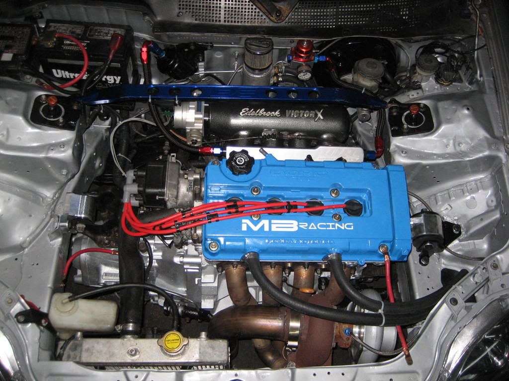

and here we are at the Present!!

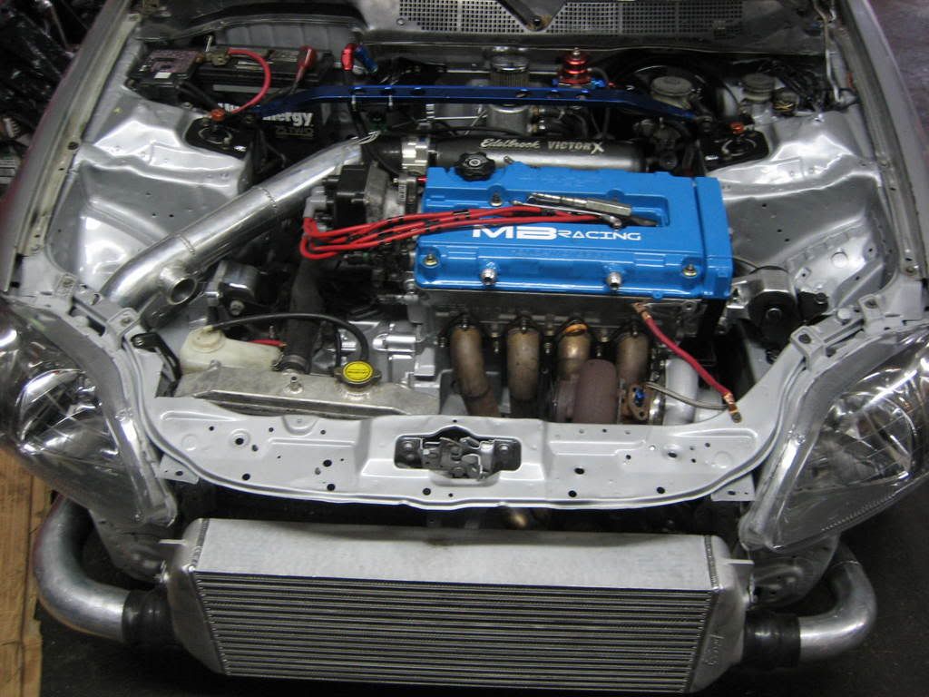

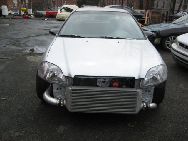

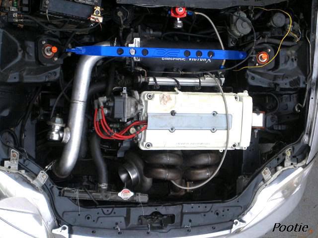

the car was put back together last weekend with a fresh stock sleeve LsVtec with 81mm 9:1 JE pistons and Eagle big bolt rods.

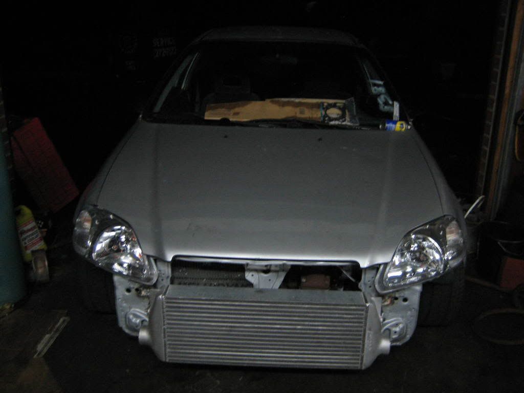

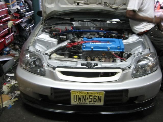

well i got the intercooler pipeing in!!
mocked it up, (still missing quite a few Tbolt clamps and a few couplers..) but it looks like it's going to fit like a glovee!!
3" on the cold side, and 2.5" on the side . ALLLL Alum!
Tial 50mm BOV !!
also test fitted the 3" to 4" downpipe.. tight fit, but with a bit of cut welding it will fit perfect!!
got the front bumper back up. Sorry for the unpainted CTR grille!! that will be taken care of when the car is painted!!
PS: thats not the front bumper/lip thats going on the finished product when it gets painted ;-)

well slight update.
trailer the car up to get tuned. Wired up the injector driver box and removed the resistor box ( and somewhere in the middle i had a wireing issue so could not tune intime to head to the track.). Well i was a lil bumed lately (work stressing me , and the wireing issue). But a friend of mine Rob and my Tuner sorted out the issue, and all seems well.
 So should get tuned soon, i should tune on pump gas . But if i know my friend Rob well enough it will be on C16 lol. :evil:
 so stay tuned.
PIX!
Leaving Brooklyn
Got stuck behind this shit for about 2-3 hours. Fuel Tanker on fire/ had a nice strip of highway ON FIREEE!
THE AFTERMAT
Left Bk at 11am, and got to My Tuner at almost 4pm( and NO thats not who you might think it is in the pic. Thats my friend Rob... i spared you guys the other pix)

 but car is running good now, Thanks to my friend Rob ( coz i know i couldn't get to the car to troubleshoot it till the weekend). Just ready to tune. ;D
 the injector driver box seems to be doing it's job with the 1200cc injectors.
