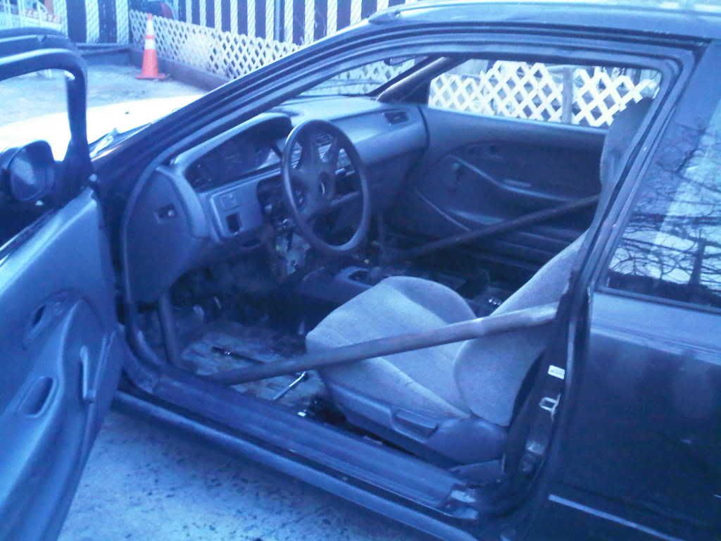

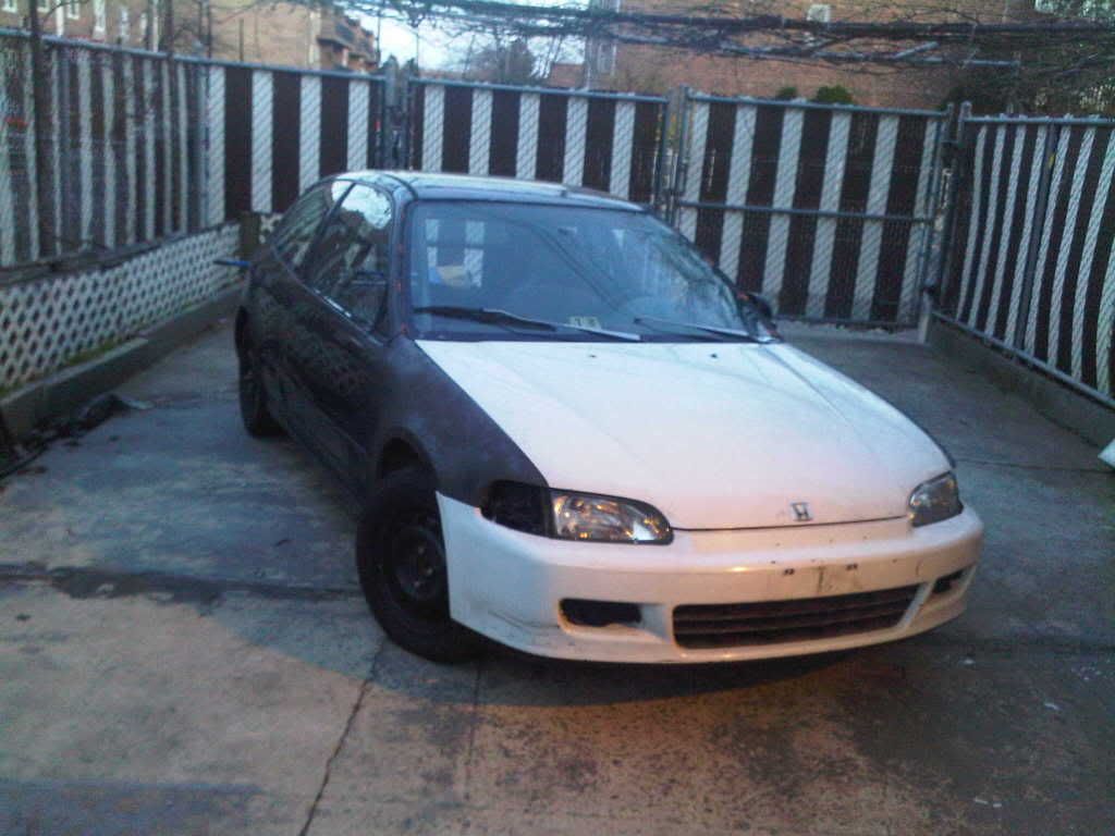

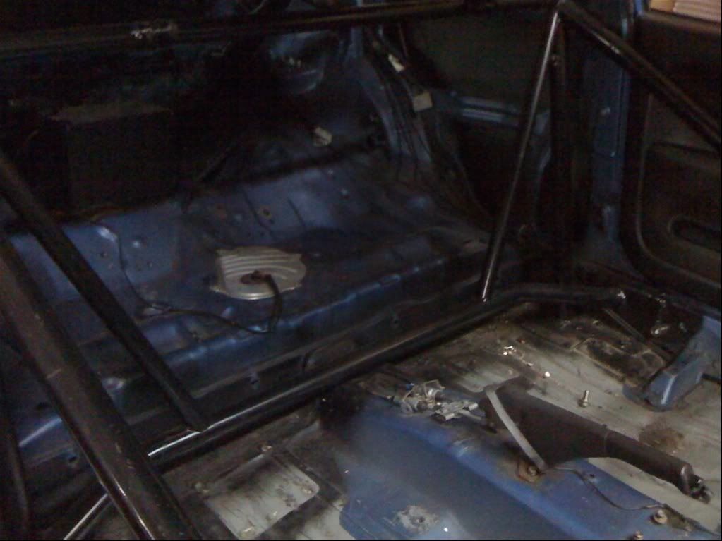

lol , yea wayyy better. cage fits really good. tucked really close to the body of the car.
 The loop behind the seats are angled slightly back to match the angle of the pannel , so you can't see the cage when you are looking at the car from the side (aside from the 2 bars that go back to the trunk).
All and all the car and cage installed cost me less than $1700 (but i got a hook up). Big thanks to Certified Racing in Garfield NJ!

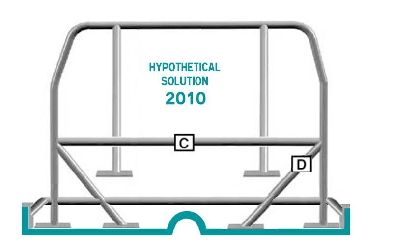

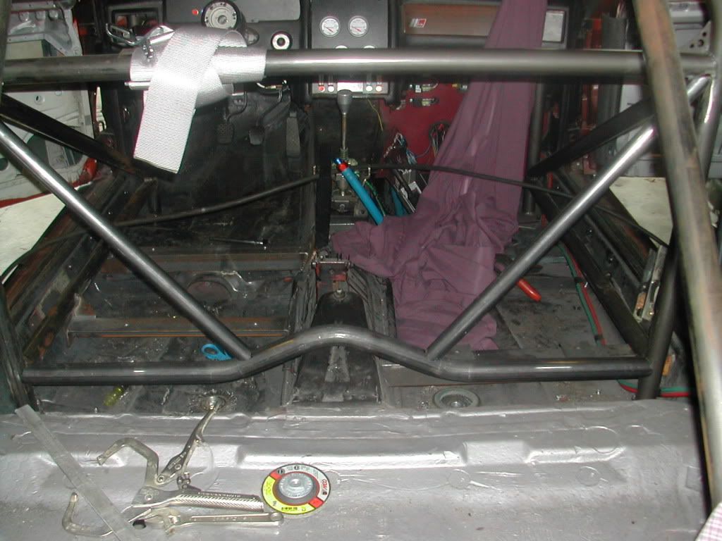

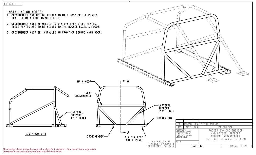

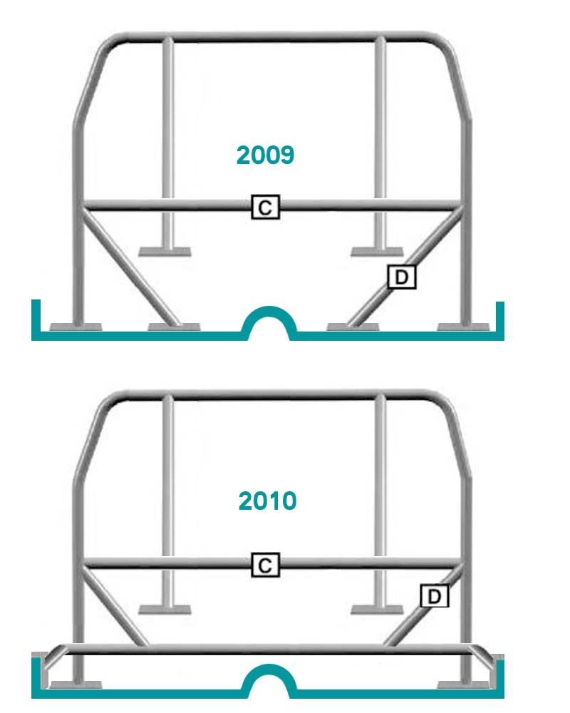

can you take some pics of how the main hoop braces are welded to the floor?
i was reading the 2010 handbook the other day and it stated on FWD Unibody cars the two support bars needed to be welded to a 1 5/8ths bar that goes from one rocker sill to the other.
 yea , i will have to add a bar. As seen here in this pic
butt instead of cutting the existing bar. This is the option for most people with cages pre 2010,

I'd triangulate the rear bars, as well.

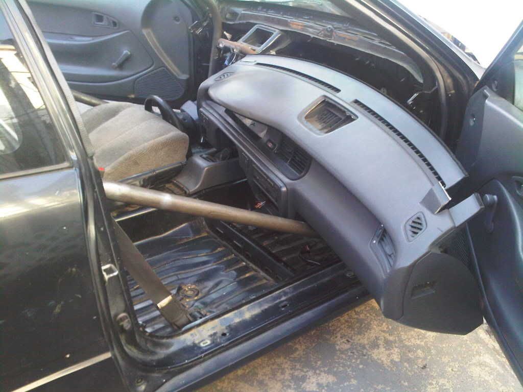

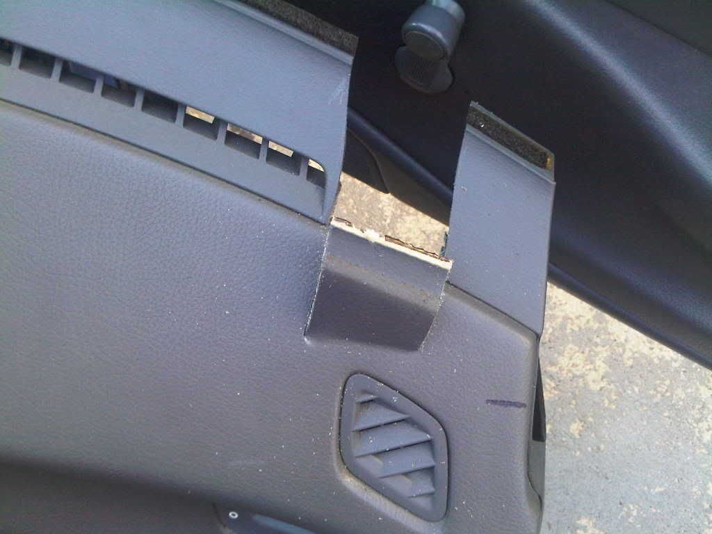

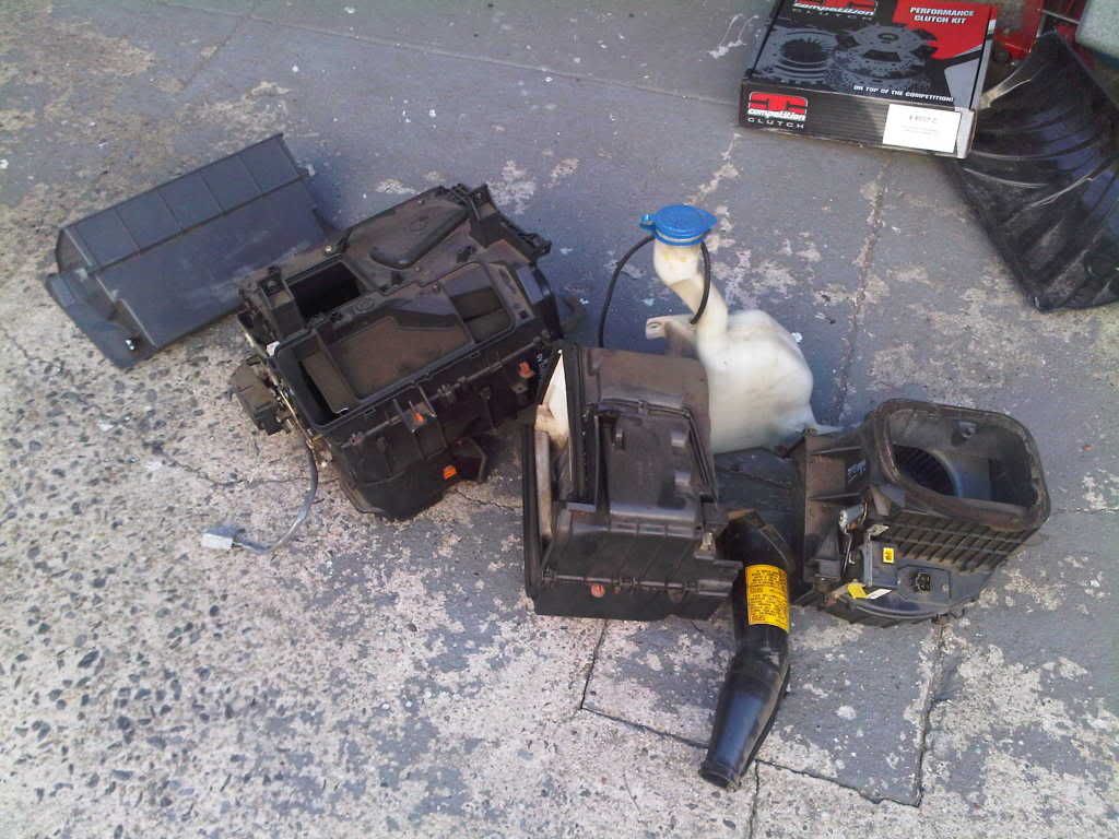

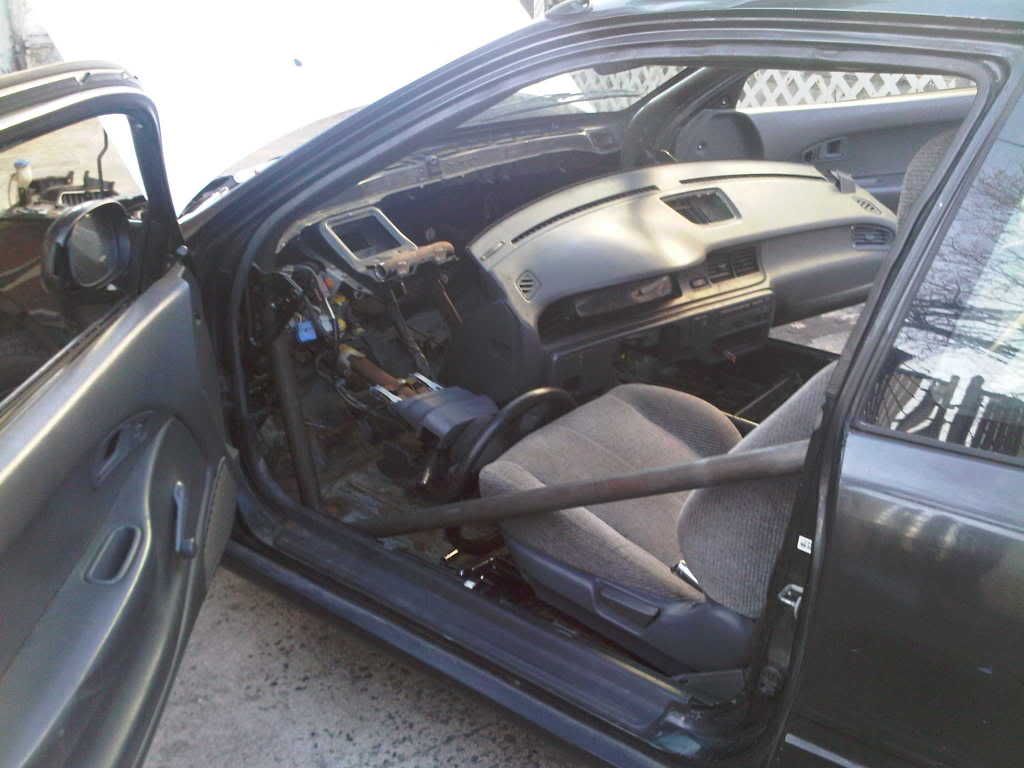

got the dash notched and installed today.. No heatttttt :-[
All done...

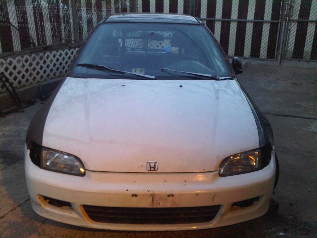

Tomorrow is to clean up the inside, and paint it black. Also paint the hood and front bumper Grey to sorta match the rest of the car.
Tuned by you know who! ;-)

Being from new england I would say your gonna want keep that heat....
ehh, i wanted to. But once i started cutting the dash. I had to cut the ducts. So i just said fuck it.!!
This won't be a "street car". More than likely will not be driven on the street for a long enough period to need heat.
Lot of layers FTW!!

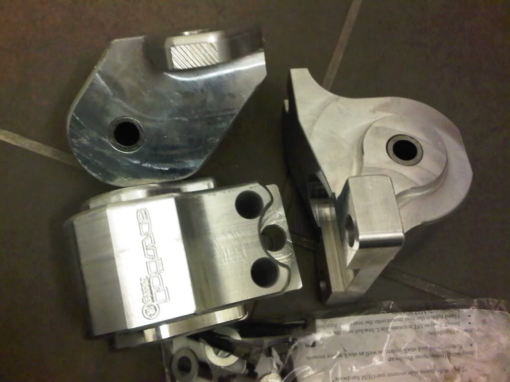

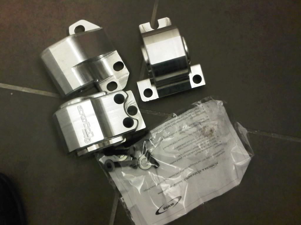

But a slight update. Got my mounts in.. "The Vibrator"
Damn talk about solid mounts :noel:

can you say mobile vibrator...them mounts is almost as stiff as my dick

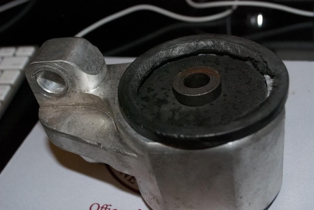

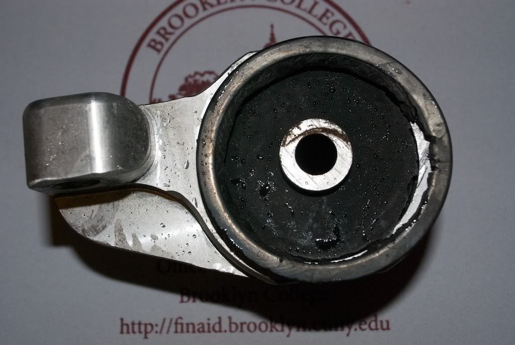

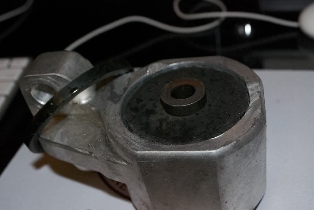

 lol, yea i was trying to avoid them. But i was getting things like this every 3-4 months (or every 10 or so passes on slicks)
I felt like i had to switch to Soilid to keep the motor still, and lessen the chance of broken axels ( since i'm still on my old DSS 3.9s).

The best and cheapest way to do it is having a good friend with a machine shop and skills and have them make you a steel mount using your old mounts as a blueprint.
Yep thats how we done it....Jimmy hooked me up with my inserts, but not a baller at the lead weight you had on your D... That fucker weighed like 40 pounds...
d-rail
  • Posts: 1005
The way I said does weigh a bit more than those solid aluminum mounts but your aluminum mounts will start giving and warping. Its just the nature of aluminum.
Actually... no. They won't.
d-rail
  • Posts: 1005
Not to argue spike but Rob at TPR showed me some of his aluminum mounts that his hatch turned into chewing gum. Pretty rough shit
When is the motor going in?
I seen them too, but I dont think they were the highest of quality in aluminum. looked like coke can shit... But my inserts are 4030 steel or tool steel...hmm  carnt remember but they work just fine after we cut,rewelded, to position motor for better axle alignment for the twisties. No more binding on drivers side anymore or popped axle boots
