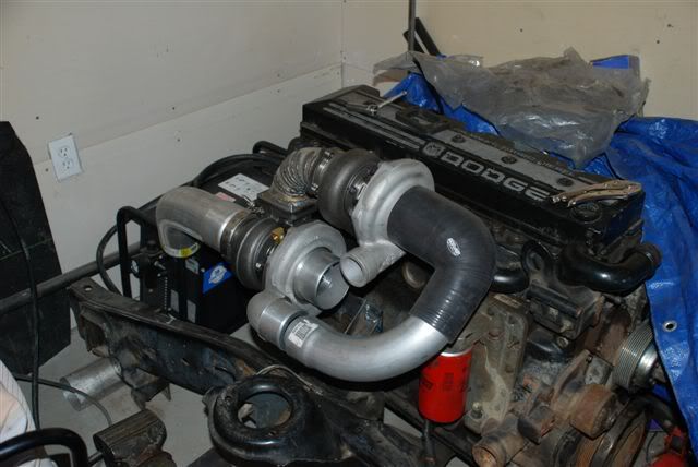

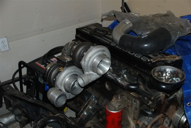

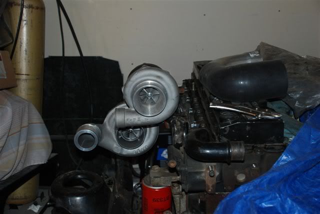

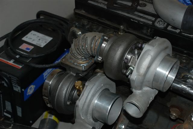

Here is a set of twins and manifold I built over this last weekend. It is a GT35R over an S366. Still have to finish the cold pipe, and pipe to intercooler. No shots during fab, and no good shots of the manifold, but it looks just like the last one I did.
I know you will all love that I cheeped out and just did pie cuts on the hot pipe.  O0
I will try to take some more pics next weekend, or whenever we actually get around to installing them.

Just wanted to add, all the flanges used were from Weir.  O0

Yeah it started life as a big CLR, and I needed a tight CLR. Lazy pie cuts ensued.

The hott pipe is the only part needed to do something like this?????
That would be badass to have a compound turbo set up on a honda....
Dumb?  But small turbo on top of big turbo????  Right!
Re: Towing twins
« Reply #19 on: December 02, 2009, 10:36:11 PM »
The cold pipe is sort of pictured, we were just missing the coupling boot. So you need a hot pipe and a cold pipe, for compounds.
Not sure what the point on a honda would be, other then the I don't think it has been done factor. High PR and low flow is exactly the opposite of what a honda needs.
That setup is probably good for ~75lbs/min at 50-55psi. Where as the bottom charger all by its self is good for 82-85lbs/min at ~35-40psi

The last picture is the most complete shows the: Hot pipe, cold pipe and down pipe. The secondary turbo's (small turbo) outlet goes to the intercooler, the air filter goes on the primary (big turbo)
