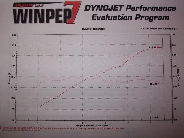

« Reply #14 on: December 06, 2009, 09:39:08 PM »
TurboHf made 230hp if I remember right.
219.31whp 147.62ft tq
THE SETUP:
Block:
B20B block (stock sleeves 84mm)
RS Machines "JDM ITR" Pistons (84mm)
Eagle Specialties Products Forged H-Beam rods
PR4/89mm Crankshaft
ACL bearings
P8R Honda Headgasket
Endyn Oil Plumbing kit (sandwich plate w/STEEL adapter)
Golden Eagle dowel pins
P72 headbolts
ITR oil pump
PCT crank pulley
Royal Purple Synthetic 5w30 oil
Filtech/Honda oil filter
custom breather box setup (OEM Honda nipples off the back of the block)
baffled PR4 oil pan
Head:
P72 head
stock portwork + cleanup
Skunk2 PRO2+ Camshafts
Skunk2 PRO Valvesprings
Skunk2 Ti retainers
Skunk2 Cam gears (I+3 E+2)
ITR Intake valves
ITR Lost Motion Assemblies
Engine misc:
AEBS intake manifold portmatched by PBTuning
PBTuning 70mm Throttle Body
P73 throttle cable and bracket
Fuel:
B16A2 billet fuel rail
390cc injectors
OEM Honda resistor box
Walbro 255lph High Pressure intank fuel pump (re-wired DSM style)
Exhaust:
Big Tube Tri-Y header ("Hytech")
Omni-Power 2.5" Test Pipe
Apex-i World Sport 2 exhaust
little copy/paste action... should be enough info? but that is my setup i was running... was ok for NA i guess...
looking back: spent too much money. not enough power. cams without stock (CTR) primary lobes idle like shit. stock rods would have been fine. restrictive exhaust kills power. non-restrictive exhaust on built NA sounds like a powerful ricer honda (no, still not better).
there was more power in it (5-10hp)... but there was even more power in a stock B18C  :-*
