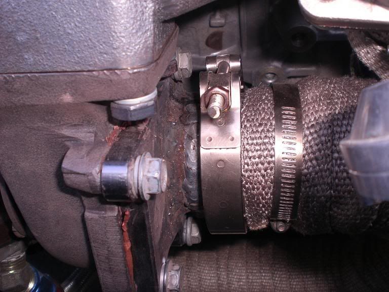

t3 outlet is only 2.5" so a 2.5" vband with a 3"-2.5" reducer would work fine and give you better bolt clearance than simply welding a 3" v-band to the flange
Mine below. After the v-band it jumps up to 3"

Anyways, would a 3" vband kit weld right up tot he t3 flange, or would I need a reducer?
is that the red hi temp silicone instead of a gasket inbetween the turbo outlet and the dp flange?
