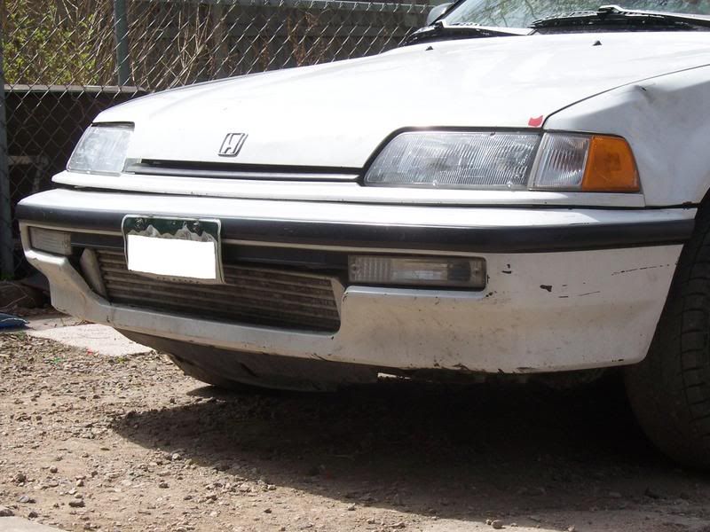

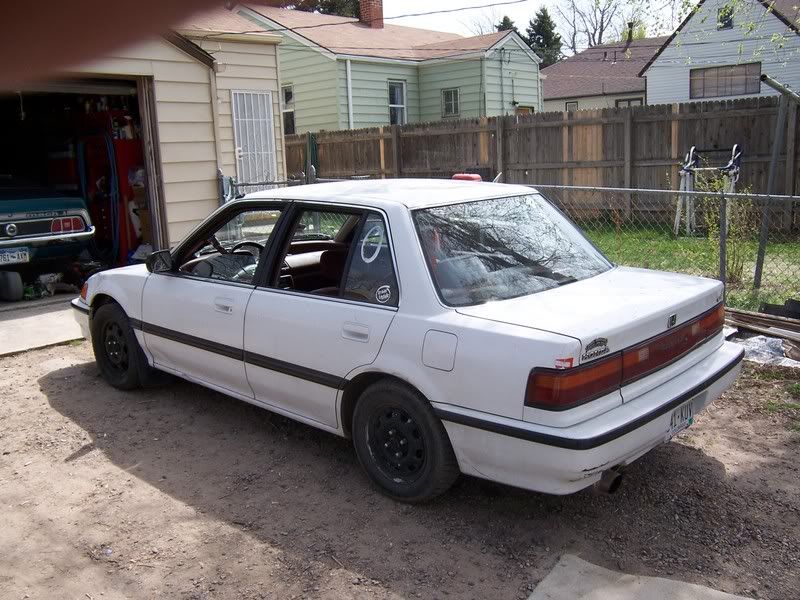

Well it is time to post up my build. I have had this civic for about a year and had a ghetto turbo kit on it last summer and it has served as a good DD. Well the engine finally had enough of the no radiator fan and hot summer days and overheated/cracked the radiator. So i pulled the stock d15 and thats where it sat as of 3 months ago.
Well it is a 91' civic lx 4 door that has been mpfi swaped and obd1 converted using a boomslang harness ( pretty badass). The goal with this build was to have a DD sleeper civic that looks and drives about a close to stock as i can get with 250 whp. I don't like gauges everywhere, slammed cars, and engine bays that have parts that look out of place. Thsi is pretty much a test bed for my own idea's towards turbo honda's. I like oem looking turbo kits and installs so i try and make my turbo kits make sense so there will be no 3" charge piping and T67 turbo's running 3 psi AKA no honda-tech builds for me.
Car:

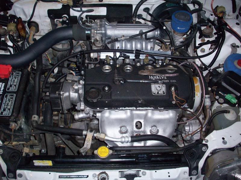

Old turbo kit installed

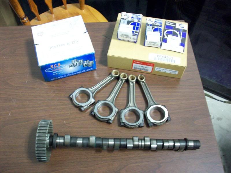

The desision to build the engine that way i am has all to do with me being a cheap ass and loving to build oddball stuff. The compression is not to much of a concern.There can't be any worse low end performance then the stock dpfi d15.  :?: Pictures to come of the enigne.

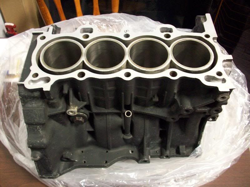

engine D16a6:
- 75.5 ycp vitara pistons
- modded LS rods w/ arp bolts
- polished crank journals
- oem oil pump
- stock head decked and valve job
- Delta 272 cam
- 7.1:1 comp

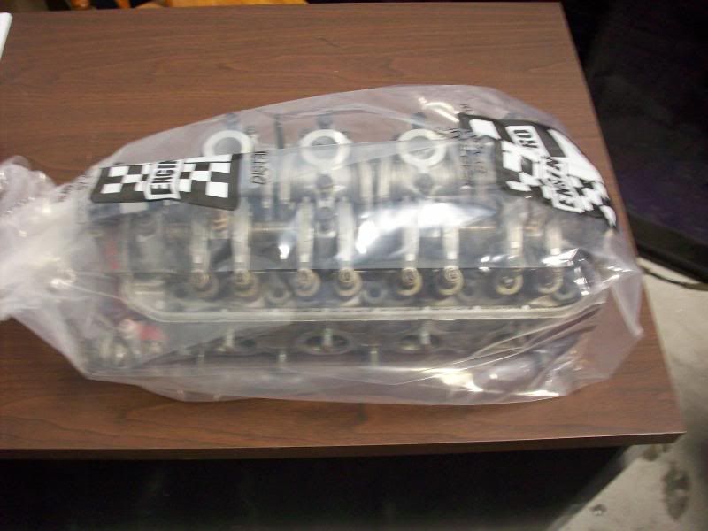

stock D16a6 head, cleaned, valve job.
D16a6 block, cleaned and bored/honed to 75.5 with .004 ptw.  (painted black, yuck)
Internals 9oem oil pump, modded ls rods, bearings, vitaras, Delta 272)

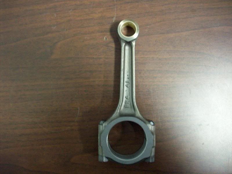

modded ls rod
Ls rod compared to stock d15b7 rod

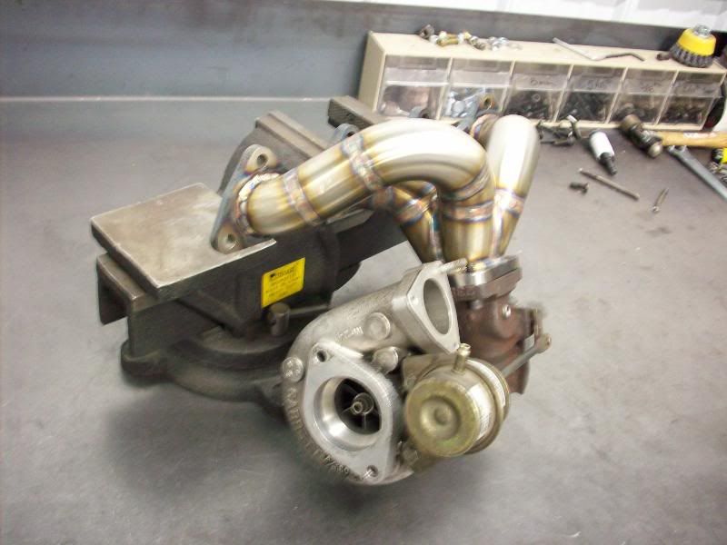

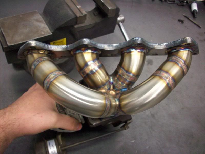

So for this winter turbo kit i will be running the following
- Garrett T25
- 1.25" sch10 "quick spool" manifold
- 2.5" turbo back exhaust
- modified srt 4 intercooler
- 1.75" hot side charge piping
- 2" cold side charge piping
- 1g dsm bov recurculated
- 680cc injectors
- walbro 255 fuel pump
The point of me building this kit is to have a very responsive street car that will have great power at almost any cruising rpm. Turbo responce being the key here i went with a small diamiter short runner manifold with a 2" collector. This should still flow well up top but give me some nice spool up. The T25 turbo i had from my old turbo kit and should work great on 10lbs. I personally don't like loud bov's so i plan on recurculating the dsm bov back into the intake to quit it down some, and also help a small amount with keeping the turbo spooled.

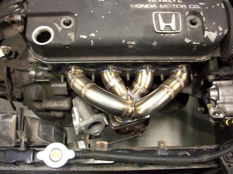

Turbo manifold:
Well thats it for now, i will try to update as i finish up more things on the car.

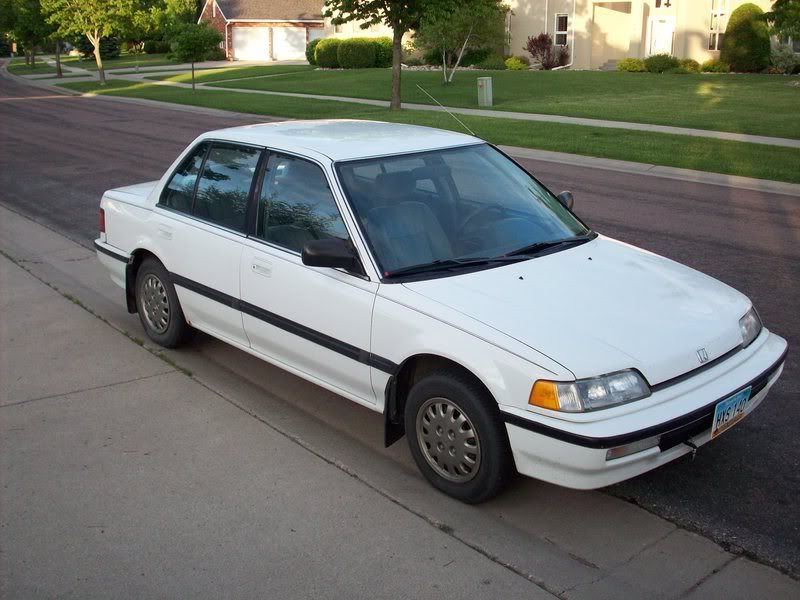

Shit Box FTW  ...... I miss mine but it was a heap of shit compared to urs, idk how u can find a car that clean for its age
Re: Turbo 91' civic 4door build.
« Reply #8 on: December 11, 2009, 01:48:28 PM »
haha the picture fools everyone, it got hit in the rear at liek 30 mph, and the door is slightly open won't shut 100%. also the bumper is crooked. but for $800 and 105k org. i will take it,

Really nice, simple and clean. Who made the manifold, and how much did you pay?
I believe the op turbob16hatch made it himself. check the fab forum. Should make a nice sleeper  :noel:

who did the work on the LS rods you had modded?
« Reply #20 on: December 14, 2009, 05:49:39 PM »
local machine shop, they do good work. the bushings came from crower.
« Reply #21 on: December 14, 2009, 06:02:04 PM »
mind me asking how much they charged?
« Reply #22 on: December 14, 2009, 06:07:34 PM »
It was $140 plus tax. and $40 of that was the bushings.
