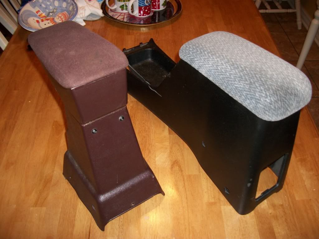

I purchased a CRX armrest, but unfortunately it was the hideous brown color. So since I had a 96-00 Civic armrest laying around (which was going into the CRX till someone fell on it and ripped it) I decided to use the fabric from it.
Tools Needed:
Philips head screwdriver
Flat head screwdriver
Spray Glue (optional)
Scissors
Marker

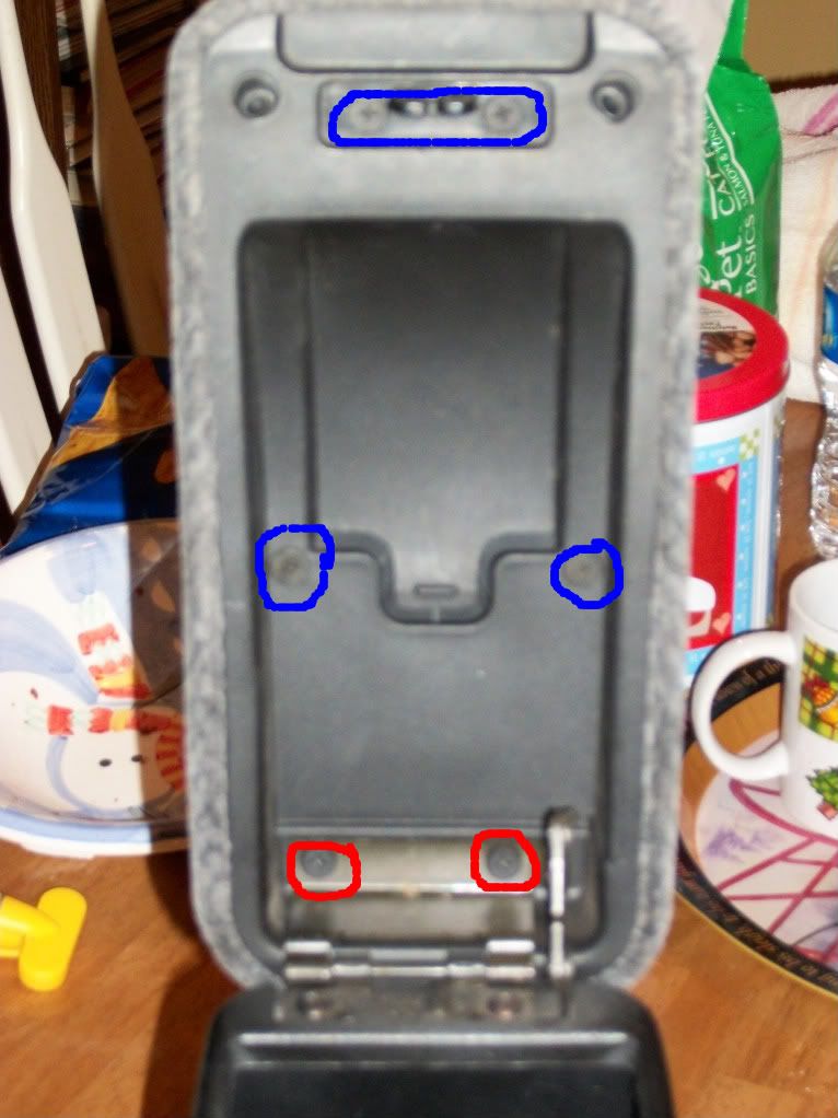

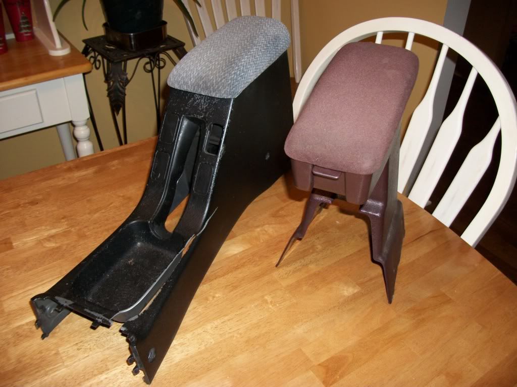

So here are my armrest I have to work with. You can see the split in the EK armrest.

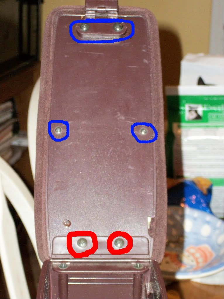

Next you need to remove each armrest from it's base by removing the screws in red. Next remove the screws in blue.

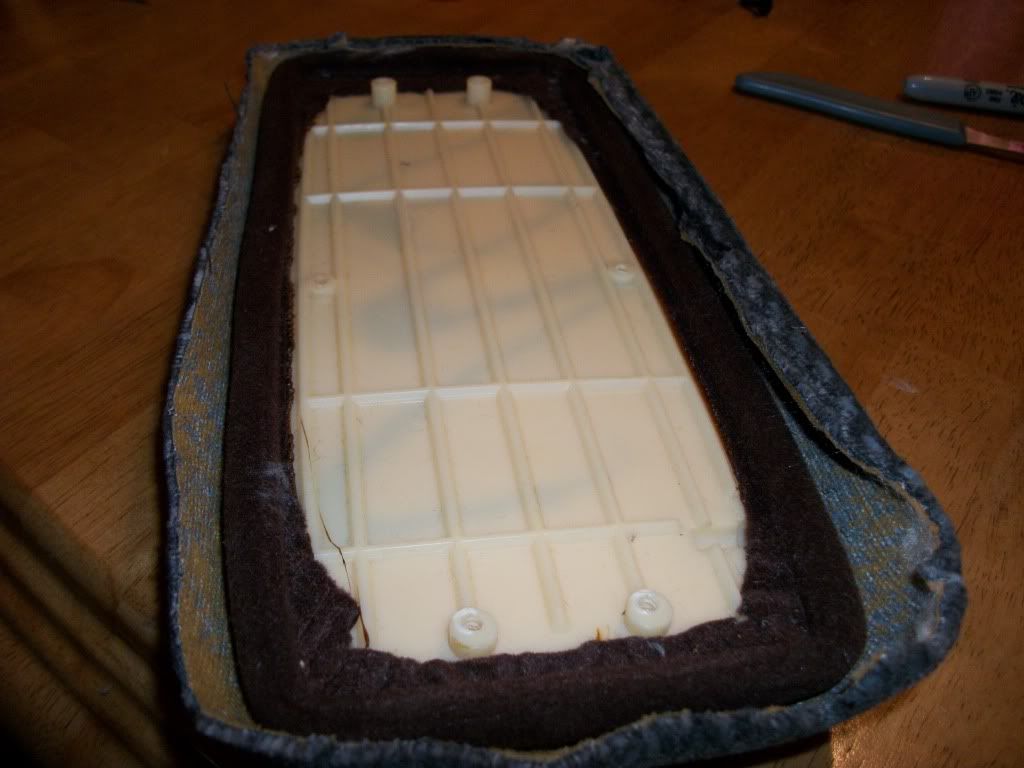

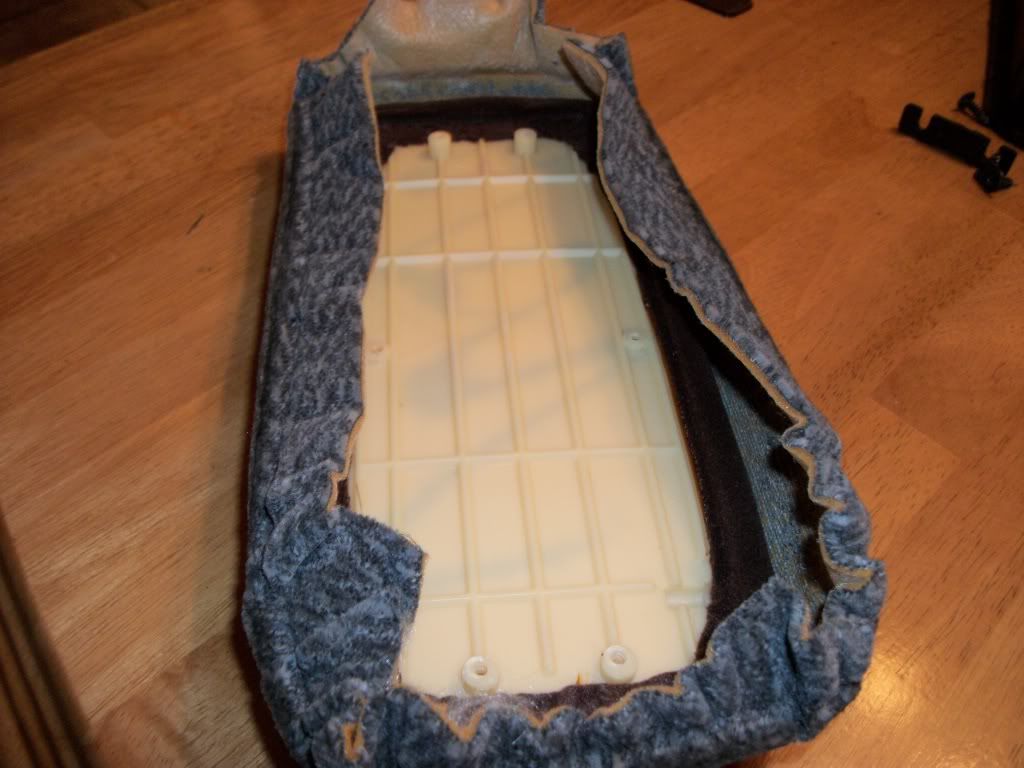

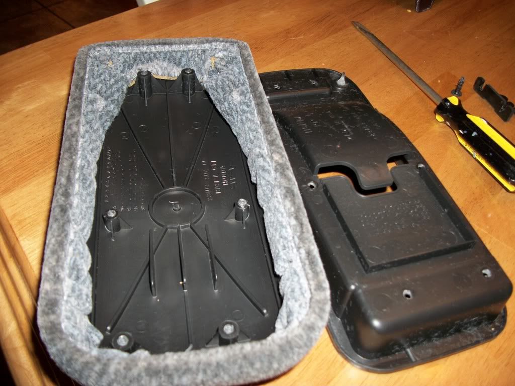

Next we will need to separate the inner armrest from the outer. The one on the CRX armrest lifts right off after you take the screws out. The EK one needs to be "popped" off like below. Don't worry it's not in there too tight.

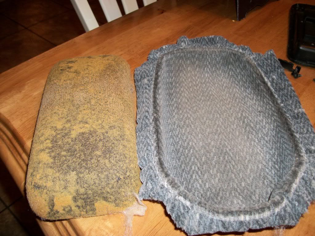

Now simply use your flat head screwdriver (wouldn't recommend knife as it can cut through fabric) to get a small patch loose. Then just peel pack the fabric like you are peeling an orange. The fabric is glued on so some of the fuzzy "padding" type layer will remain on.
As you can see the EK fabric is much bigger than the CRX fabric.

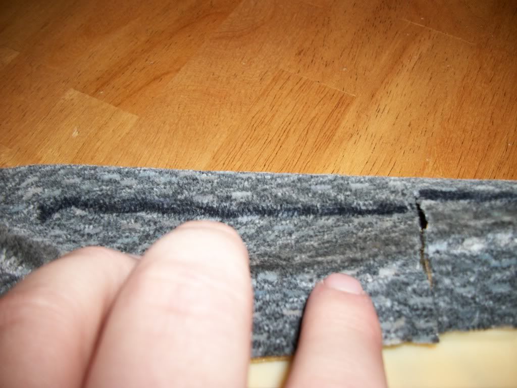

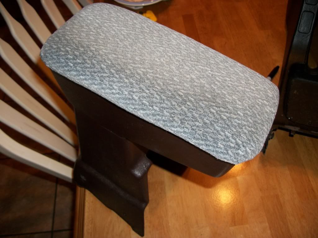

Get the CRX armrest centered in the EK fabric. Then wrap the EK fabric around the CRX armrest pressing it into the same area the OEM CRX fabric is in. Mark this with the marker so you know where to cut.

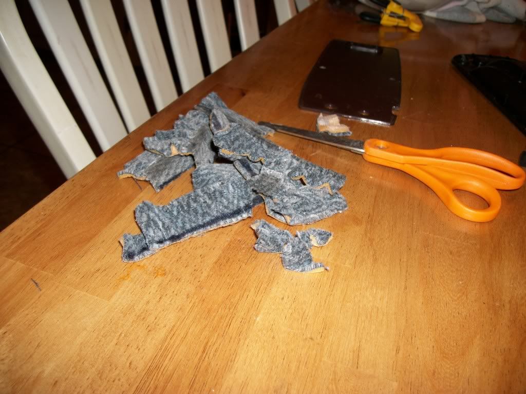

You will have a nice bit of fabric trimmed once you're finished. Be careful and don't too much, you can always take some off later, but can't put it back.
