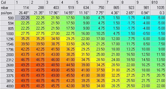

I was out tuning a bit with Minor threat and we did some cruise stuff to help get a bit better fuell mpg. Turns out i wasnt running enough timing and I was making very little vacuum during cruise.  What im wondering is what do most of u fellas aim for at cruise for afr and timing.
For afrs Ive read that you an almost lean it out till it bucks, so i figured cruise at something like 15.1 15.5? but the timing thing has me stumped. Its not likely to detonate at such a light load. So how do you know when to back off?  ON the road is a bit tougher , but im guessing i can go roughly till i dont see it making any additional power ?
Brett can probably explain it to me, but im curious what u naggers think. on my 85 4age turbo
After some tweaking we came up with this.

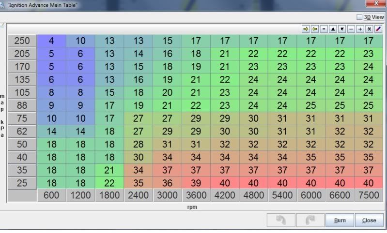

Cruise AFR is primarily determined by combustion chamber and atomisation.  I understand ignition can have a lot to do with it, but when dealing with the ever-familiar Honda I see some engines starting to stumble in the 15s, others 17-18 AFR - one was an LS the guy claimed 46 mpg, I was surprised.  Anyway.  Give the setup what it likes.
As far as timing, the "bigger bore likes more timing" adage seems slightly amplified, compared to WOT, be a degree or three.  Also, CR and presence of EGR make a difference - as does AFR, lean might want more timing.  Frankly I don't hear many/any part throttle cruise timing pings.  I think its the sort of thing you want to steadystate on the dyno and tune for best cruise at torque, but knowing jack shit about your motor I want to say set cruise timing to 38-42 deg and forget it until you buy time on a loading dyno.
