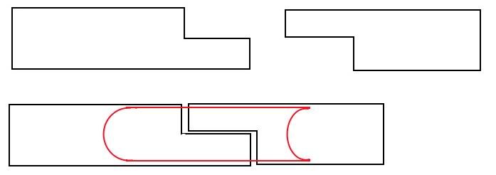

Hmmm never seen that on a second gen before, but I have done numerous frame repairs, as well as frame stretch's shortenings, c notch's ect...
Get some C channel as close to the original frame size as you can. Cut out the rotted area weld in the new C channel. Some guys just to a straight cut, but I think that is hella sketch. I cut my frames with a step ( I will ms paint a pic in a few minutes). Get it straight tack it, double check squareness, and then burn it all in, grind it flush and fish plate both sides. Some guys Like to leave the out side of the frame just welded, or even ground, and only fish plate the inside. Cosmetics is the only reason I can think of to do this.
I will make up some ms paint pics when I have a couple minutes (I am at work)

The red thing is my best attempt at a fish plate. Plates should never be square on the ends, they also don't have to have one going one way and one going the other, they can go both the same way. (OOO) vs (OOO( vs )OOO(.
I hope this sort of makes sense.

dvst8r that does make sense. but its not only on straight parts of the frame though so i dont know how that would work. i wonder if angle iron would work, like i said its only the bottom part of the C thats rotted, the side ok so maybe i could weld it to the side and that would reinforce it enough.

I like to cut out the whole section if it is rotted, but you could just use angle iron for the straight sections, and flat bar / plate for the curved sections. It would be a bit annoying to bend the flat bar to match the shape of the frame, but not the end of the world.
