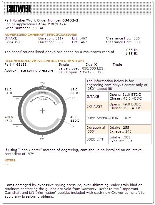

Also here is a screen shot of the cam card that crower directed me to. we dont have the tools to degree it but crower said these cams are best at 4degrees advanced on the intake and 4 retarded on the exhaust so we split it in half and did 2 degrees on the cam gears advanced and retarded. (Crower said we could have them at 0 degrees and the would be fine so we just choose to do 2 degrees instead of the 4).

The picture shows the cam specs, says part number: 63402-2, Grind number: special.

The picture is of the Crower Cam card. it cannot be a special grind because its offered on their site with those specs on the cam card. they are NA cams with the crower valve train to match.
