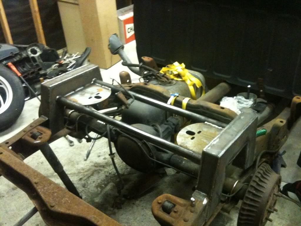

I can't figure I why people do this, but it's some of the most fun I have had fabricating. A guy on a local forum wanted to do this to his truck but can't fab to save his life. It seemed interesting so I told him to bring it over. This is just a phone pic, I will snap a few more as it goes. Anyone else here done one of these before?

Thanks. I'm pretty sure the frame is stronger now since the notch is thicker and boxed rather than being C channel like the rest of the frame.
I'm really having way more fun building it than I should.
Shooting to have the cross tubes in that connect the two notches together and all of the bag mounts in tonight.

Staying with the mono leaf or are you going to 4 link?
In my experience the mono leaf rides like ass, and you will need a traction bar of some sort. As was said C-notch looks good, yeah I would have no worries about that holding you did lots of plating. I have done a couple full C-notch's like that and a couple mini notch's (just to the top of the frame and used a half piece of pipe welded in for the reinforcement.
4 link really is the way to go with that.
One other tip: just tack the bag mounts in, as you will probably move them about 12 times, before you find a spot where they fit well and ride well.

It will be mono leaf for a short time then it's going 4 link.
We don't have much of an option for bag placement though. He got some short 6" bags. I plan to put the bag mount as low on the notch as I can so it has a little ground clearance at full lift. This truck is going to be a daily driver as soon as he gets his license back.

I just took a second look at the pic, and realize that you already have the bag mount on the axle. I typically like the leverage of having them forward of the axle, and the shocks behind the axle. BUT it really depends on each setup.
Even though it is bagged, and lots of bagged setups do ride soft like old caddies, don't expect this one too, not with the mono leaf, and not without playing with the bag placement.
I assume by the sounds of this though, he is not in it for ride quality so much as the look of adjustable suspension.

That bag bracket on the axle is just sitting there. We could do something else. He bought parts to put the bag on the axle. I'm limited on placement unless I make my own parts. I could do it, I have a plasma cutter and a nice drill press. Do people mount the bags on the leaf springs like a 4 link? Seems like it would ride funny

Nope build a mount off the axle coming forward of the axle. The increased leverage on a light truck will typically make it ride nicer, and if you mount the shocks off the back and out board of the frame, really help to keep it stable, and let it control the ride better.
Once you go 4 link you can play with bag placement off of the links and things like that.
Really if all he cares is that he can make sparks. Just put it on the axle or where ever is easiest. Don't go out of your way if he doesn't know better.

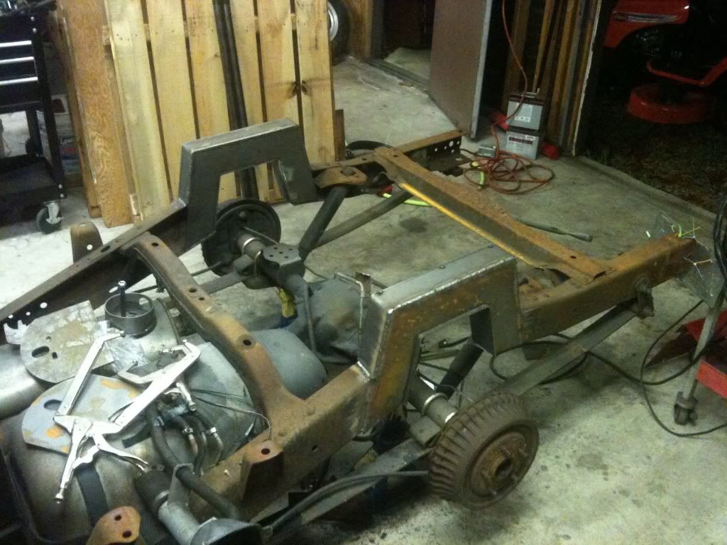

Got a little more done tonight. Had it going up and down with an air hose. It made me laugh.
Next is to notch the x member and cab for the driveshaft.
Hmm...shouldnt have to notch the cab.  He isnt using some giant 23" rims or something is he? Biggest I had on mine was 17s, had to notch that crossmember but not the cab to lay frame.  Not sure if you got to the front yet but the lower control arms need a bit of work to get the truck to really lay down right.  You'll see a little raised section (i think it has the bump stop mounted there) that needs to be cut out because it hits the frame.
-Jay

It should lay frame without notching the cab on the little 14"s on the truck now but he has plans of 20"s. We will probably tackle the front Sunday. Lowerit should be showing up at my house later today so I will be spending the next 3 days helping him with the GRM $2010 car. I will probably hook up the T with a shrader valve so I can air it up and move it tonight though.
