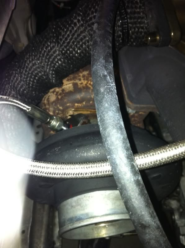

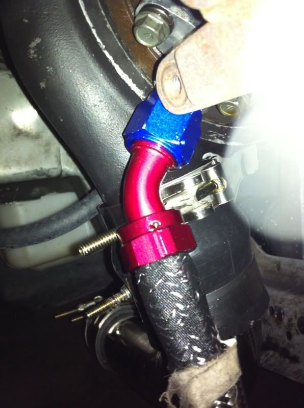

So my hx35 came used with zero shaft play. I tried to remove the exhaust housing for cleaning and clocking and noticed two of the four bolts were directly in position of the oil flanges which made them impossible to remove. Playing with heat a month later Im seeing that I probably could of tried to throw the torch on it for a few and try to rotate it. Anyhow I installed it and the inlet/outlet are angled, but I tried to do my best with the drain to compensate for the degree its at.
I didn't use any thread tape at all and I can see its coming from the turbo side.
The inlet side of the turbo is facing down for a visual reference as I could not get much of a picture
View from drivers side
Passenger side view of drain

Everyone seems to think its the clocking of it that would make it do this. Will try to do it soon and see if it fixes the leak issue. Any more suggestions feel free to post as its going to be at least day or so before trying to do this. Thanks

Maybe teflon tape the threads?
Re: Holset HX35 Oil Inlet Leaking, Why?
« Reply #9 on: January 22, 2012, 10:36:51 PM »
I teflon the drain threads and aluminum with rubber oring crush washer on inlet.

Yeah what fitting are u using for the inlet feed? It normal uses a fitting that uses a crush washer/oring style.
« Reply #11 on: January 23, 2012, 10:19:26 AM »
This.
It is either an M14x1.5 or an M12x1.5 female inverted flare fitting depending on what it came off of. I have made some hokey things work in the past, but it is best to just go to a hydraulic shop with the turbo, and get the proper $2 fitting. They should have metric inverted flare to JIC (JIC is the steel hydraulic equivalent of AN).

You shouldn't have to remove the bolts to clock it, just loosen them. Most turbos will end up with oiling issues if the inlet is set more than 30 degrees from vertical (both side-side and forward-backward).
Your inlet prob is likely just using the wrong thread. If you use a tapered thread (seals with threads) on a parallel thread (seals with crush washer or o-ring), you will always have problems.

You got me Russ. I just know that this fits my hx35. Measure you threads, and hole diameter and see. Or get a bolt with the same thread pitch and size to double check. It's a straight thread like a bolt, not a tapered one like pipe thread. and mine seals with a crush washer.

Ok so teflon tape and a crush washer did the job. I did notice some white smoke though which I didn't get last time. Thinking it needs to be clocked for sure now. Thanks all for chiming in
