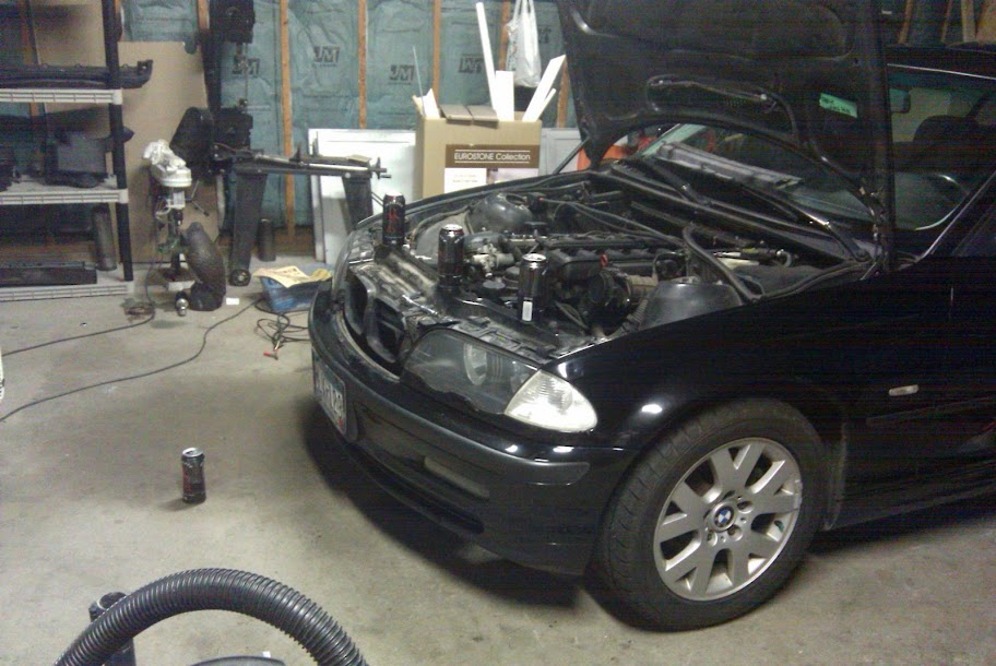

doin that.  oem service manual is overly complex, bentley is good. probly not experts if they say its impossible but ya you need some special tools to lock the cams and compressed air to apply pressure to the oil fitting for vanos.  you guys make somethin to pressureize the vanos?
some "experts"  will sell a swap because if it was overheated enough it weakens the threads in the aluminum block and they pull out when re torque the head down.  then you have to timecert  it or some shit
so pretty much you want to loosen and retorque before you bother pulling the shit, which i did last night, round 3 of tightening and the center stud got too easy to turn   :'(  didnt have much hope for this motor anyways considering a swaping in a 330/x3 motor now
what id like to do is throw in a iron block single vanos motor from the e36 but from my searching i would probly be the 1st to attempt it   convert to obd1 for boost probly have to keep the stock siemens dme or nothining would work and run a obd1 dme
fuck if i had the time id do some rhmt shit
fuck bmws
