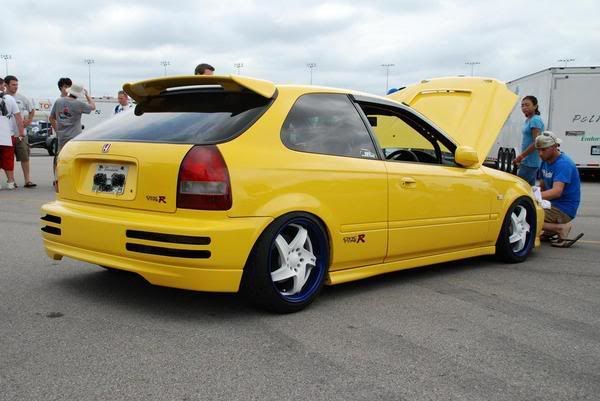

Wonder if you experiment with a second radiator in the back w/ fans underneath the bumper.
Where holes are usually cut better drag reduction.
And with a belly pan to help smooth the airflow towards the back.  :noel:
