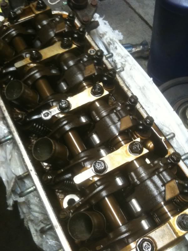

d16y5 roller rocker head and im in need of a better cam, it will be replacing the y7 head on the high comp stroker motor, if its possible to get a higher lift cam and still retain the 12v operation down low it would be nice but not needed

From my reading the hx head doesn't really work like vtec. When in 12v mode it still has 16v opening.
It has 1 intake roller rocker running off 1 big lobe and the other off a thin lobe that just nudges the cam open to keep fuel from collecting behind the valve. The exhaust is just running both off one lobe.
When it transitions into vtec it just locks both of the rockers together to fallow the bigger intake lobe.
So above 3000ish rpm it's acting just like a more efficient regular 16v engine non-vtec that can take much harsher ramp rates and lift because it's roller
