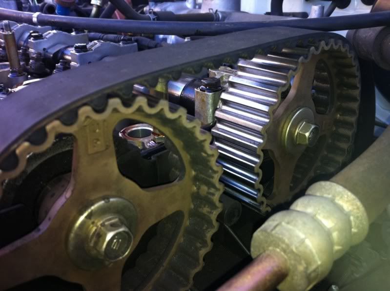

« Reply #13 on: January 06, 2012, 08:00:50 PM »
Have not gotten any further yet. Look at the cam on the right. Belt is loose

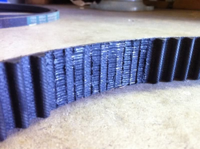

So it's possible the timing belt never was changed. Replaced all belts, water pump and she's running again! Thanks for the help
There was another strip of teeth missing off the timing belt not pictured

I'm not surprised, glad it worked out :P
I'm surprised by the missing teeth tho. Mine always snapped.
