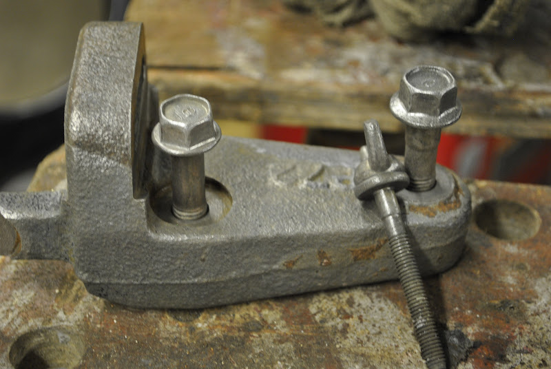

I was watching videos on Youtube to know the techniques people use to remove rust and found out a video about CLR. The thing is that the previous owner of my house left a full bottle in the bathroom so at midnight Wednesday I decided to give it a try and removed one of the PS brackets and put it in a CLR bucket.
The next day when I saw the amazing result I decided to try electrolysis to do a comparison on the second PS bracket.

CLR result (first bracket and bolts):
As you can see, result is amazing! You just put it in a bucket full of CLR and next day it's brand new, no effort needed.

Final comparison (electrolysis top and CLR bottom):

Conclusion:
Electrolysis is good for big part and heavy rust and you need little more effort to use it and it's free (if you don't count electricity).
CLR is good for any parts that fit the the container you put CLR in, but it's especially good for bolts as you can put 30 bolts at the same time compare to electrolysis that you put one part at the time (with my actual setup of course). It's 8$ for 800ml so it's a bit expensive.
