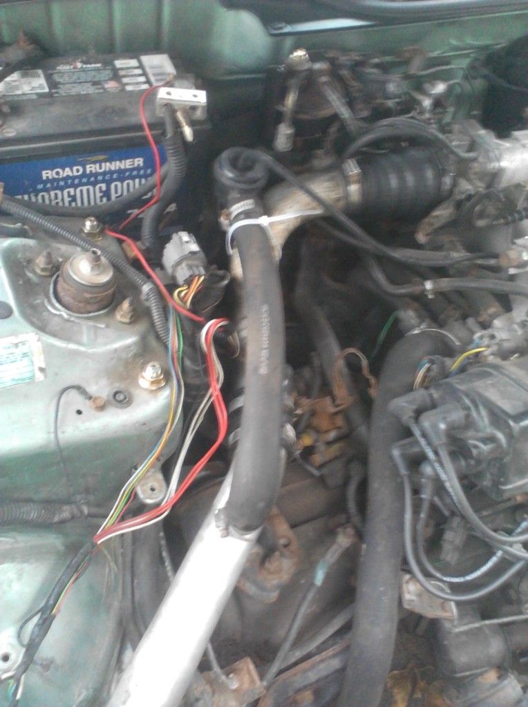

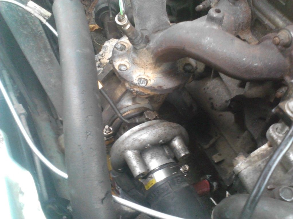

My friend Korey saw this little tdo4 on my floor and said hey can we put that on my car?
He just happens to have a eg with a y7 swap. the rest is well lots of beer and a weekend.

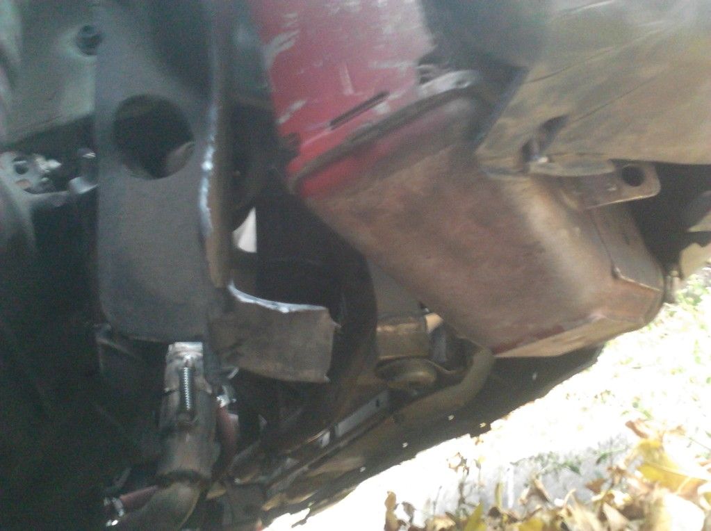

didnt have a j pipe and the junkyard was all out so we made one and boy its a sweetie

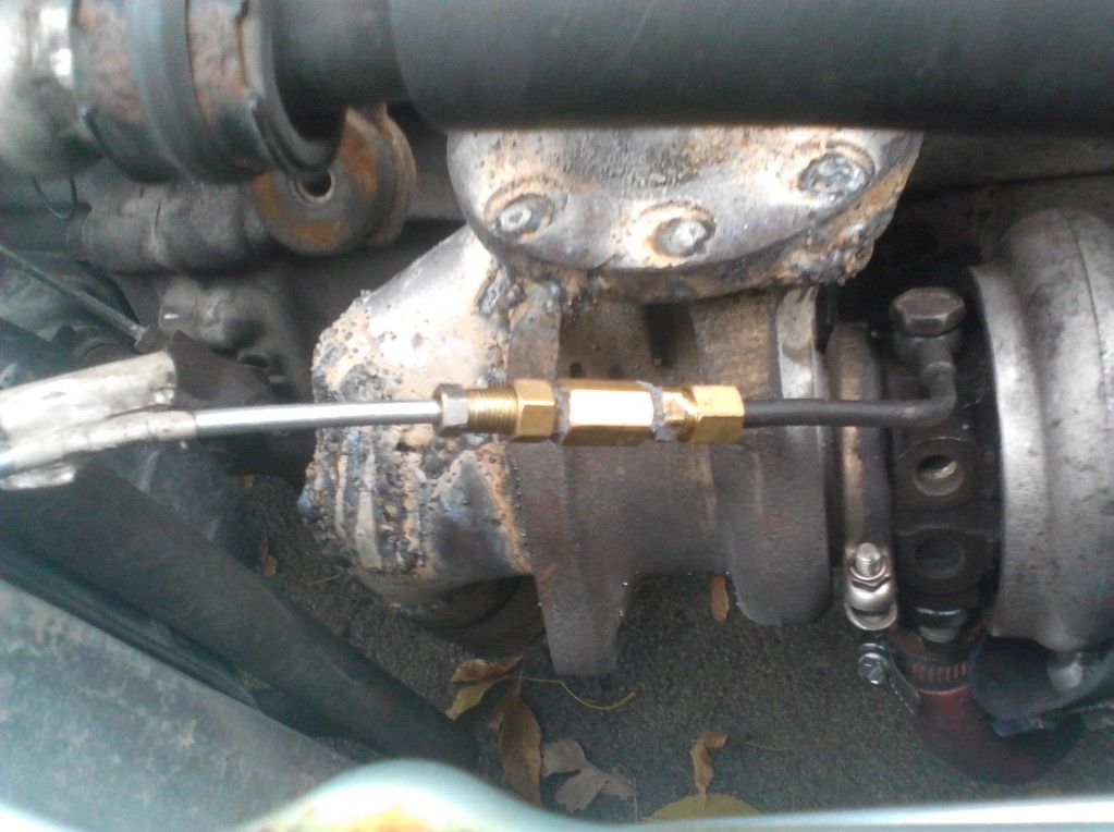

Brake line oil feed,you can also see the baller downpipe fab lol. korey made that.

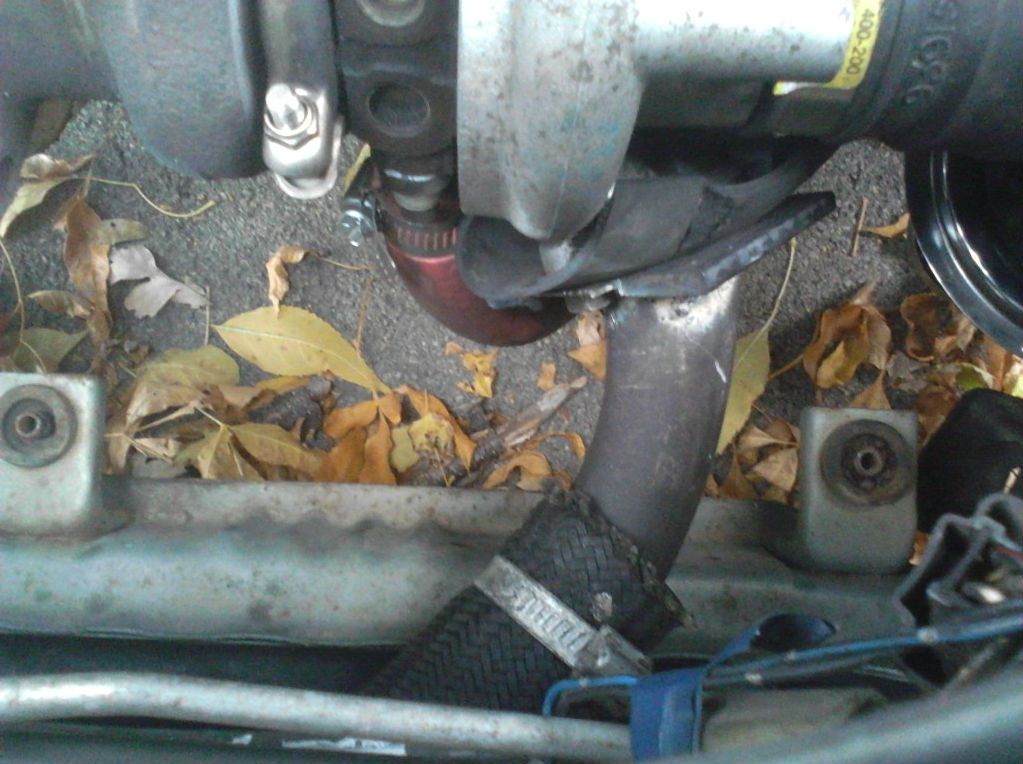

saab chargepipe cut and fit with a volvo tb boupler
2g dsm smic hidden away in the bumper  O0 Also get to see that kick ass exhaust fab with a spring sealed joint. It actually kicks ass and might start doing it more often.

3/16 brake line
a bunch of plumbing fittings cramming that npt into the block like a boss.

random peices of charge pipes from all kinds of cars
some chunks of 2.5" pipe

The exhaust is easy and can be made anysize just get 2 of the smallest transion exhaust pieces. Such as 2.5" Id to 2.5" od and slide them together 4, 3/8 or m10 nuts and heavy duty springs we antiseized the on pipe and it formed a nice seal just grease or red rtv should work as well. I bought everything at fleet farm.
