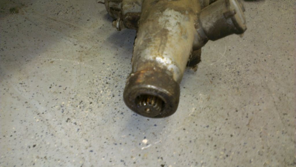

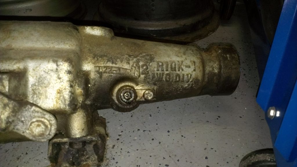

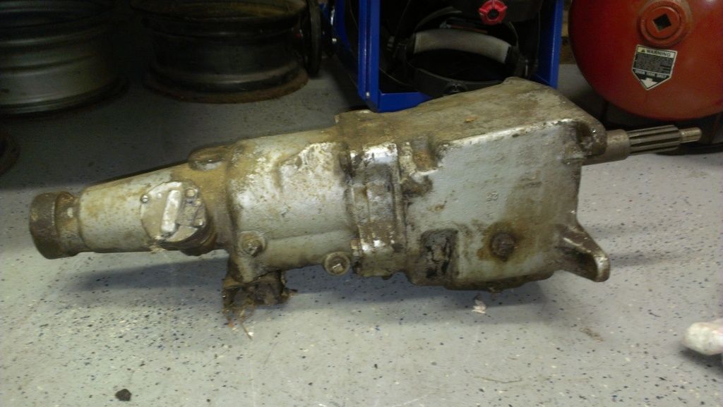

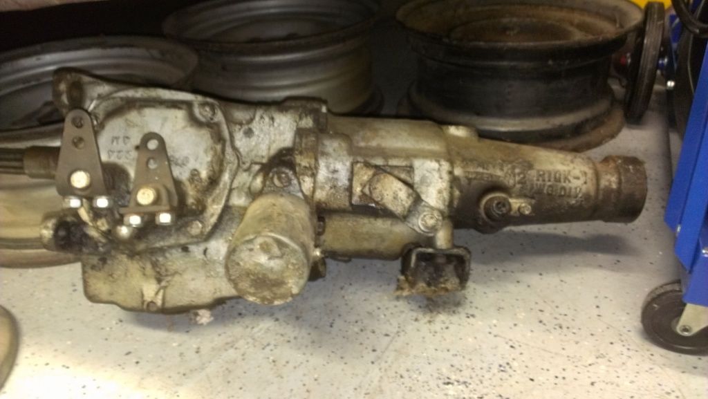

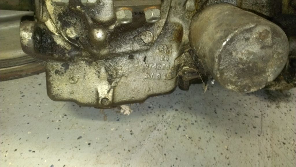

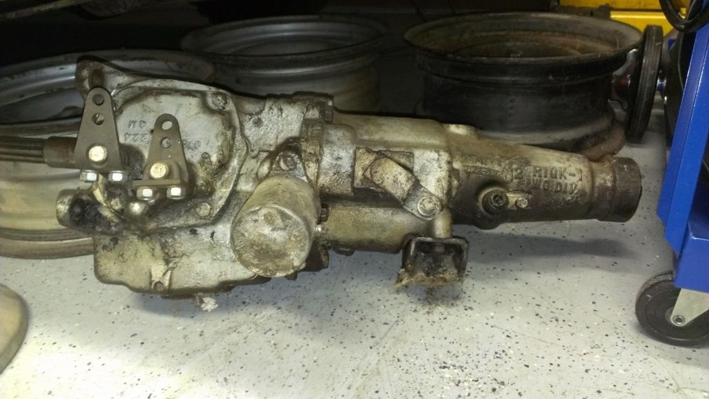

Found this in the garage @ my dads over the weekend. Brought a whole trailer full shit home from there. Cant find shit on this.

i may have a correct answer, muncie 319 three speed.  four bolt side cover it a big identifier.  Came in all kinds of shit that was chevy in the early to mid 60's.  If you dont want it i would take it to a hotrod shop or trans shop and have someone take a look at it, it may be worth decent money.   :noel:

Moncies can be worth cash.
Is the casing magnetic?  That will narrow it down a little more too.
Re: What manual transmission do I have???
« Reply #4 on: November 06, 2012, 05:26:02 PM »
Yeah, it's magnetic. I have the bellhousing and clutch release fork too. I'm sure that can't hurt the price either.
