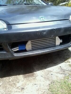

cxracing intercooler kit 2 1/2 piping w/ F.M.I.C

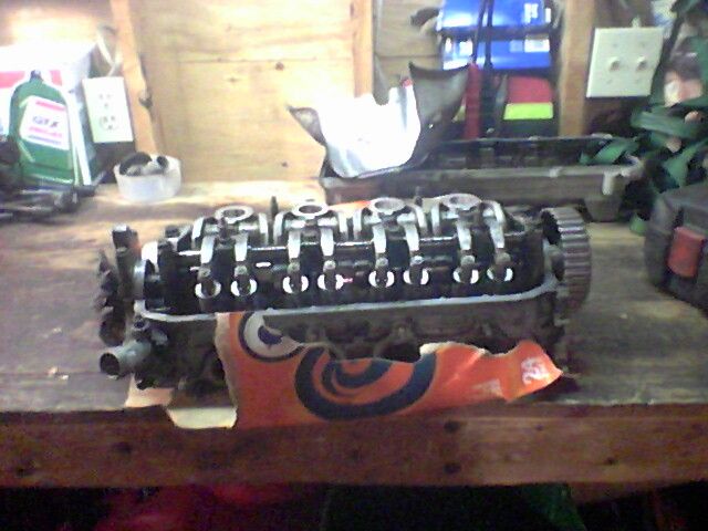

B7 head

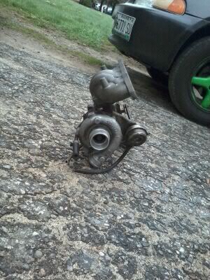

R.I.P little garrett

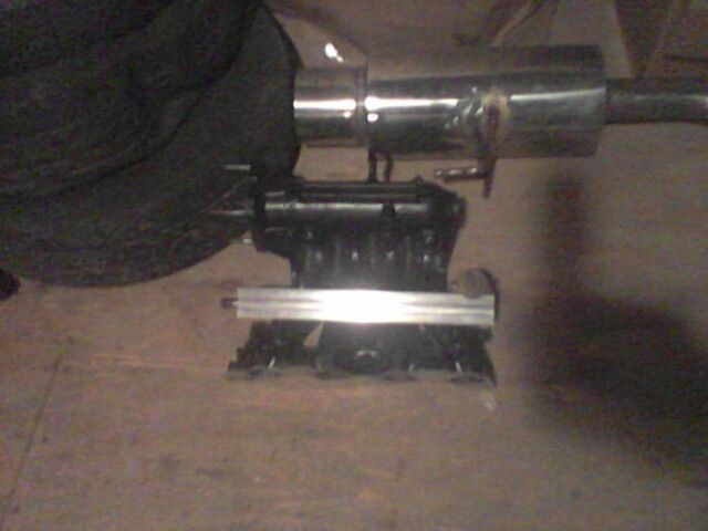

my home made vac manifold
FMIC installed no clamps on couplers

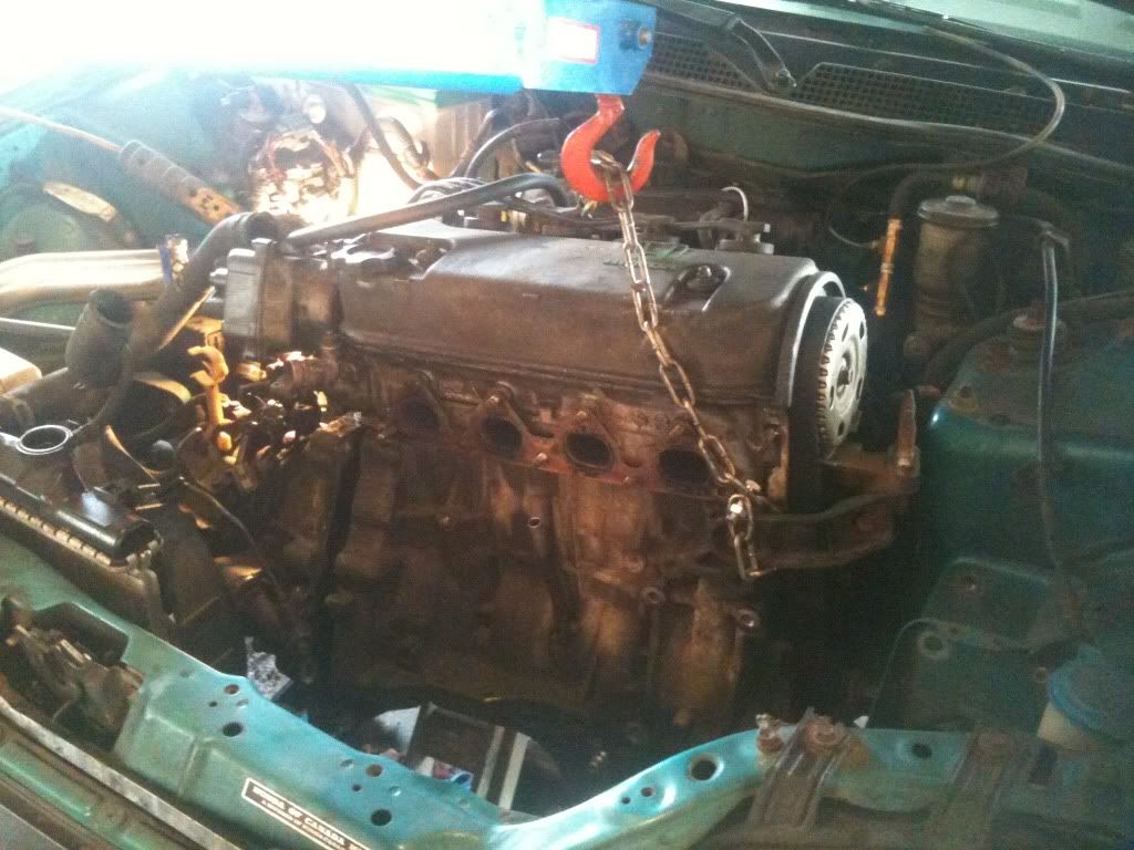

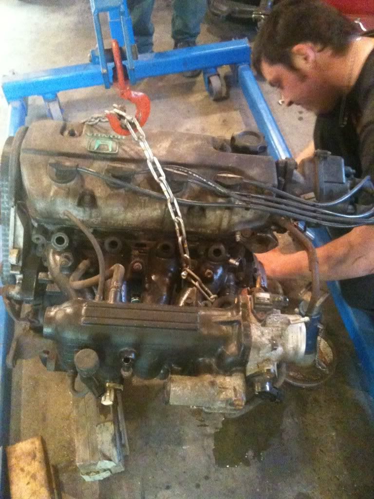

pulling motor to install clutch and all the turbo stuff

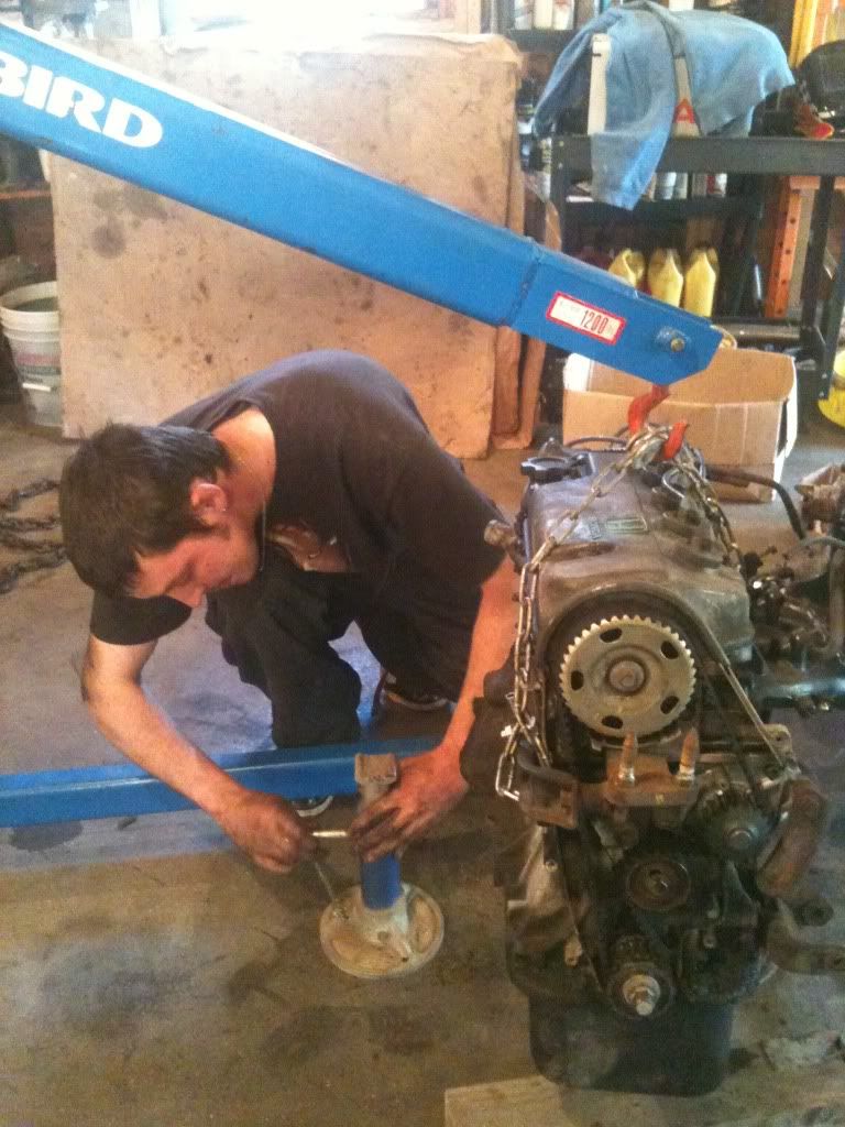

me and my pops putting the motor back in the car

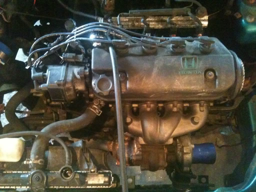

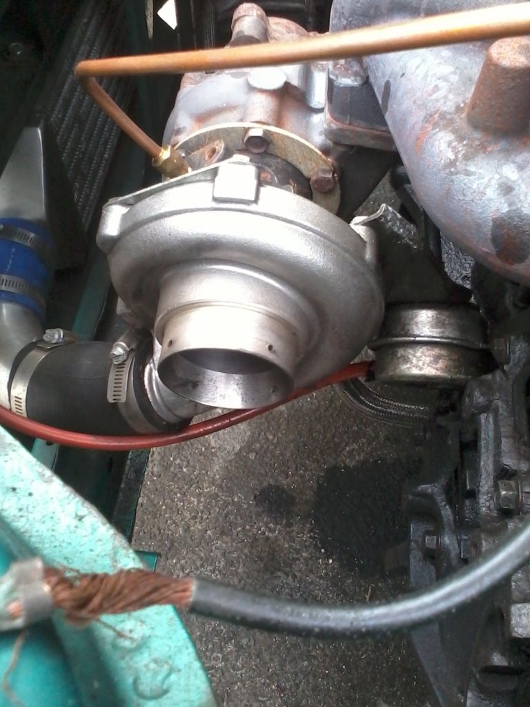

ebay turbo installed

Your feed line is clocked incorrectly.
Re: project turbo civic hatch d15b7
« Reply #6 on: November 26, 2012, 09:56:04 AM »
Yeah no more than 15deg from vertical.  :noel:
