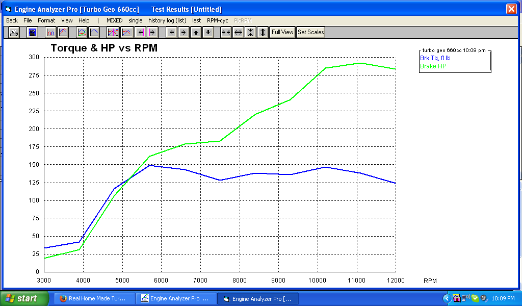

I have modeled the engine in engine analyzer pro and have some promising results.

also looked at this route as apparently they designed the engine around the suzuki g10 but its a 1.2L. and has a much different front cover with balance shafts and all kinds of other BS. The crank snout doesnt exactly bother me as I can run a dry sump setup with a small 3 stage pump but I am hoping to avoid really reinventing the wheel. that being said the first engine is going to be a bit rough anyhow. this is proof of concept once the first one runs then I am in good shape. My analyzer which I hope to be acurate(it better be its several hundred for the software) says 200+hp/L is not out of the question even with dinky 30mm/28mm valves. I imagine the heads are going to be reworked to the point of machining out the port with little regards to passages/galleys I encounter and fitting/welding tubes to facilitate much better valve to port angles.

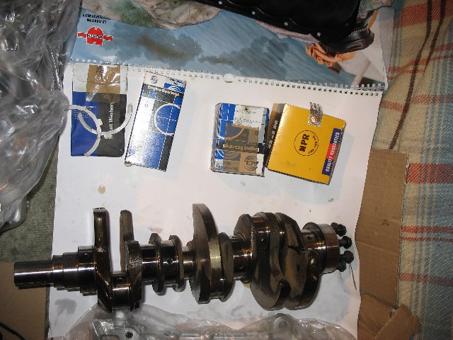

Got a quote to destroke the crank 800$ was cheaper than I was expecting so expect a Build thread :)
