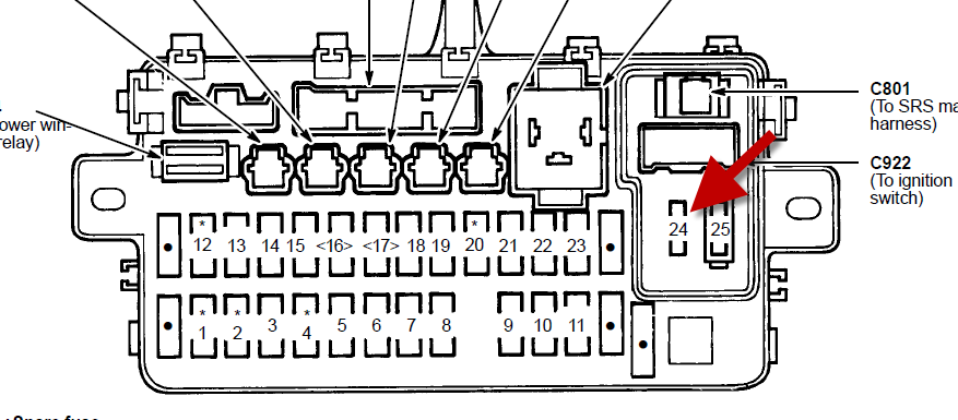

Manual says check acg s fuse under the dash 15 amp, but the fuse diagram doesn't show which fuse that is.
Next step would be to check for a break in the wire from that fuse to the main relay.
Anyone know which fuse that is?

I really want to know which fuse it is though so I can have him check the fuse and wire in between.
I think its stupid the fuses aren't referenced by their number in the manual, or at least by the name that will be listed in the fuse box section.

Iirc that's the pgmfi fuse no?

idk, found a better explanation of the fuses on a google search over my shitty phone.
not sure why my manual lists it as SRS and pictures I see online manuals explain what it really is.
But it was this little bitch right here.
Got a list of shit that goes through it as well.
I'll pass the info on to my buddy and wash my hands of this pos.
