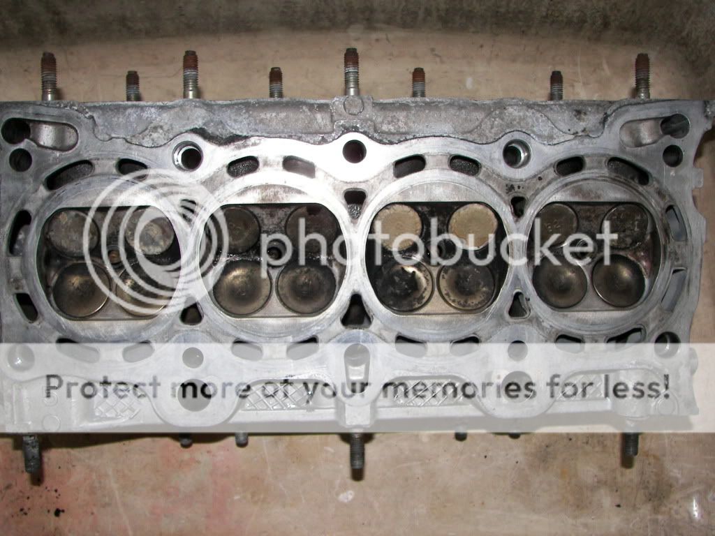

so i was drivin home from class and as i was drivin over the bridge my car started to sputter a lil ...i was like what the fuck ...car had like no aceleration at all got it to the bottem where my house was and parked it ...was still sputterin ...had a buddy say it was a poss head gasket so started pullin shit off ...got the head off and set it aside gasket looked semi good and i was gettin anoyed at the fact that this could not be the prob ..so i flipped over the head and found ......

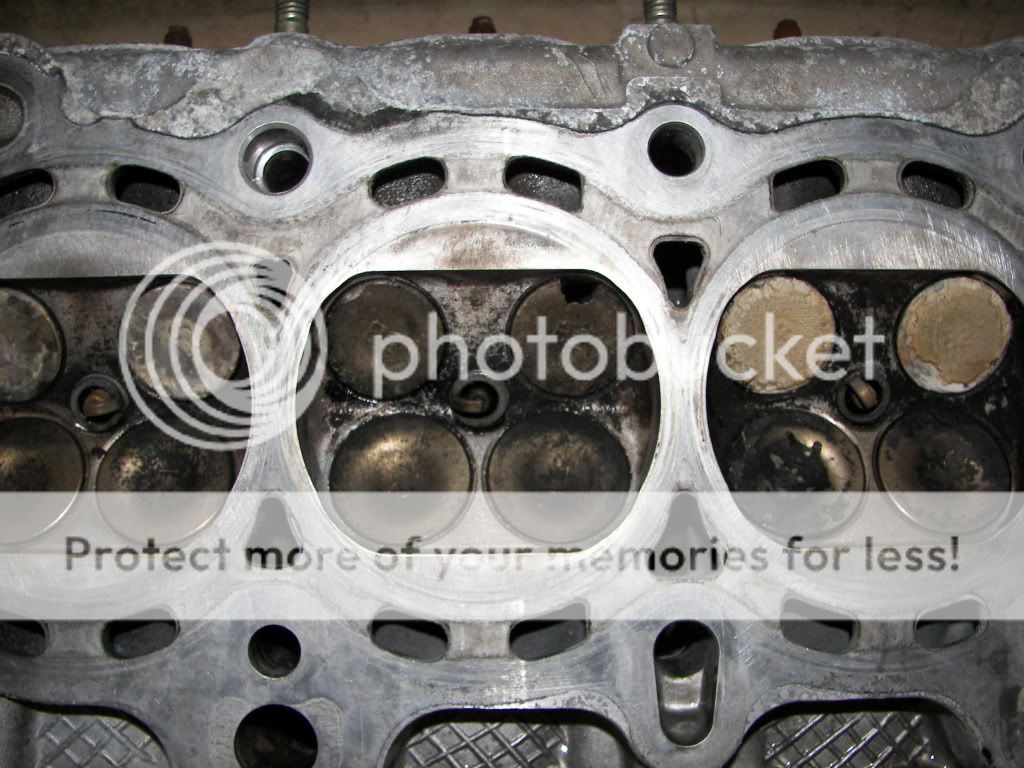

so i got another y8 head off a friend of min eand gunna put it on this weekend ...but does anyone know why the exhaust valves on cylinder 3 would have all that white corrosion on them ... im thinkin i could be runnin rich
p.s. block and pistons are fine but the pieces of the valves are mia ...thinkin there in my turbo or got fully shot out the exhaust

Man thats just buildup of hydrocarbons from unleaded fuel on the face of those valves. It’s no big deal. Most high mileage motors that you crack open have all the exhaust valves looking like that. It's actually kind of a, or could be a sign that that was the cylinder that was running the best.  #3 and #1 were running good. IMO even without the torched valves in #2 and #4 they were running richer.
     Don't worry about finding the pieces of the burned valves they got vaporized from the edge in they didn't just break off.  I'd say you just had a really bad tune.
Y8's are really tough to tune imo the hardest Honda engine to get right. When you put the other head on it's only going to do it again. If you don't take care of the cause
   You’re going to need to tune it again. If I were you and I’m talking from my own experiences with y8's and z6's. Do yourself a favor and get a z6 head. Z6's are way more boost friendly Y8's have quench pads for higher compression this is not a good combustion chamber design for a turbo engine. They were purposely designed to run well at part throttle na. wich really goes against what you need for boost
      If you do run another y8 head just make sure to take lots of timing out of it. They love detonation.
Y8's have a bad oiling system they have lots of gayness with the cam gear you have to add 9 degrees to base timing to get them to run correctly on an obd1 ecu and the intake manifold is junk.
  LOL on my crx I ditched the y8 intake manifold for an a6 one a6's have a way smaller throttle body so I took a drill and drilled out the bolt holes on some way larger random Honda TB it didn't line up with the a6 IM and bolted it on.
   blah blah I'm typing to much but what I'm saying is  ditch the y8 top of the motor and run a z6 it will make more power be more reliable and you won't have to deal with Y8 bullshit like you’re in now any more. Y8's they will fuck you at every angle

Fucking oil burner right there, those exhaust valves were getting hot and baking it on.

Does the quench area issue apply if I'm running vitaras at 8:1 comp (deck 0.020" of block)?
Does the oil issue apply if I'm running z6 block with a ported and shimmed z6 pump.?
DmC
  • Posts: 3036
Re: my bad day
« Reply #4 on: October 28, 2009, 01:34:39 PM »
No the vitara's and z6 block take most of the problems away. I still say get a z6 head though.

Yeah I have 3 z6 head either whole or for parts but I ported my y8 head and matched to z6 IM.
So I do not feel like lowering my comp. any further right now.

Use a z6 dizzy, one head stud is different (in the corner nearest to the vtec solenoid), and cam timing if you are still using the y8 crank pulley and a z6 cam/gear setup.

well ended up doin the y8 head  ( the z6 head i got had issues and i need this on the road like now ) got it on today now just havin massive probs with the timing .... gave up for the day should have an update on wed or friday
Re: my bad day
« Reply #19 on: November 05, 2009, 10:57:06 AM »
I'm assuming you used the z6 crank pulley and z6 t-belt gear? IIRC the mark on the y8 pulley will be for 12*, and the y8 gear will also be 4* or so off. IMO it's just easier to deal with those "hybrid" d16's if you use the corresponding pulley & gear.
You could probably use the z6 gear and sync timing to 12* (whatever the main mark is), then add 4* in that part of the map so idle doesn't suffer. Honestly though, I just stay as far away from y7-y8 parts as I can.
Re: my bad day
« Reply #20 on: November 05, 2009, 02:05:51 PM »
That results in cam timing being a half tooth off.
Cam gear should match cam (NOT head, as you can swap Y8 cams into Z6), crank pulley should match block AND lower timing cover.
Re: my bad day
« Reply #21 on: November 05, 2009, 02:12:41 PM »
Or get a adj. cam gear when using a y8 head/cam on a z6 block and adv. 4.5 deg. on the gear.
Worked for me ;D
