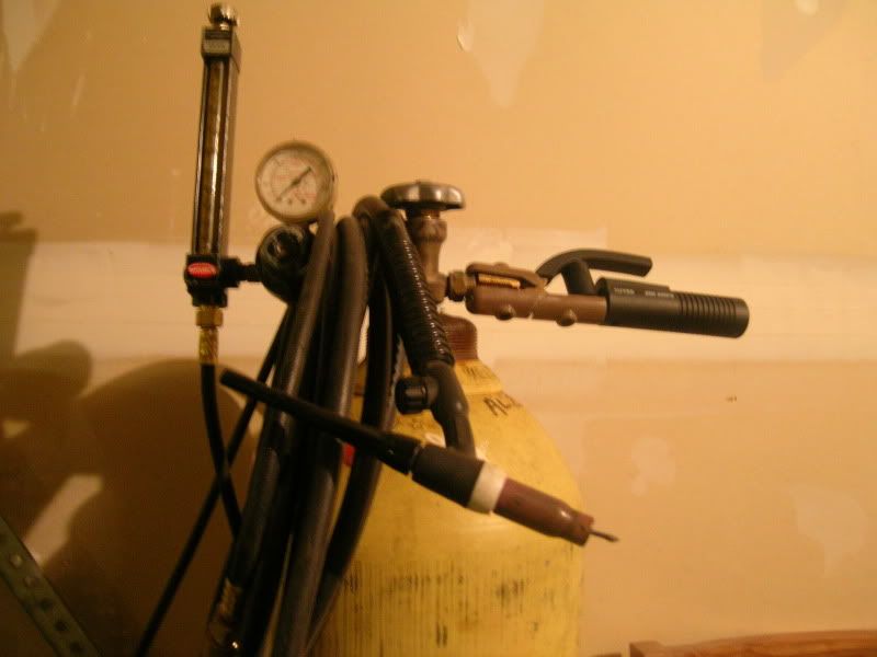

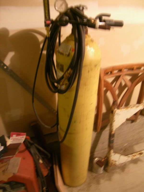

sorry it took forever to get the pics up.
heres my free bottle.
and i figured out what was going wrong with the flowmeter.

this is my first attempt at using a flowmeter so im a newb to it.
theres a knob on top of the meter part that needs to be opened.
also i put in there my stinger that i got for 5 bucks at nps. brand new.
twin50 son. get some
and stop acting like a muslim

might want to chain that sucker to the wall.  there are plenty of videos where those bottles lose the valve when they get knocked over
i love that one episode of American Chopper when one falls over and everyone just looks at each other and is like, "that could have been real bad" then they all go back to work cause they are so far behind schedule

if you look closely at the pic of the flowmeter you can see the tig torch as well. and you can see the knob on top of the torch for the gas.
as far as i know (i havent actually hooked this contraption up to power yet) you hook the -neg- to the part and the +pos+ to the power block on the same line as the torch.
i got that torch from my father in law and he told me how he used it. so im certain that this way atleast works.
