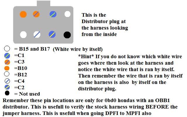

As I get time / cars to work on I will start updating this thread with more of my mad tyte ms paints.
Here is an OBD0 car with a OBD1 Distributor. I know this cant run but it is very helpful when trying to verify the stock wiring is correct when having a spark problem on a converted car. This particular car had a bad jumper harness straight from china. I hope this helps someone one day.

nice! anyway in boomslang you can get wiring for do this conversion, works great!

I was the 4th person to try and wire the car correctly. I think number 3 was the idiot fuck stick that read the ecu plugs backwards and was cutting and splicing the completely wrong wires. So yes it was 2 very long days combined with a ton of solder and 2 packs of 1/8 inch shrink wrap. :?:
