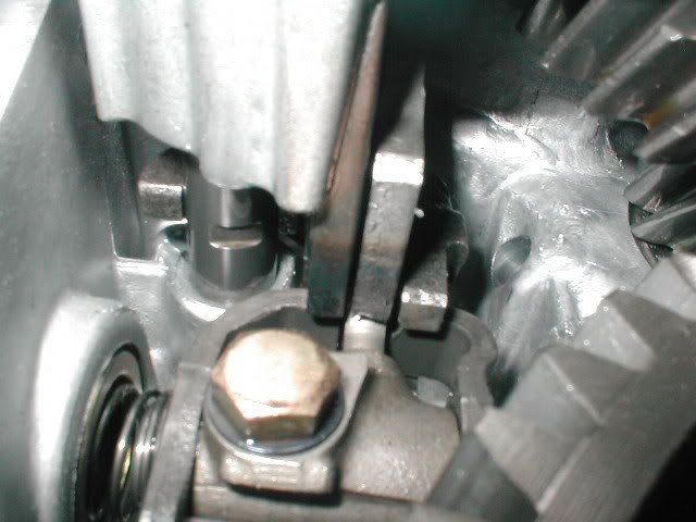

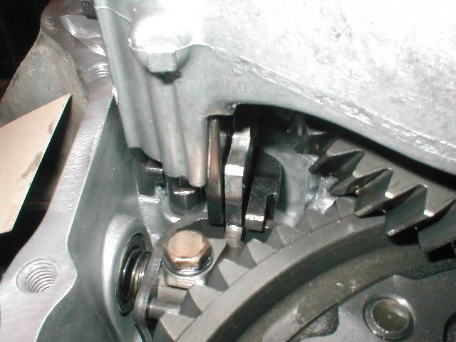

The rod connected to the shift linkage that goes into the transmission is suppose to move in and out when you shift. Inside the tranny it moves the gear stacks around. The part im talking about is at the bottom left of this picture:
That little sucker moves up and down when you shift and when I tried to put it together with the gear stacks and shifter forks, it was a real pain and I couldnt figure out how it sat together.
If anyone can help me and if im even clear enough (i hope someone understands) then a picture or nice explanation would be awesome. I gotta get this figured out so I can redo it tomorrow.

the three prongs that are on the shaft have to be inside the corresponding "U"s on the shift fork assembley.  you can check to make sure it works before you put the trans back together.  look at bone's pictures, thats what it needs to be like

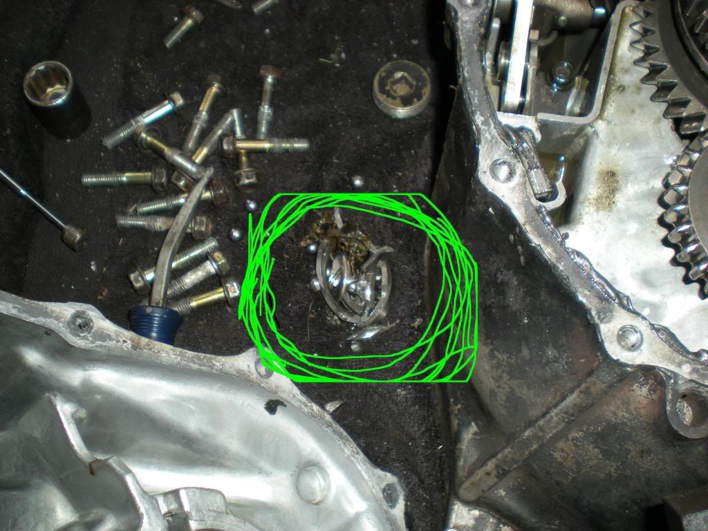

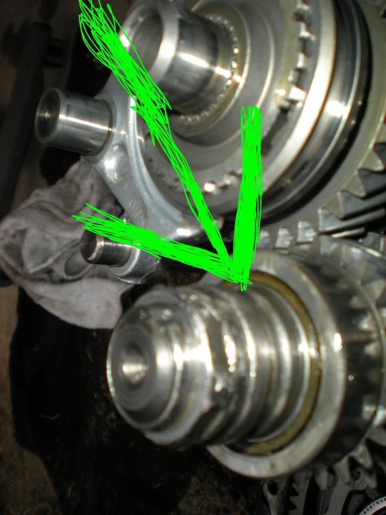

Well heres pics of carnage from my transmission.
It appears that when putting the case back onto the transmission, I was too lax about it and messed up the top bearing.  Then it got chewed up with all the shifting and struggling.  :?:
Circled is the bearing:
This is the inside band thats left from the bearing (where the bearing goes):
So later this week ill be trying again and taking better care of that top bearing, the snap ring with it, etc.  As for the gear stacks and all, well I got another set incase i need it.  Ill inspect the current one for damage, shavings, etc and figure out my options.  I wont even bother with that case.  I use a different one that doesnt have a bunch of shit in it.

« Reply #12 on: December 01, 2009, 04:33:49 AM »
he cracked the outer race when tightening the case together.
Likely ruined the lock ring in process, will need a good 2-3 hours to strip the shafts and deep clean EVERYTHING.
IF you plan on putting a gear set into a different case, you will FAIL since you won't bother to shim as needed.
Of all the "walk throughs" did you read the factory service manual?
How about stop, take a pic, ask a question before screwing things up???? I love tranny porn and have always been willing to answer "D"eez tranny questions.
I've made quite a few errors when I started learning, but never this one.

ya, you have to get the lock ring at least started over the bearing before you tighten the bolts.  it's not a bad idea to just smack the case with a hammer and a block of wood as padding to get the two halves to meet (after you get the snap ring started).  that way you don't fuck something like this up when you run the bolts tight
