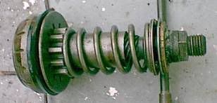

the whole piston looks liek this:
inside is this fucker:
you can see the inner piston at the end of the shaft. there's a seal around it that seals brake pressure away from that hole. it's when that seal goes bad, or there's internal pitting in the piston bore (my problem) when it starts to weep fluid into the section that's supposed to be sealed off.

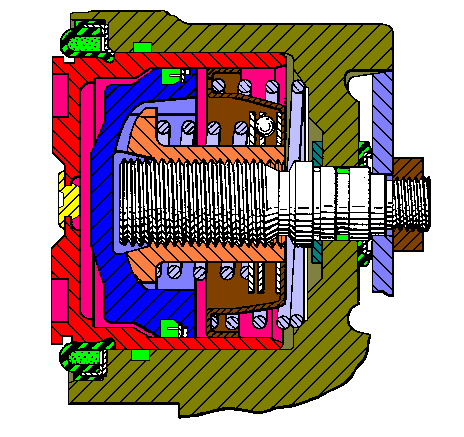

here's another diagram:
the small yellow area on the left is the small rubber plug GM put in the hole. light green areas are pressure seals.

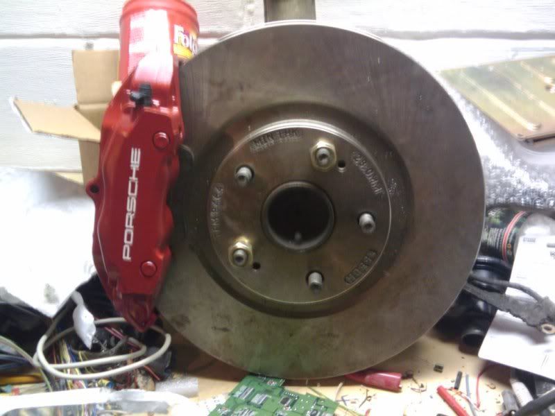

235/40/17 fronts with 255/40/17 rears. brad bedell did decimated the competition with 97 ft at the SCC USSC on stock 93t brakes with those tire sizes, but with tires that aren't as sticky as what's out now.
Quote from: 79fairmont
I have a nice set of sn-95 rear calipers and brackets that you might be able to use.
if the info i'm finding on those is correct, they're 38mm. that's way too small.

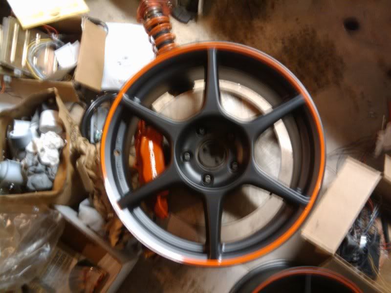

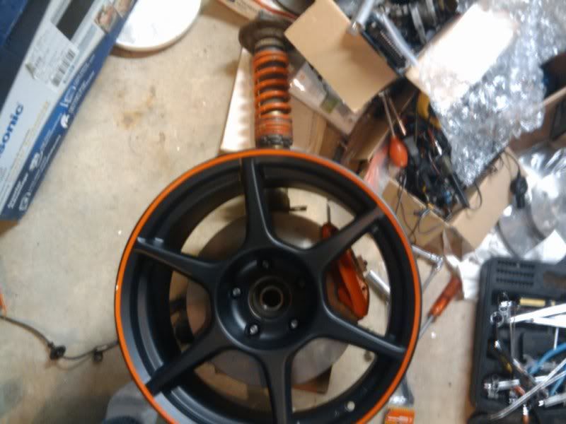

here they are bolted up with the brackets i made:
and the fronts:
if only my camera didn't suck ass.
