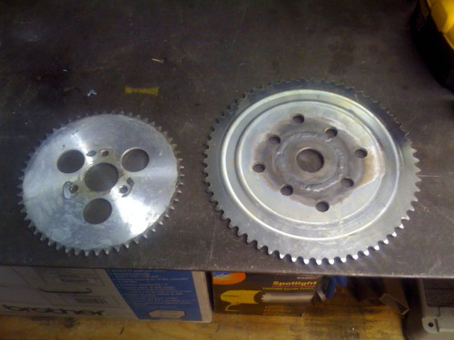

So I ended up doing the sandpaper wrap idea, and it worked just fine.  The 5/8 clutch is mounted on the 16mm shaft.  Sweet.  So now I needed to fit up a 60tooth sprocket for r#35 chain.  The opening in the sprocket I purchased was too big to be able to drill the new pattern in to, so I sized up a Grade 8 washer, tigged it in place, and drilled it tonight.  Let the test fitting begin!
