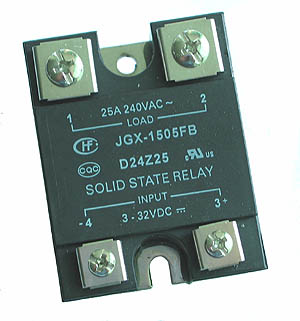

Re: Gpo just kicked my ass
« Reply #3 on: April 28, 2010, 01:34:16 PM »
They'll look like this:
or
« Reply #6 on: April 28, 2010, 09:36:32 PM »
Solid state relays do not take a quarter of a second to latch.
lilpooh21186, just like a normal relay.  They are labeled and everything.  Look closely at the pics I posted... they are DC switched AC devices, but you can get DC/DC units.
« Reply #8 on: May 15, 2010, 12:43:38 AM »
I've never tried an ac-dc solid-state taht worked with DC on the output. They must be rated dc-dc to work.
The cheap way to do this is with a big fat 30amp relay, they kick on in 1/10th a second. Name-brand will some with real specs. Otherwise find out the motor's rating and get some uber-fast relay from mouser or digikey. ATM I'm using a relay to control 2 relays off a GPO. The cutout opens in 1/3 a second, so the relays actually account for half the delay time.
