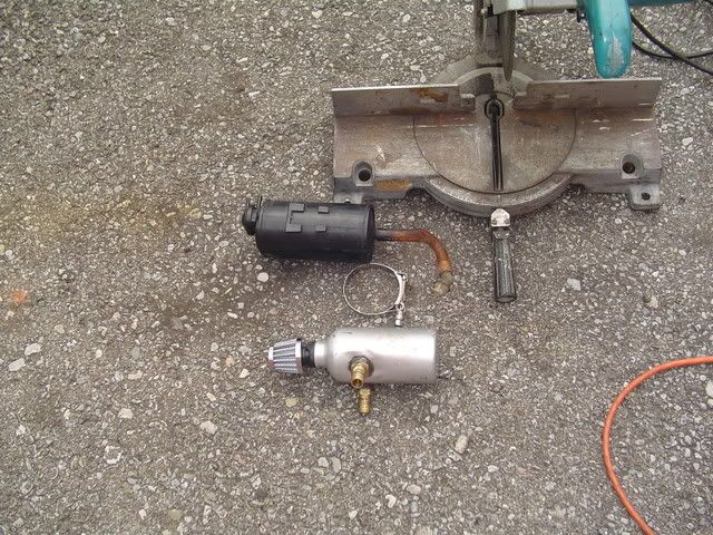

Ever since my valve cover gasket and oil cap were leaking I went ahead and grabbed some new ones.   At the hardware store I picked up some 5/8 heater hose and 4 5/8 pipe to hose fittings as well as some JB Weld.
At Advanced I grabbed a small filter for $9 I felt like a ricer while paying for it ):
Then I took  some weird Hugo Boss water bottle I got out of Fowee’s garage and drilled some 5/8 holes in it and my valve cover. I used some brake clean and water to rinse all the metal shavings out. It’s a y8 it doesn’t need any help spinning bearings
The breather filter worked out really slick. The bottle has a screw in cap so I just drilled a hole in it slightly smaller than the rubber hose piece on the bottom of the filter and squeezed it into the top of the screw in cap.

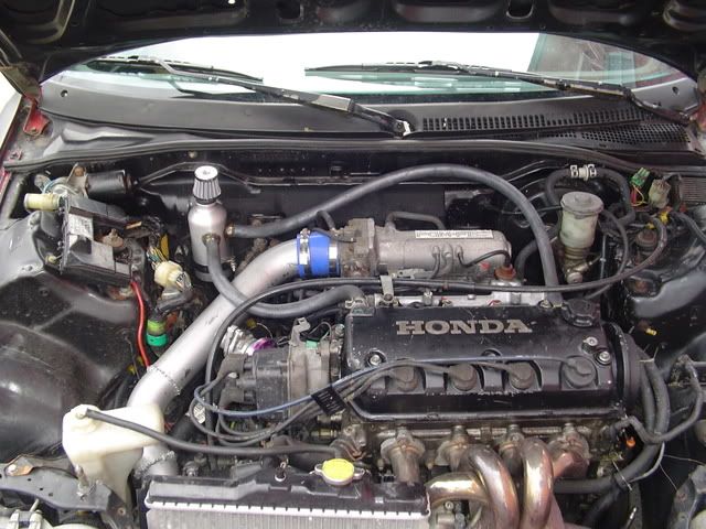

Here it all is ready to go back on the car.
I needed a good way to mount it so I took a hard look at the charcoal canister and decided it had to go. I took my chop saw out and cut the mounting bracket off of it and used a Tbolt clamp to clamp the bracket to the catch can.
Here it all is installed on the car. When I have more time I’m going to add a vent to the block.

i digg the look with that long ass tube runing off the firewall
I did that so oil would have to run up hill to get in the catch can any other way and it would have been draining right in and filling the can up all the time. And it looks serious with that big tube running like that.  :noel:
