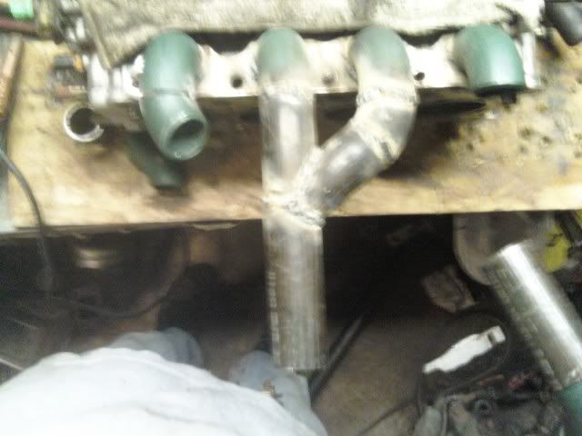

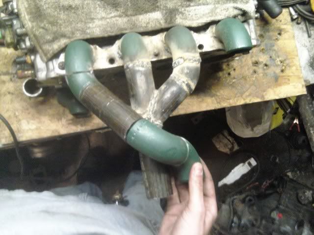

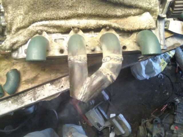

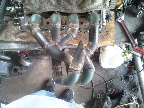

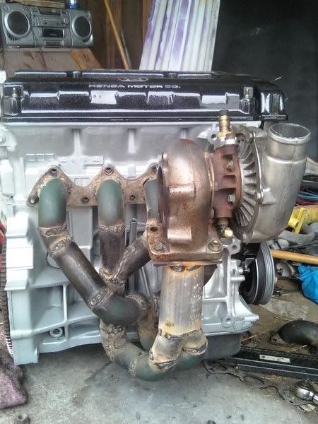

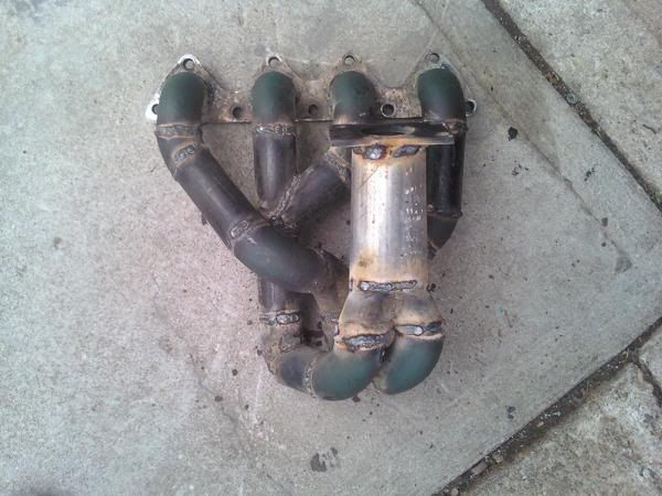

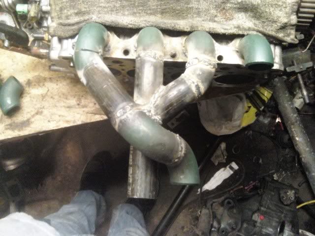

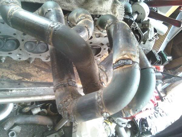

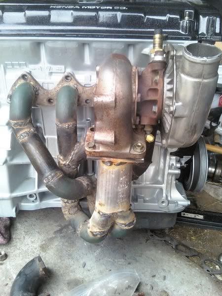

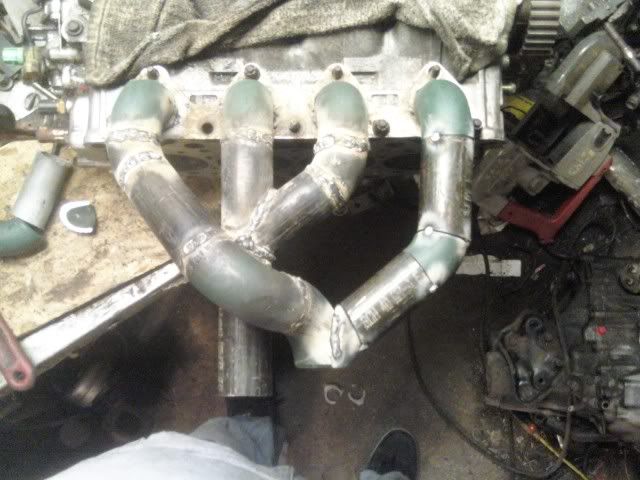

Ive been working on this for a day now. All done with a Hf dual mig 151 and some lincoln flux wire. Its going on the b16 that Im dropping in my crx in a few weeks.
Its not done yet. still have some more welding to on the back side and still have to cut a hole for the wastegate. Inb4 stay wednesday.

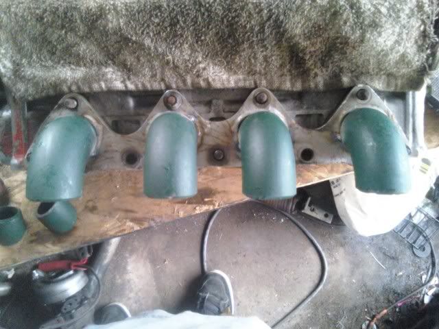

The real answer is. I said what the hell. I gotta make a manifold for the b16 when I swap it in, So I just went at it. Topmounts are the new logs.

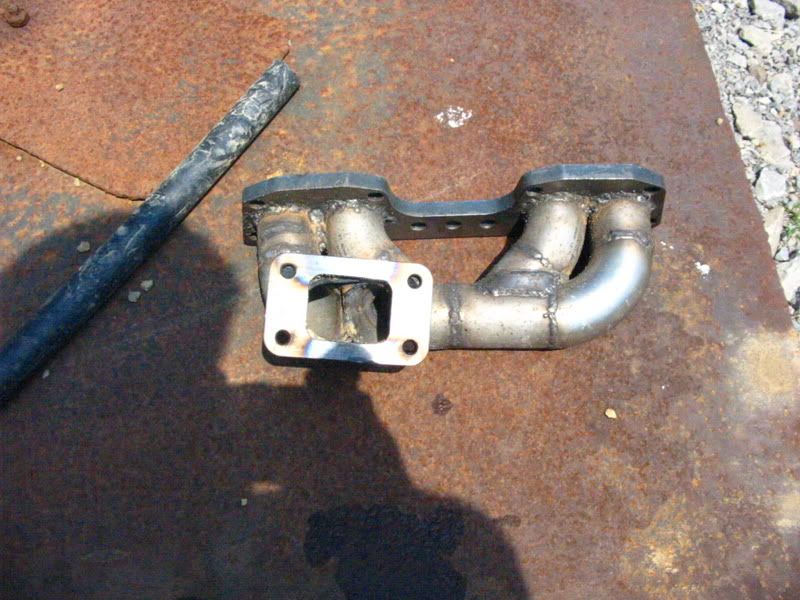

Lol...Fags
Re: FluxCore Topmount
« Reply #12 on: April 27, 2010, 04:08:11 AM »
where is complex

Well it does look like a step up from the fencepost manifold from back in the day, lol.
Edit: OMG I just goodled "homeamdeturbo fencepost manifold" trying to find a picture of that thing, I love the discriptions I found about 50 threads on other random forums talking about it, other discriptions just said stuff like "looks worse than the shit you see on home made turbo dot com", haha. That piece of shit manifold is famous.

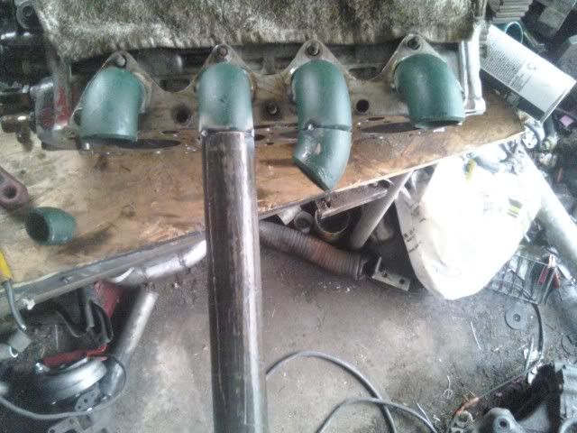

« Reply #22 on: April 29, 2010, 06:44:44 PM »
are those hand rail 90s?

« Reply #23 on: April 29, 2010, 06:57:40 PM »
No there are mild steel butt weld fittings. the kind they use in like boiler systems and other heavy industrial pipe systems

Can I ask how much you paid per bend and where you got them?

Pickrel Bros. in dayton. They were 8 bucks a 90 and I bought like 5 foot of straight pipe.
