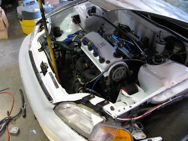

I did a wire tuck on my EG and finally got the car running last night.  The second time I tried to start it the pump didn't prime.
I have checked the pump it's fine , the main relay is fine , car cranks , has spark , but no fuel.
I have been told that if the injector wiring harness isn't grounded out the pump won't prime.
Thoughts??

The bolt that grounds the fuel pump harness to the chassis , right beside the drivers seat wasn't grounding.
fixed it and the car fired right up , no CEL's ...nothing..
