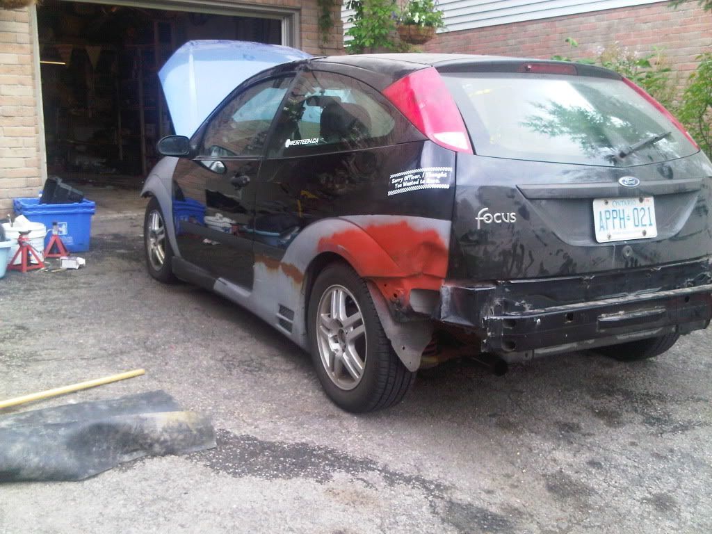

Havent been on hear in a while been busy working / school / and actually working on my car
so though i would finally put up a build thread of my shit box ford.
2001 Ford Focus, 2.0L Zetec Engine

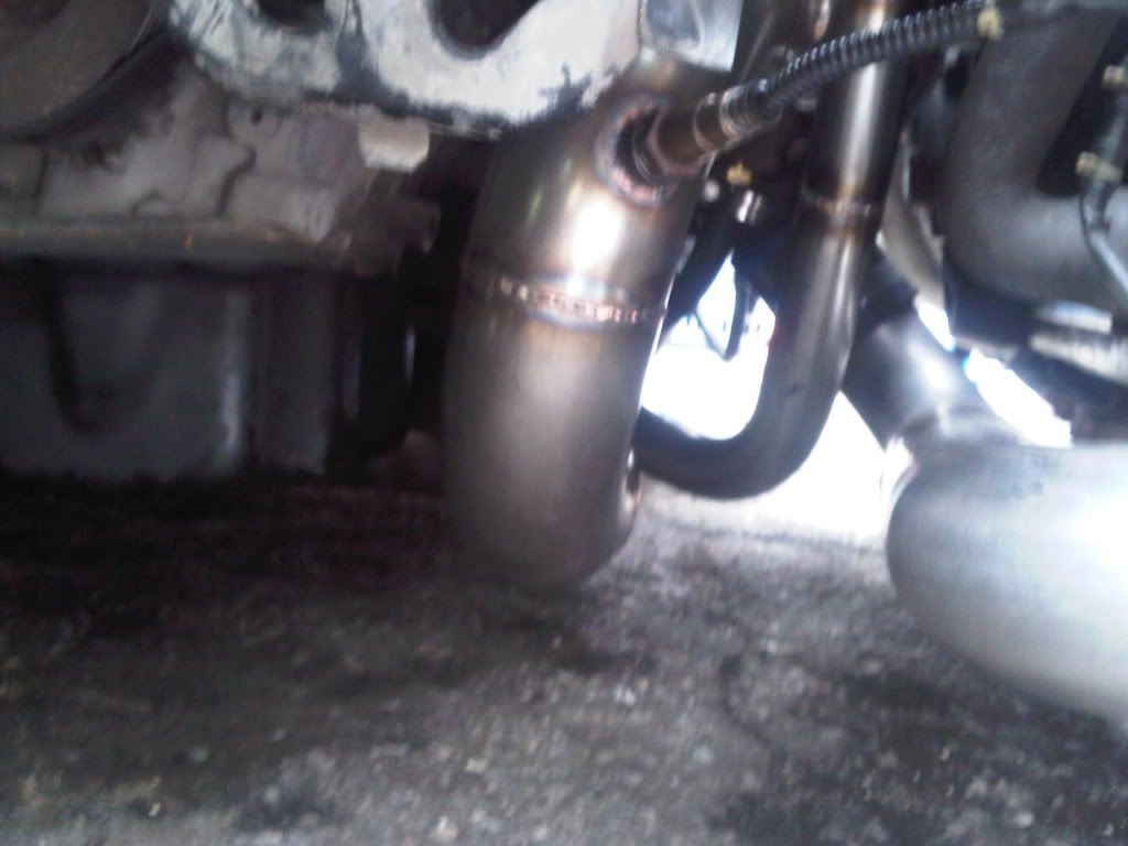

Full stainless 3" exhaust
weirtech exhaust manifold

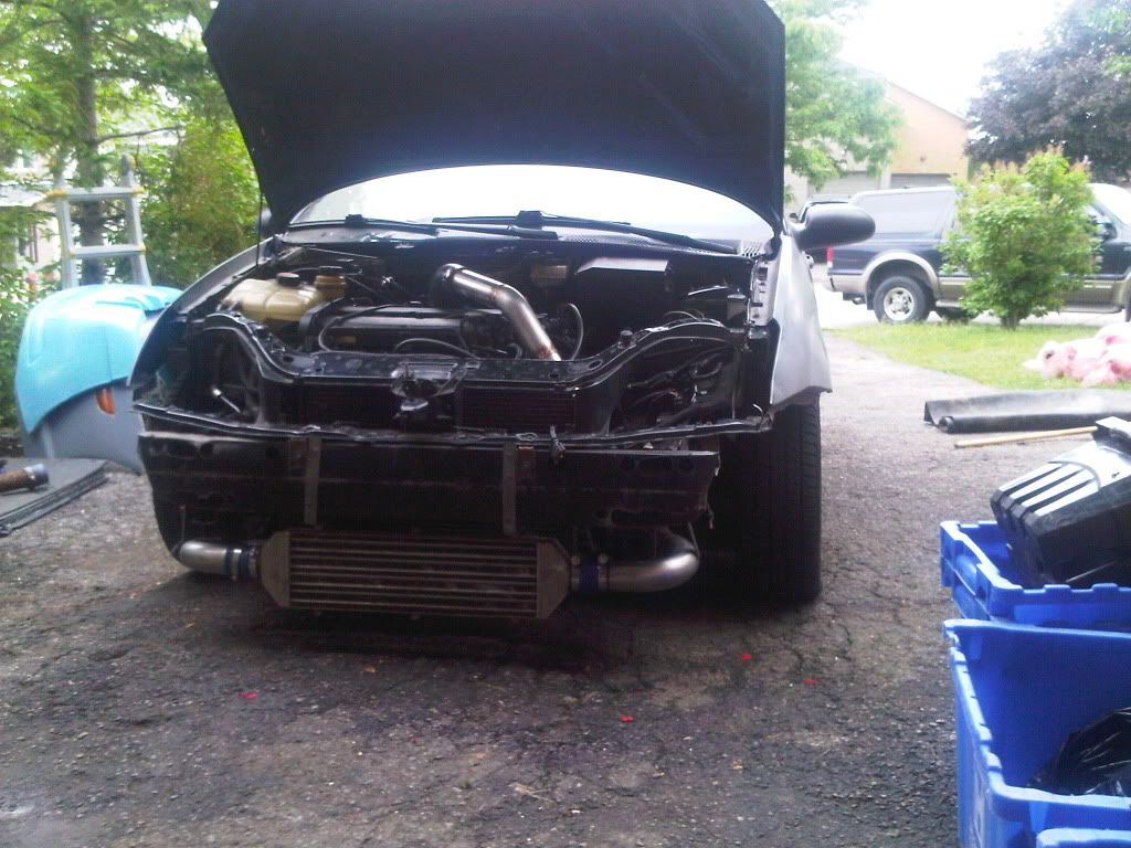

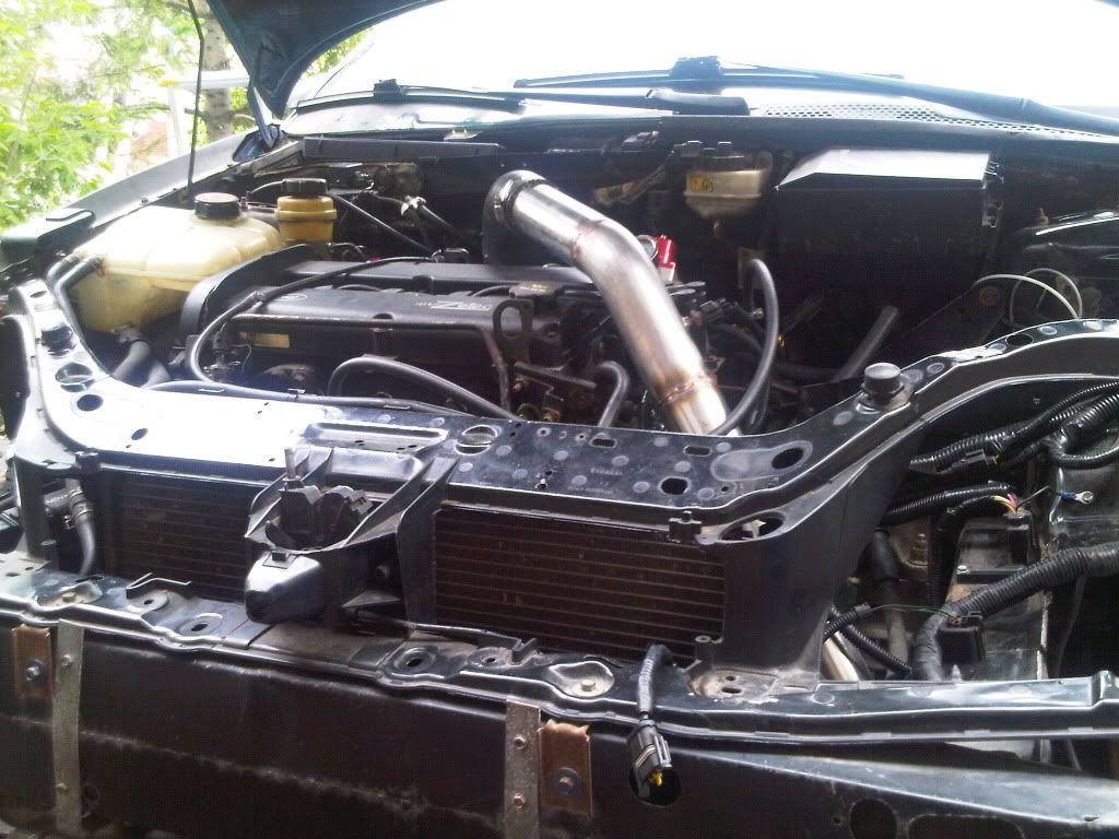

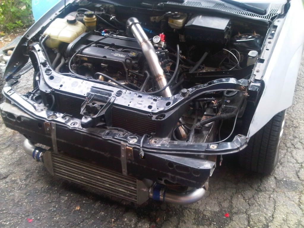

2.5" stainless intercooler piping
Custom -8 fuel system, using stock tank, new fuel rail
custom catch can

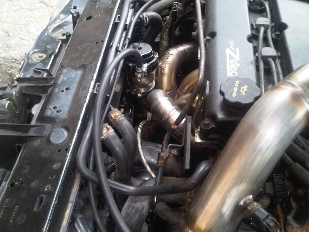

Tial MV-s wastegate
Tial type Q bov (still need to buy)
Borgwarner GM-8 Turbo
42Lbs injectors. (soon to be 71lbs)
Innovate LC-1
Megasquirt 2 V3.57

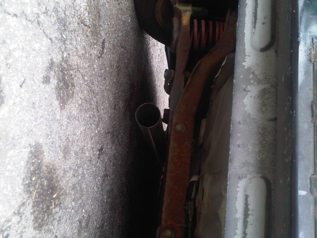

Exhast is yet to be finished, im not sure what bumper im getting so i didnt finish off the tail pipe. and i just ordered a 3" thrush glasspack stainless muffler. also will be making an intake for it this weekend.
now just a short video start procedure of the car, and a walk around along with 6500rpm spark cut ripper.
Turbo Focus Rebuild Megasquirt 2 V3.57

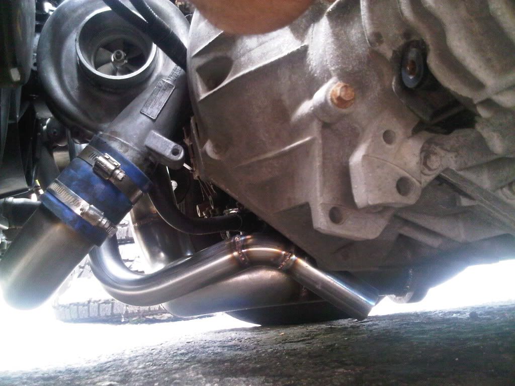

fix your coupler coming off your turbo. It's not even close to on straight.  haha

Cool manifold.
