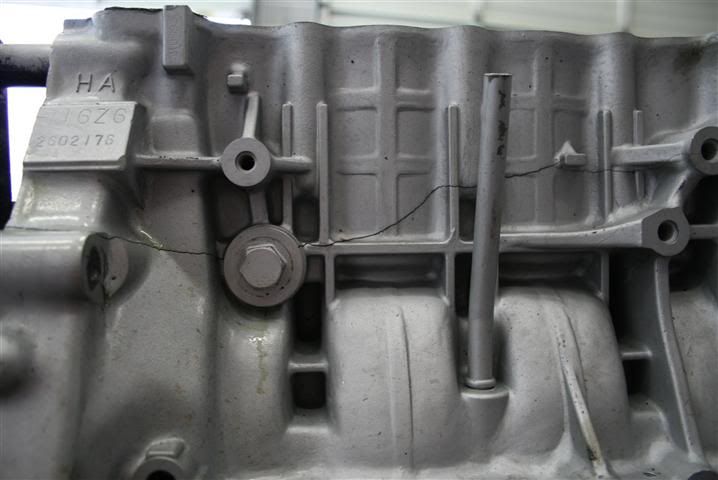

As for the SOHC, we put the big valve head back on the sleeved/vitara block to see what change in power we would get. 1st pass off the trailer this happened @ 45psi in 4th gear:
She coasted to a 9.88 @ 144mph on her final pass. Pretty sweet, huh?!?
Internals and sleeves are all fine, block just couldn't hold the power. We'll be reinforcing another block before getting it sleeved and o-ringed. Then the 76mm 10.6:1 Arias slugs are going in for the big power.  Looking for 160+mph traps this time.  O0
At any rate, I have never seen another honda block break quite like this. Its like it was going to rip itself in half.
Re: "quality" vitaras
« Reply #53 on: October 04, 2010, 11:31:19 AM »
Okay, now that is fucking cool.
« Reply #54 on: October 04, 2010, 11:35:00 AM »
It was fucking cool a month ago too....

And its still fucking cool. I figured JD hadent seen that post, so I figured I would post it up.

JB weld would take care of that :evil:
