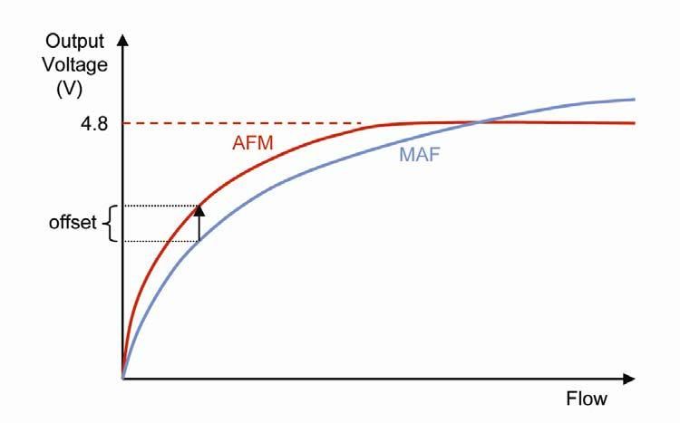

use a bosch sensor at least. Also the air flow curves are similar but not exact. The vane meters top out at 5v MAX no matter how much air its just 5v the hotwire on the other hand will continue to produce small voltages higher than 5v.
http://splitsec.com/products/mafkits/MAFkits2.htm
read the documentation associated with the kits to get an idea.most motronic computers wont like 5+v coming in on the maf signal side.

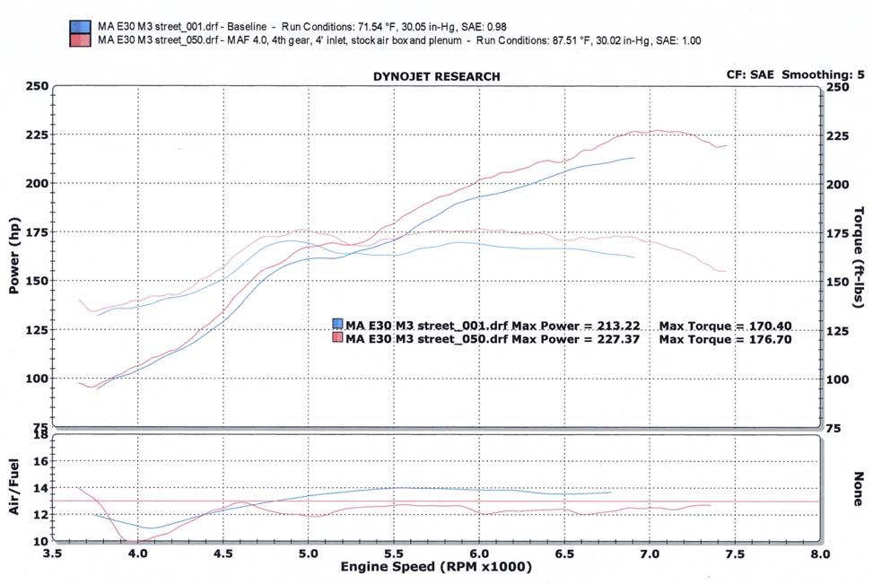

http://14point7.com/UAFC.php
this would be a better option because you can manually just alter the maf signal. It would not alter the signal enough to fuck with timing. They are very close.
Dyno graph of an e30m3 with the vane swapped over to a hot wire. really frees up the intake. I wouldnt be surprised if your turbo spooled much sooner as well.

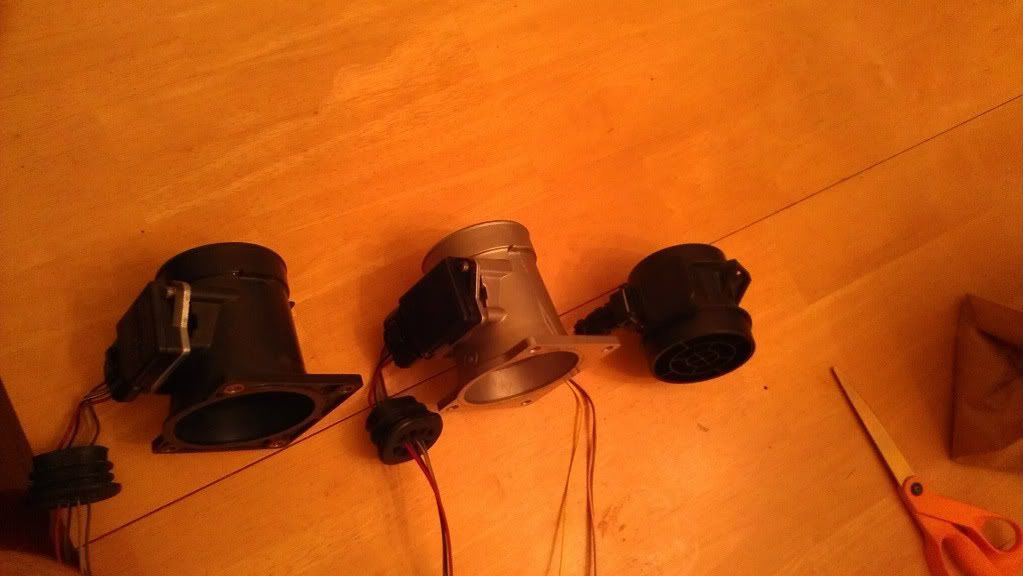

Hit up the junkyard and got a few MAF sensors.
From left to right:
1 Plastic one from a 97+ F-150 4.2L V6
2 Metal one from a similar gen Ford Explorer 4.0L V6
3 From a early 2000s Hyundai Sonata V6
Grabbed the first two because I know the fords used them and I figure I need two to calibrate one MAF to the AFM, using the second MAF as a control.  Then happened upon the Hyundai part, which might actually be the best.  It is same diameter, but takes up less space, and has provisions for couplers/hose clamps on both ends, rather than a flange.  It is a 3 wire rather than 4, which I suppose means it doesn't have a built in air temp sensor, but depending on how this goes I may not even need one.
Looked up prices for these sensors new.  They are all about $100 on rock auto, the aluminum one was the most expensive at ~$120
