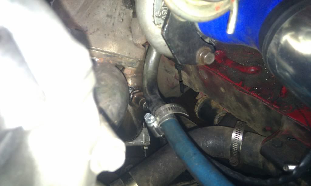

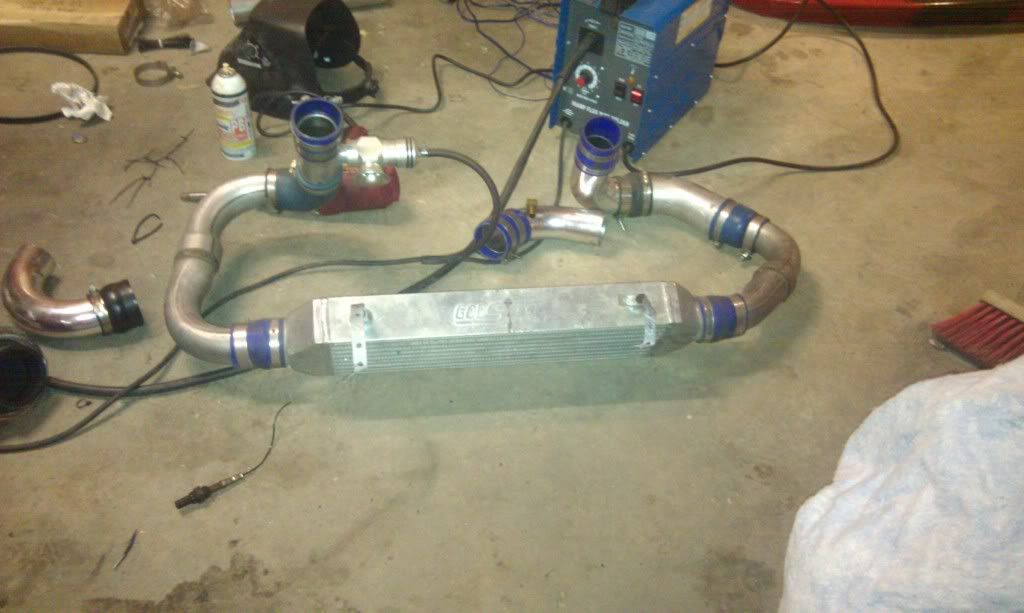

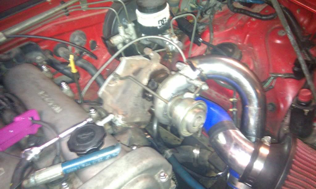

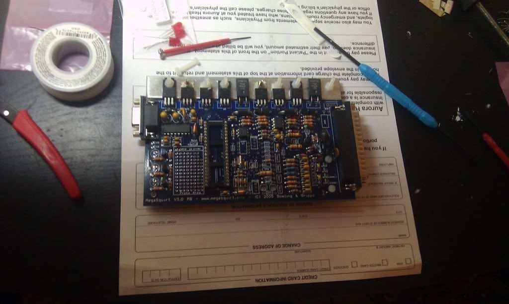

So far I have redone the kit to include things like bolts that all match, gaskets, ya know the shit most people think of. It needed an oil line so I found a slick banjo to -4 adaptor at a local speed shop along with the metric banjo bolt. The oil return leaves a bit to be desired but it works dammit. I also built and installed a megasquirt and picked up a slick new innovative gauge/sensor/controller all in one. there is still a lot of little odds and ends to finish up before I can do some highway rippers but it shouldnt be too far out.
Setup is
Ebay Manifold
13g dsm turbo
rre flange and 2.5" dp
godspeed IC
turbo xs rfl(someone trade me for something less gay and yes a ssqv is more gay)
some denso inj(not sure on flow but pw isnt a whole lot ad its still 11.1 at idle
ok so for some pics

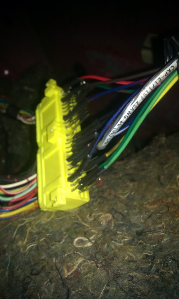

No Haggard ass wiring here

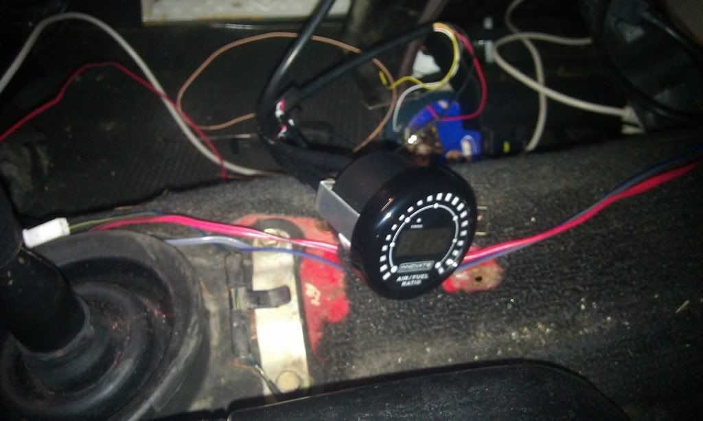

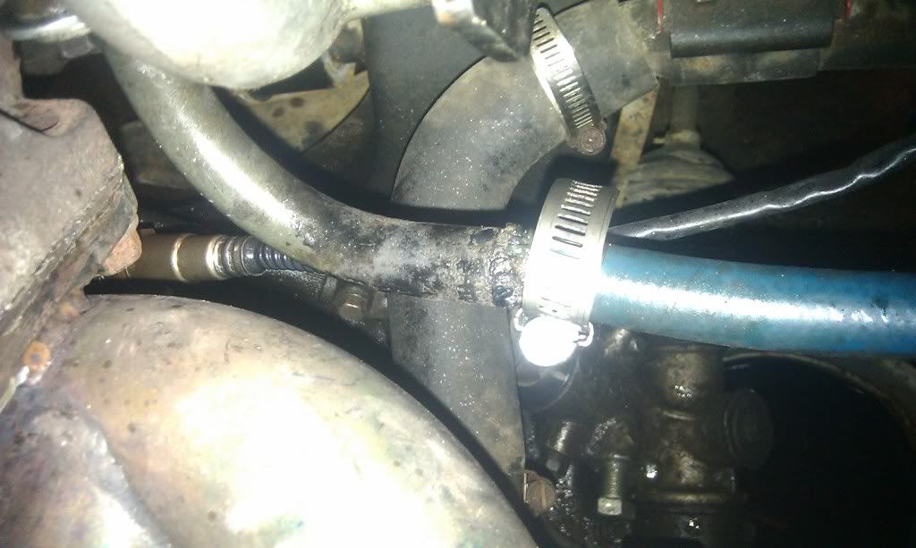

:?: :mexi: :mexi: Had to make sure it wasnt lean so some 2 min wiring needed to be done for the wb

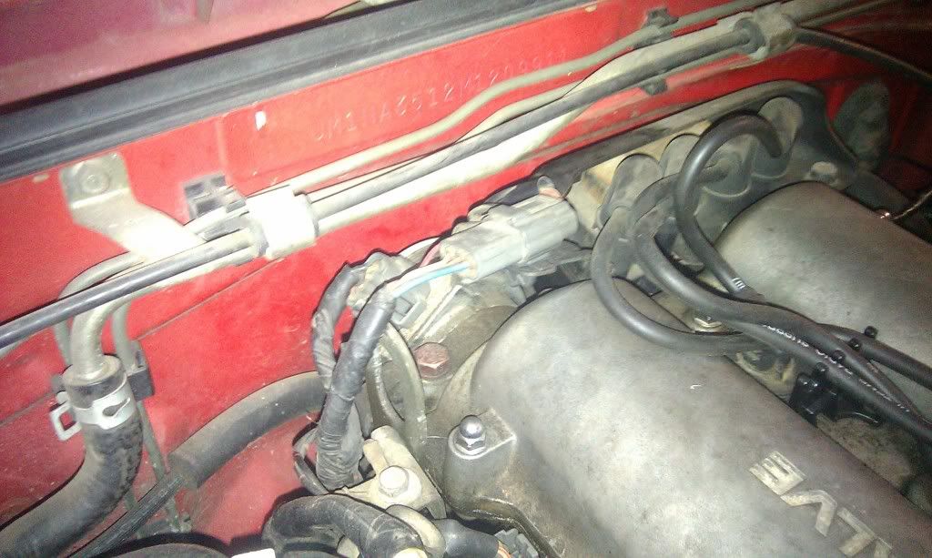

All stock ignition components

Crush bent intercooler piping?     I like it!

Also got all the interior put back together what a bitch that was with the 6 big ass cables coming out of the wideband.

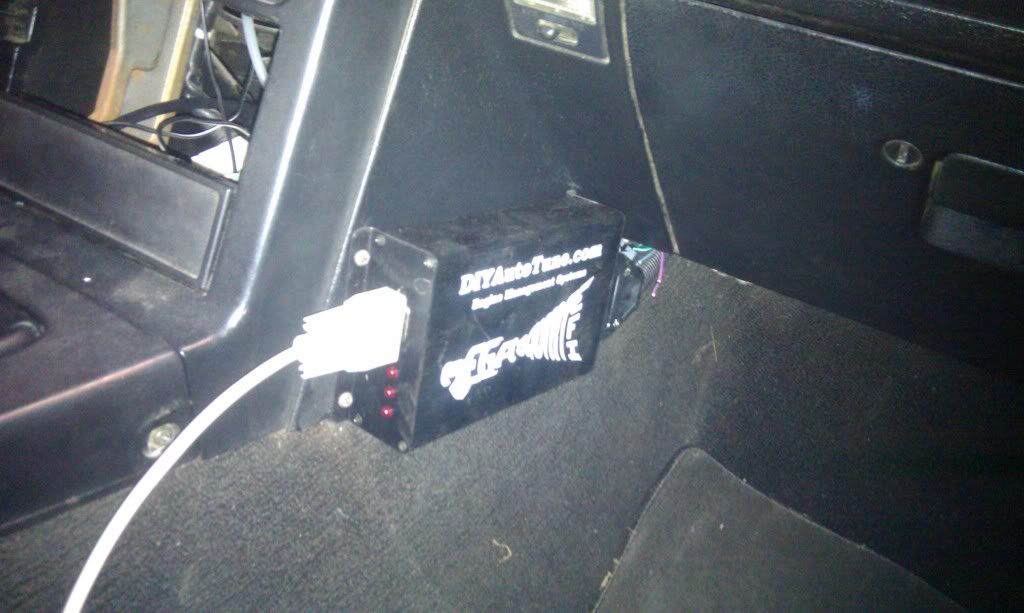

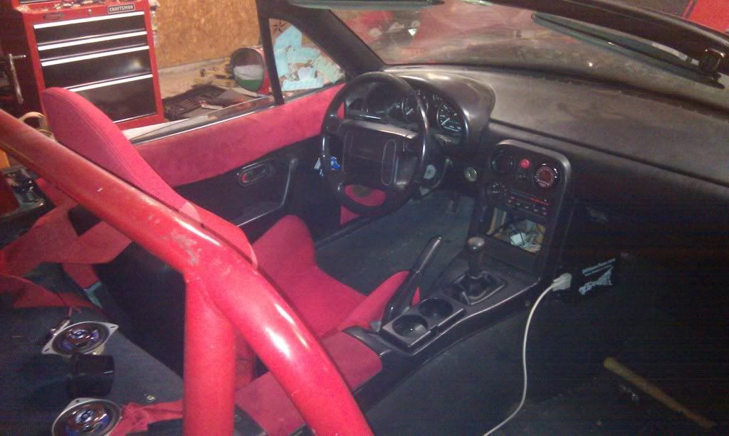

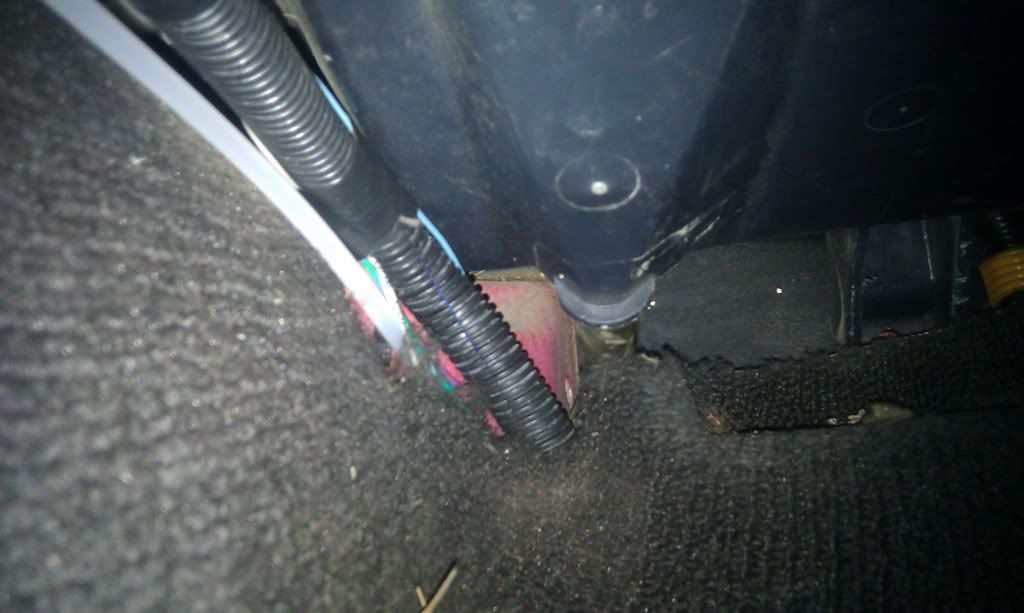

Finished up my dash more or less Need a radio or a block off plate havent decided.

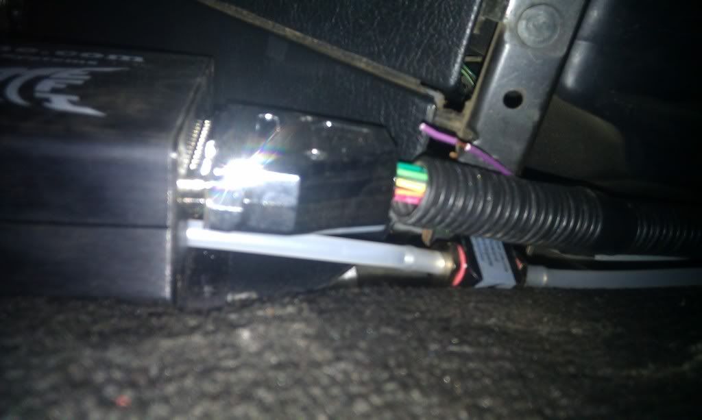

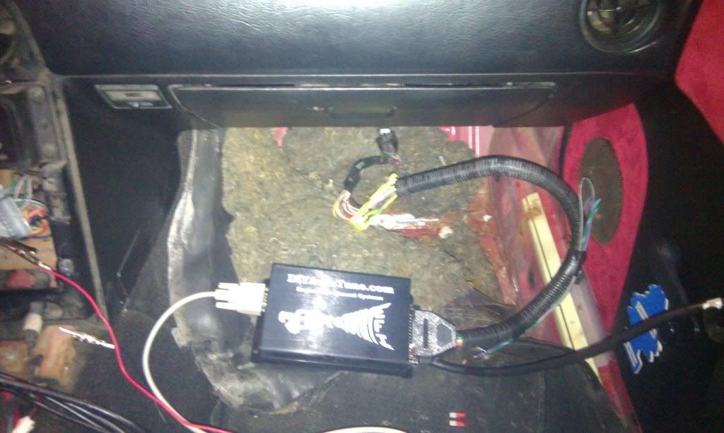

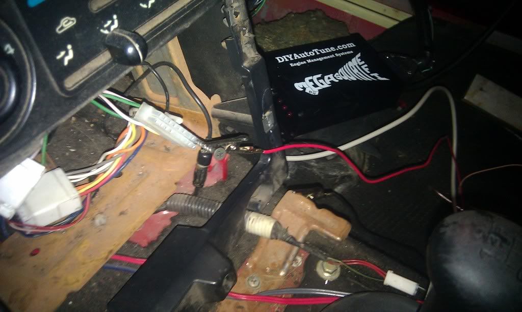

Decided this was the best place to mount the MS easy to unplug to flood clear/compression test etc. Also i dont have to pull the carpet up if i wanted to update firmware etc.
Just the harness that goes to the MS fits perfect in its current location. I wrapped the connections under the carpet and factory ecu cover with a chunk of a sleeve so nothing would short out. You can also see the dedicated nylon map sensor line I ran.

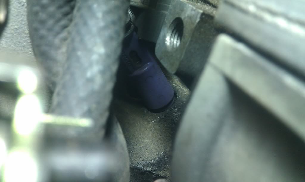

another shot of the map sensor line. Needed a T so I raided this shitty old boost controller I had and took the ball and spring out of it so its just an open T the line goes to the boost gauge.

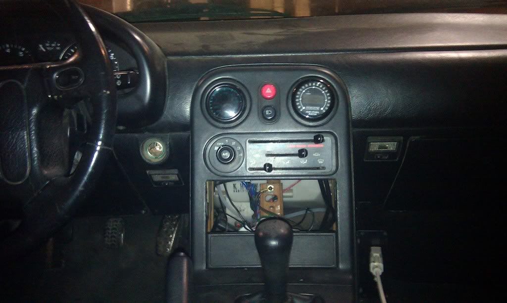

Stuck the gauges in the center vent holes WHAT A BITCH with that wideband since it has all the sensor and software cables exiting it as well had to mod the vent tube quite a bit to get everything to fit "right" and the ricer illuminated boost gauge.

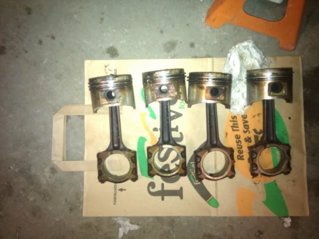

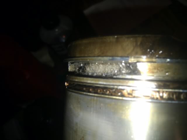

Ok so upon getting everything on the car that bolts to or controls the engine 100% final and verifying no leaks etc. It came to my attention that the car had REALLY shitty compression numbers. Without taking the motor out(would have been easier just to. I managed to drop the subframe and raise the motor to get the pan off. pop out the slugs and I am greated to 3 pistons all with this more or less.
In typical ricer form I got such a great deal on the car because umm yeah it was blown. The block looked dandy with no big scuffs or any other nonsense.
So I went to my local jy yesterday and for 50$ pulled out these
They were all dirty nasty sandy and muddy by the time thy got to this photo but once cleaned up they look to be in nice shape. these are out of some pos 8v sohc 323 and the rods appear to be just as beefy as the stock miatas and the pistons have a bit more dish to them. they dont have the right valve reliefs but according to a few sources the dohc head will fit no prob. plus i am a firm believer that if I would have gone with all new shit the motor would have blown up within a month but because I am using all used shit and tossing it together with all the miata bearings,not checking a single clearance and not even taking the rings off the motor will run hard and forever. Tossed them in last night and going to get it all buttoned up this weekend while the snow continues to fall. ::)
