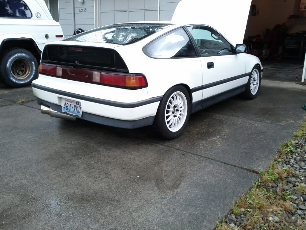

This is with 2.5" and cherry bomb turbo muffler:
Integra 92 LS stock internal turbo at 10psi 0 to 190km/h
I can't find the link on canadiantire website, but they used to sell the muffler for 35$ and they have a 3" form. It fits pretty well under 90-01 teggies.
