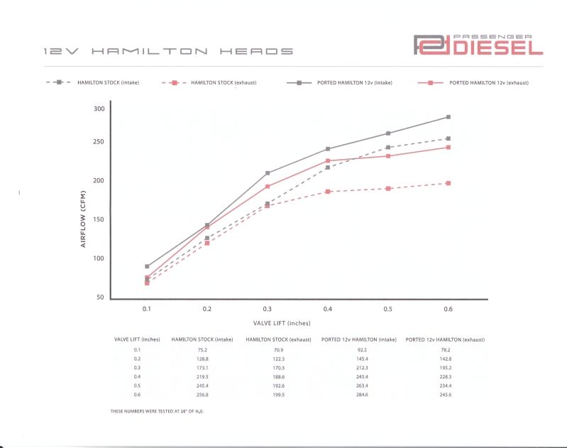

Houston we have airflow:
Re: My winter project (1350whp Bitches)
« Reply #31 on: May 22, 2012, 06:36:45 PM »
Very nice, I think our turbo's just became too small.  :o
Looks like it flows as well as the hamilton head.
« Reply #32 on: May 22, 2012, 06:47:17 PM »
Actually it flows a lot better then the Hamilton head, everywhere:

@ .5" lift the ported 24v w/os valves out flows a stock 12v by 160cfm on the intake and 112cfm on the exhaust. That is big difference in airflow for the same displacement bottom end.
