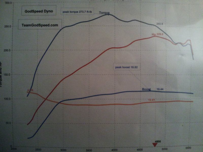

Definately need some way to tune this hog and bigger injectorators. Graph looks like shit.
http://youtu.be/7mckxfmxm_I
Does the graph look like timing is being pulled to you guys. It does to me. Also looks like there may be an ignition problem.

Not bad, but can't help you with what a volvo dyno should look like. Stock injectors should be ~310-315cc, and looks like you're very close to maxing them out.
I could sell you a set of five 365cc injectors and four uscar-jetronic electrical adapters for a decent price. You'd have to buy the 5th adapter on ebay for a few bucks. Otherwise I might have some USCAR clips you can have. I might have some a bit larger as well in the same size, 425cc IIRC.
