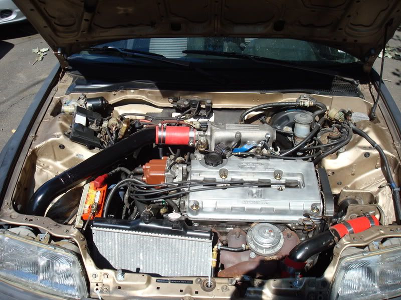

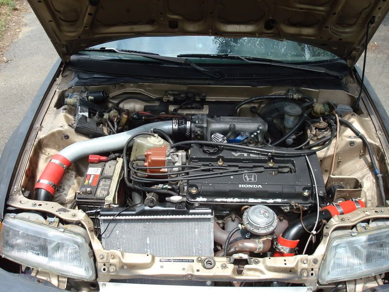

the setup:
-b16
-ebay 57 trim
-turbonetics deltagate
-tunertoys oil lines
-jrc 8" intercooler
-precision 680cc injectors
-cast manifold
-charge pipes, downpipe, dumptube welded by me
-xenocron chipped ps9 ecu tuned by me with bre

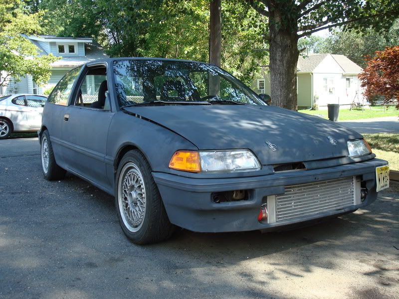

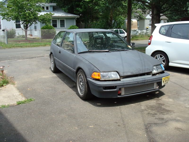

also cut my bumper a few months ago because i was over heating and was doing everything i could to get more air into the bay
my hood latch cable also stretched like crazy so i threw on some hood pins because it was cheaper
then redid my charge piping because i was using an old intake before and the clamps kept crushing it

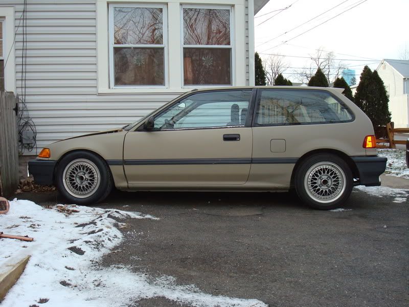

repainted my shit box and bought some drag radials

add some ducting to force air through the rad and you will be much better off.
it will just take the path of least resistance which is around the fins not through them
car looks 10000x better with the puke/shit colour over black.  nice job.
thanks but honestly it runs on the cool side now so im not too worried about it

i love this car, new color owns, flat black sucks

No heat issue with the radiator on the manifold?
