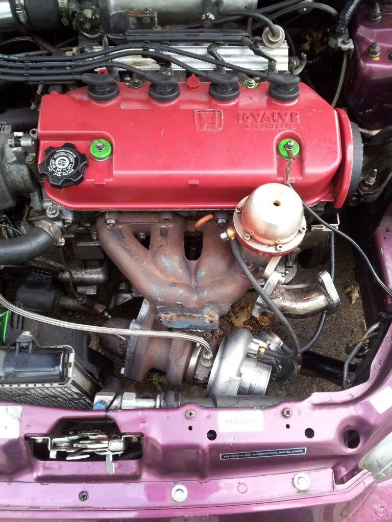

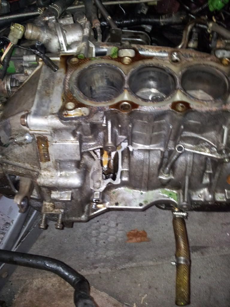

245k on now blown motor.  12k on the rebuild. e85 powered.

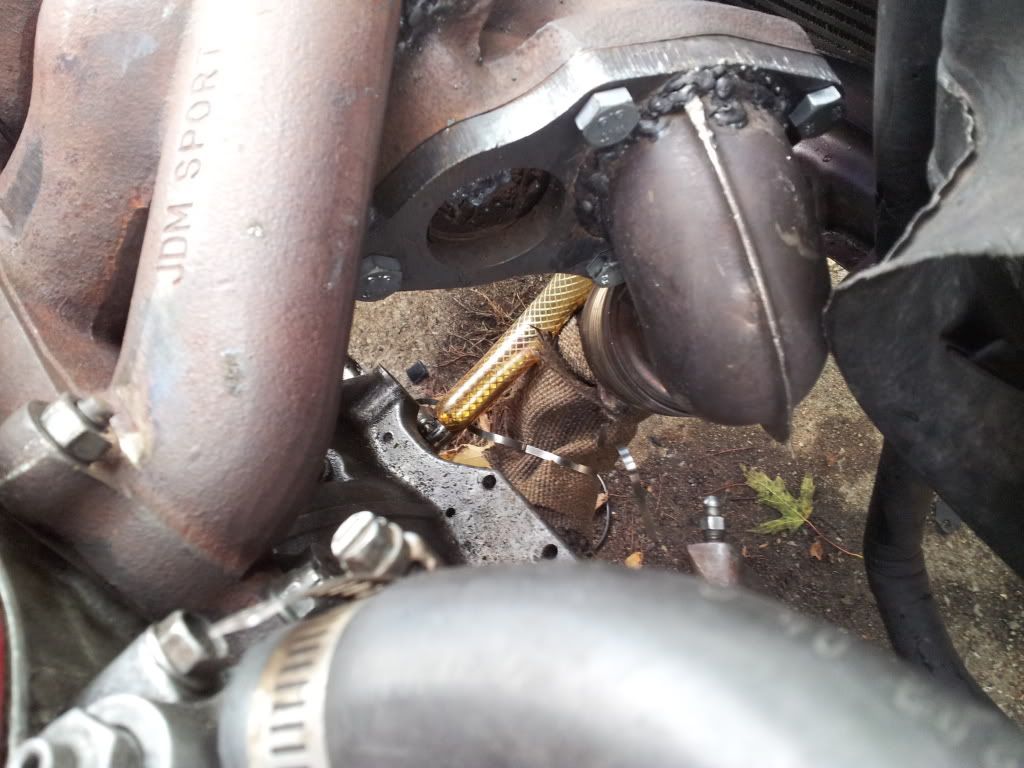

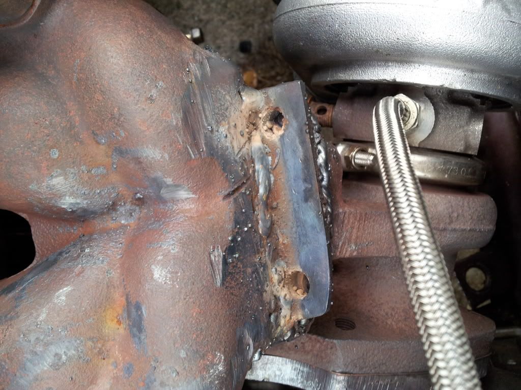

dsm 13g with volvo compressor housing. turbine housing welded to the old t3 cast manifold.
pop the engine with a lean miss fire. 11-13psi spike and stock fuel pump couldn't keep up.

damn, there is no penetration in those welds. lol. nice job

Well done welded turbo to manifold=win!
