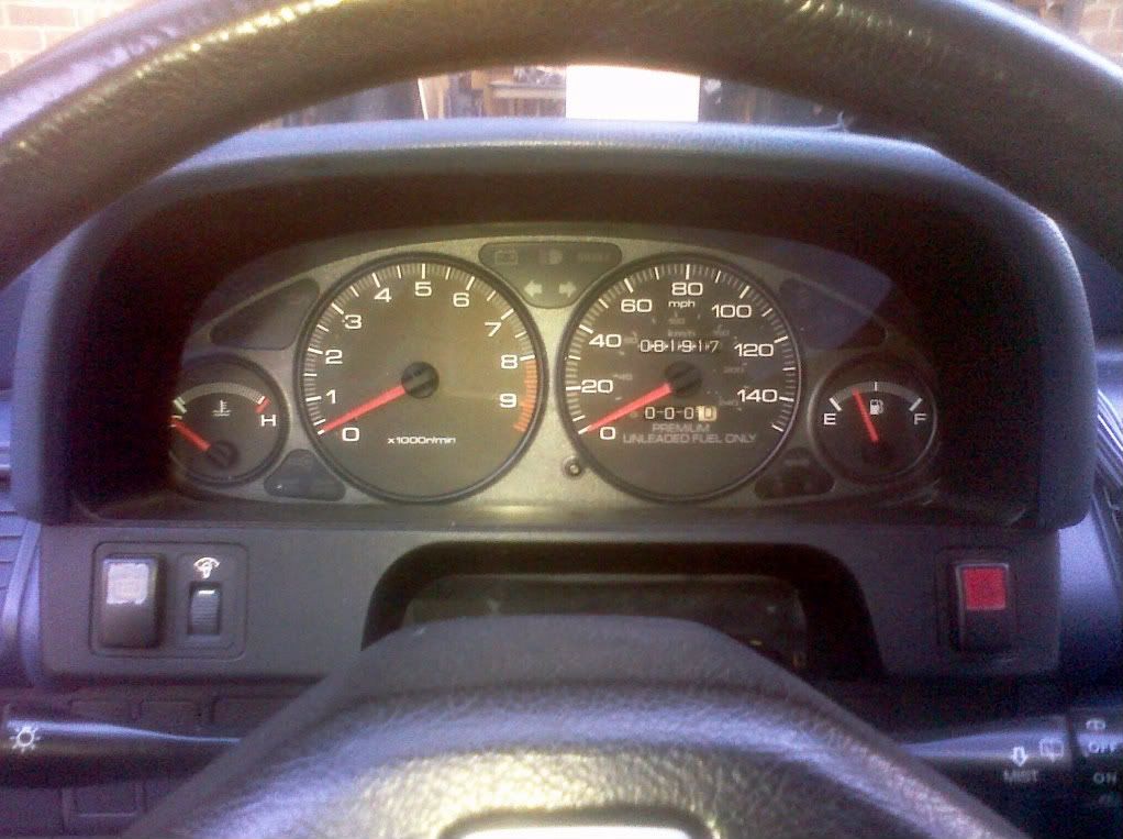

1988 Honda CRX HF
so shit I have noticed:
bouncing tach
dim clock and cluster lights
with blinker on I get a buzzing from cluster area
engine stalls w/clutch in...starts right back up
coolant drops to 1/4 cold
not consistent.

Try re-seating your cluster plugs while you're at it, or get rid of it out right and wire in a 94~01 teg or 96-00 Civic cluster. Both fit pretty well under the stock 90-91 rounder cluster bezels. I haven't had a stock cluster in my ED/EE chassis vehicles in ages. It's usually the first thing to go...lol
Cluster in my wagon, 00 Integra GSR
Cluster in my CRX, 90-91 bezel with 99 Civic SI cluster...It'll fit under the 88-98 squared off variant, but it obscures the edges a bit. You can kind of see it there...I'll dig around to see if I can find a better photo, that one is pretty old.

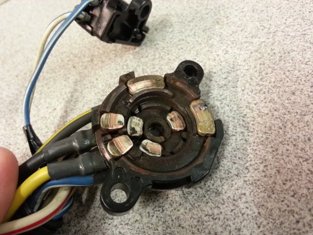

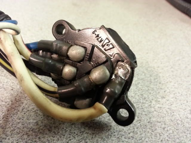

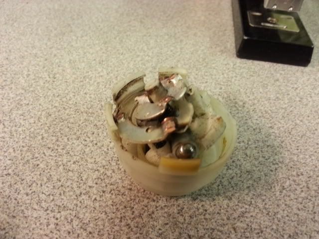

« Reply #22 on: February 11, 2013, 05:03:55 PM »
as an update. I hate cars.
had to get towed the last 2miles to work this morning. little smoke from column area when I checked my wipers on. min later she stalls out in traffic and won't start. main relay going crazy with multiple clicking and/or lower buzzing/humm.
swapped main relays real quick at work. no change and after fucking with it and staring for a while. I grabbed and ignition switch and plugged it in real quick. once again seems to be running fine........for now?

« Reply #26 on: February 12, 2013, 01:58:12 PM »
The switch in my 88 did the same thing to me about 5 years back, I swapped it all to a toggle switch/push button start setup for a bit till I found a key matched set of ignition switch/locks etc to put back in the car.
Or you could be cheap and clean the contacts + slightly bend in those W shaped contact pads and see what that gets you... had to do that in my Integra outside of work one day.

« Reply #27 on: February 12, 2013, 02:20:44 PM »
that all a lot of work... its 52bucks for a new switch, that we had in stock  ::)
