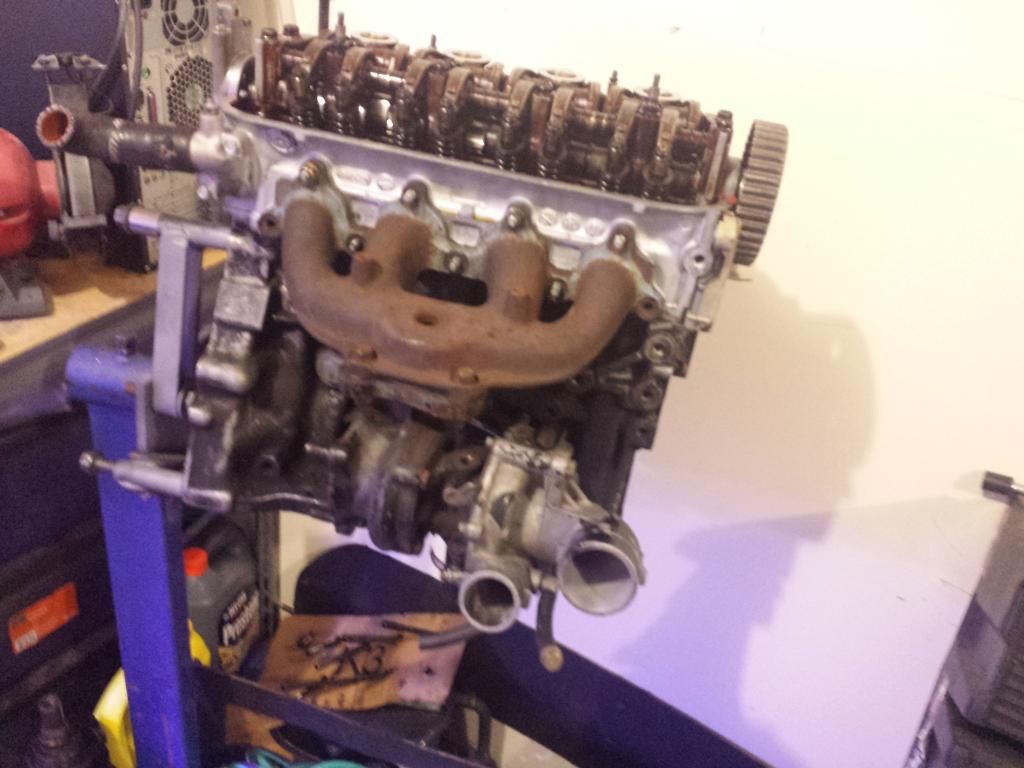

old block and head i mounted just to do the down pipe outside of the car.

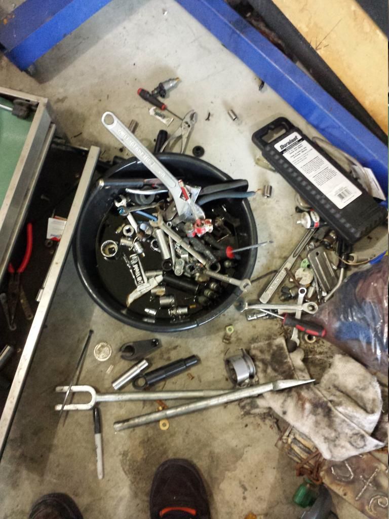

dumped damn near all my tools into a oil drain that had maybe a half inch of oil in it :/ fawk

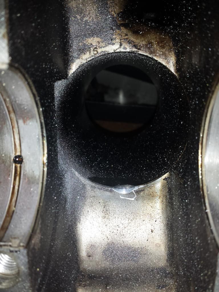

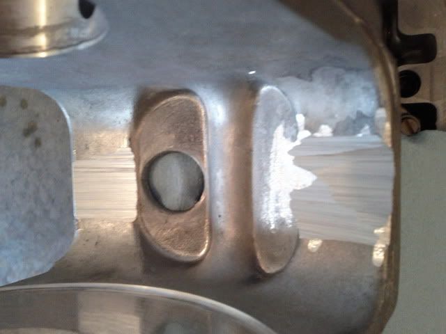

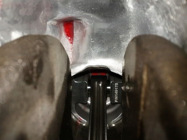

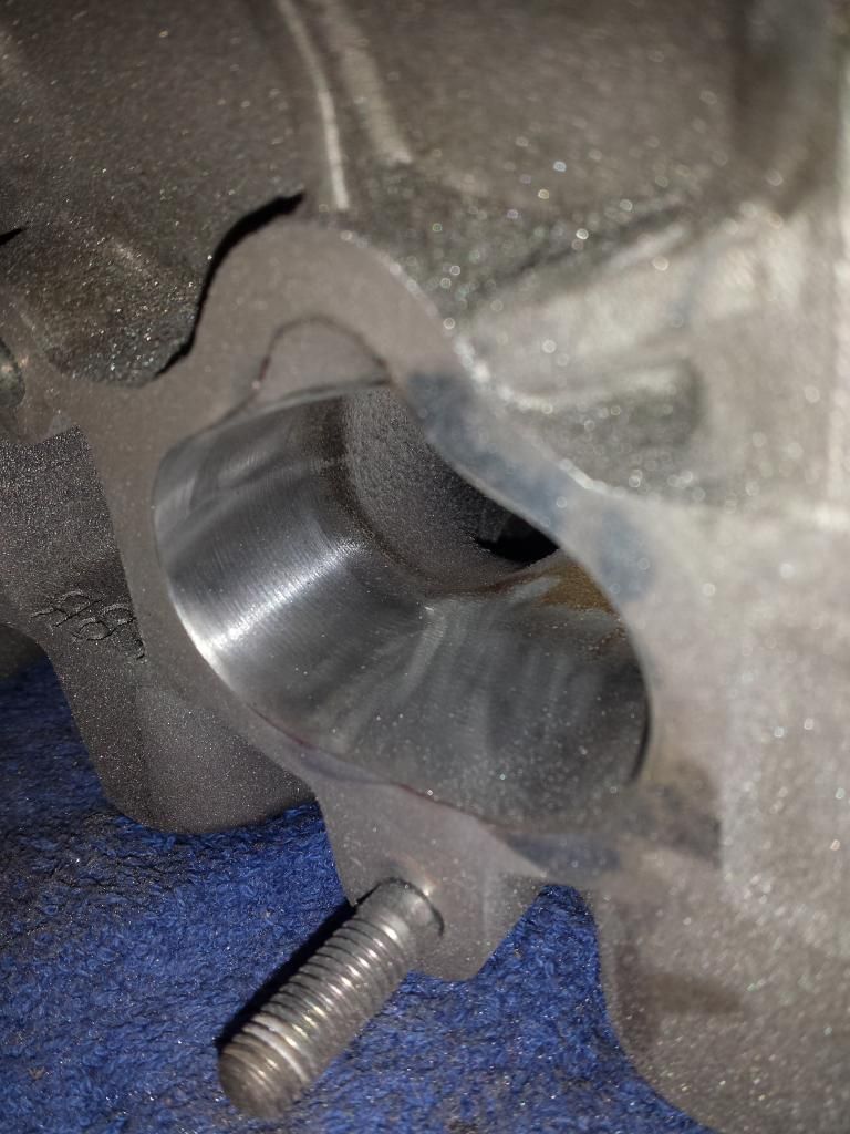

started notching ONE of my 3 I think zc blocks. just to see what it was like... didn't think itd be that easy. have to do alot more once I get some rods here.

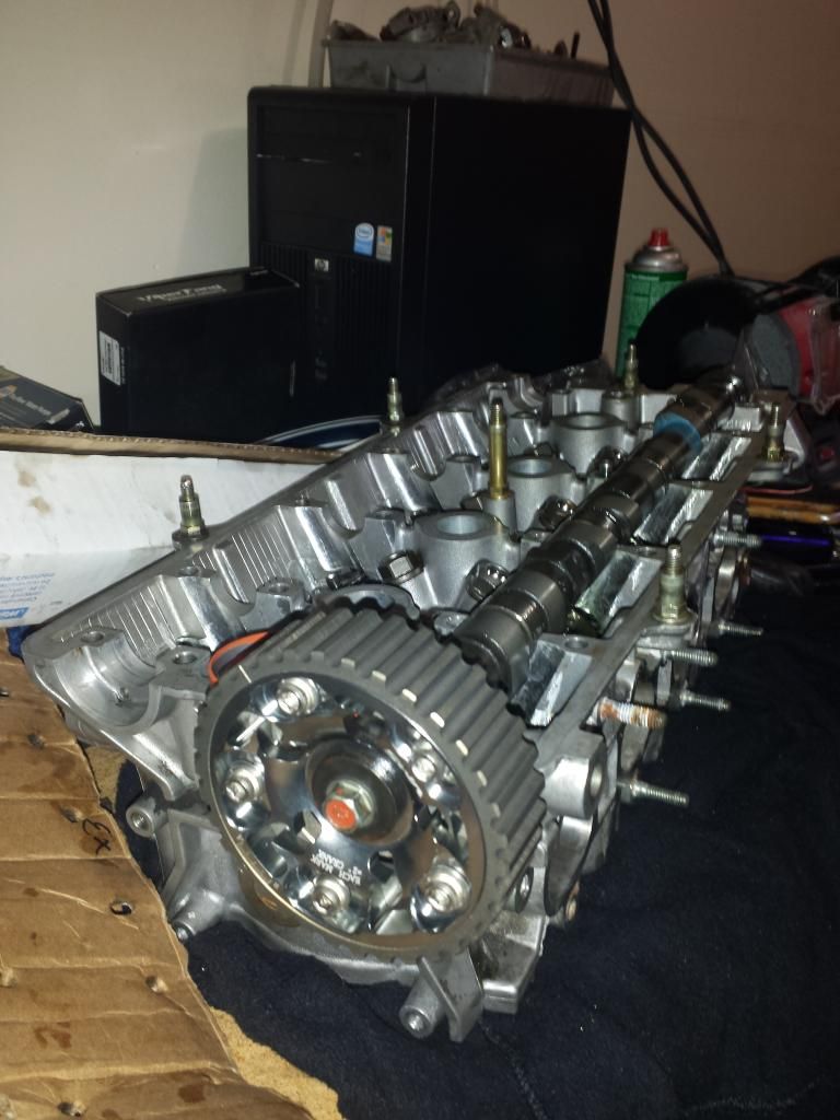

built a head for my brother in law.  P8r b20 head, supertech sprangs and delta 272s
cam out okay i think. he likes it. says it pulls.

this post sucks.
and not because of lack of porn either.
you need to hack a lot more of the block to clear the rods. and the last one i did required hacking a lot of the girdle also... good luck.

Yikes. I don't have much of a choice with d series.
Is that from not taking enough?

Those rods are from some retard grinding the rods instead of the block, lol.

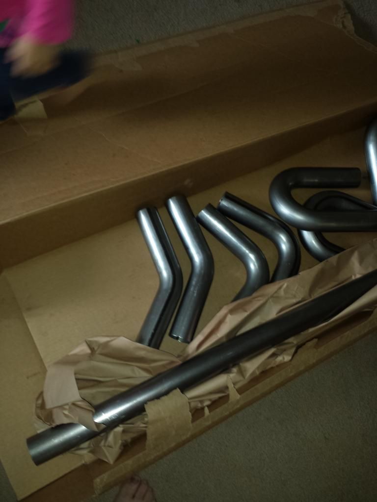

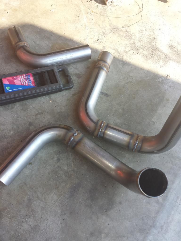

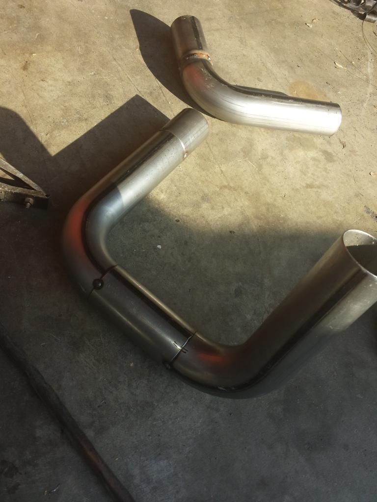

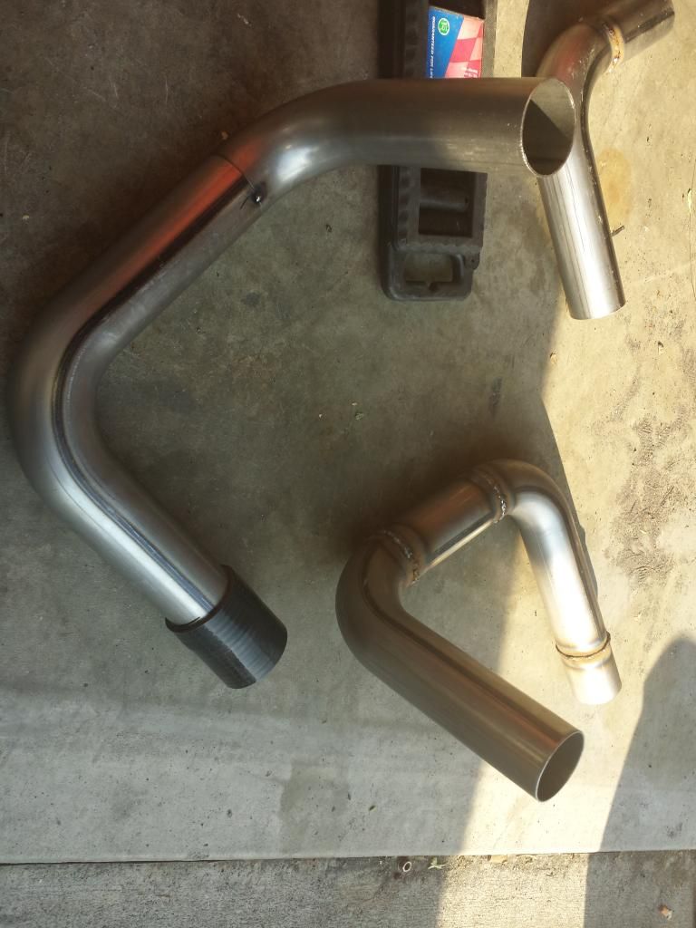

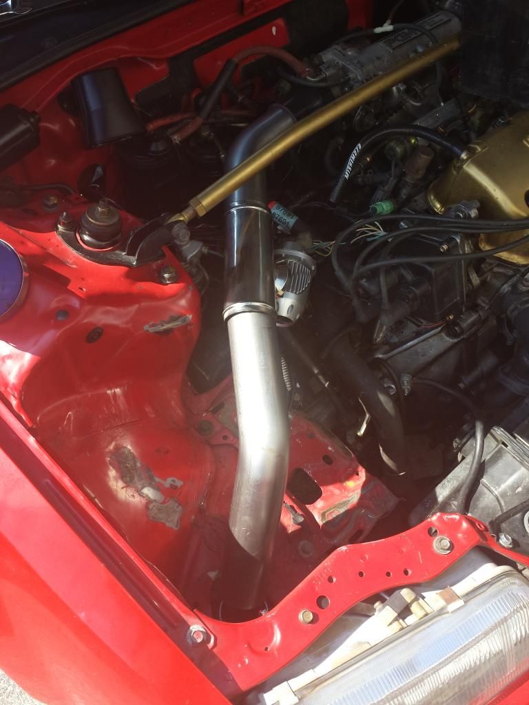

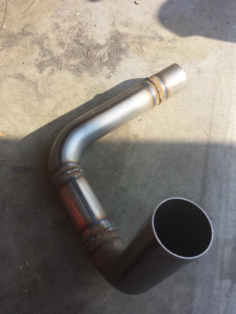

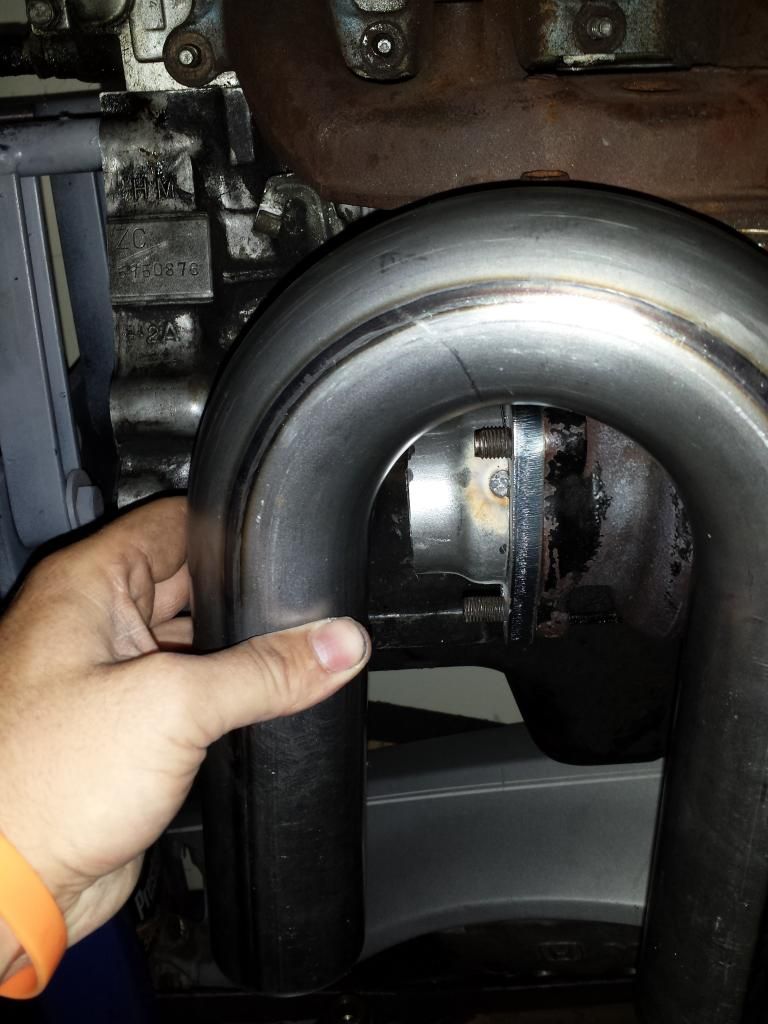

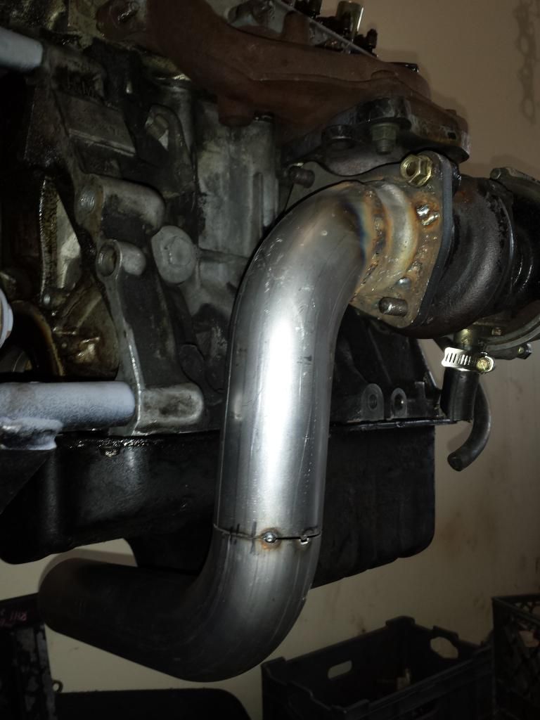

so here I am. Finally ordered all my piping couplers and pieces I needed.

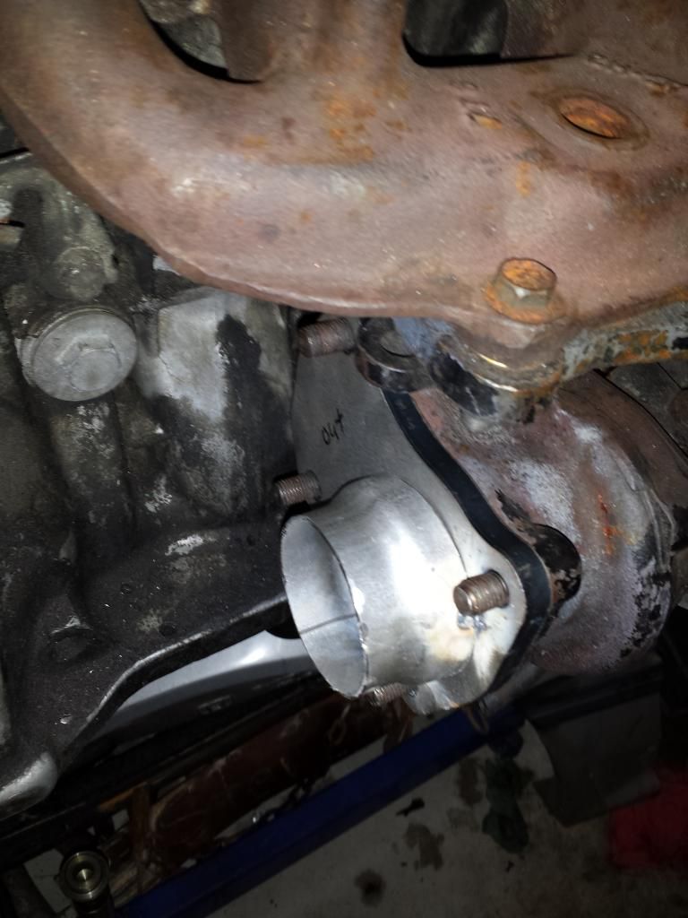

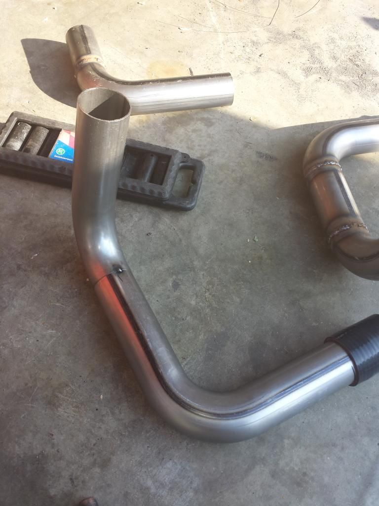

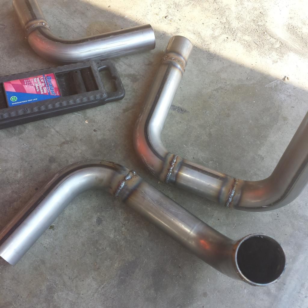

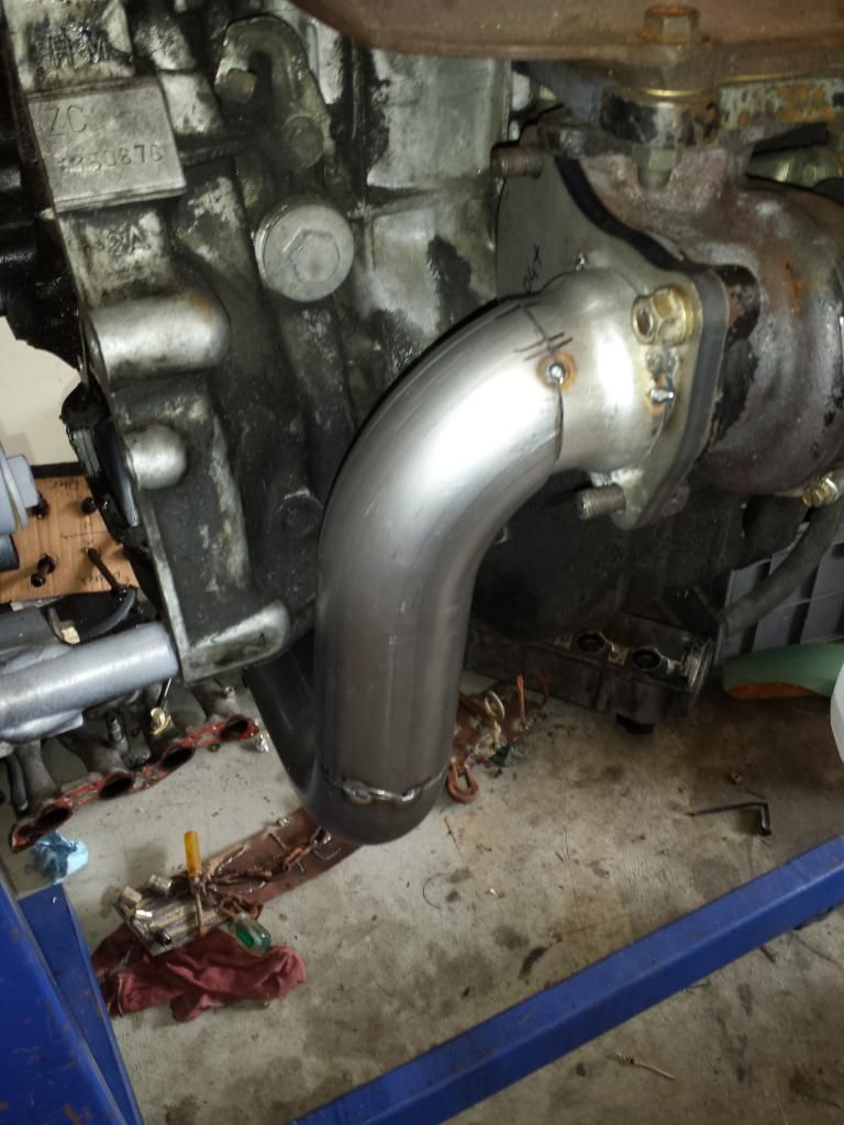

columbia special. 2.25" for now just to see what i can do :/
Dunno wtf I am doing so I tried it all. I was scared to chop
kinda got it pointed where I wanted .... I think ?
Figured the top side and the reducer were not going to move so I splattered some shit
KInda it for now, Im going bowling tonight to drink so beers so I quit early.
Plan to finish the DP tomorrow, maybe remove the bumper and have the intercooler mounted, maybe the cold side mocked up... dunno. Im in no hurry, I need to find another beater as a commuter. for work, and incase this shit getts outa hand.

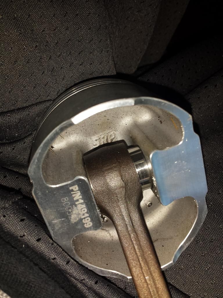

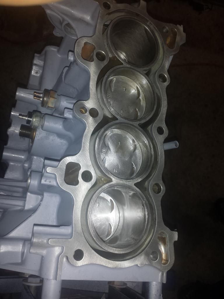

ON a awesome note.... I was planning on Vitaras, welll I came across these " new " pistons for hella deals.
Woke up at 330 am and drove 2 hours one way to get them. ( still deals )
baby JEs " SRP " forrrgied. should be greaat. Supposedly they're " NEW " but they've been pressed onto z6 rods. which they have to go... but they look flawless. minus  a little nick probably from being in a box for so long tossed around?
dunno I measured them with a micrometer and they were all straight and I was happy.
So I bought em.
 ;DDD ;DDD ;DDD ;DDD
should be fun. When I can put big power with those in a different block.

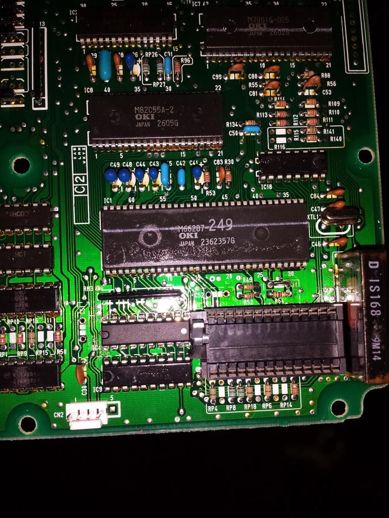

Heres a p06 I socketed and chipped and tuned for a b20.

Going to get a bottle so I can make it semi nice. My welder sucks bawls. CRAPSMEN
Re: EFin basic DX
« Reply #12 on: August 15, 2014, 10:31:16 PM »
downpipe looks way to easy to be right lol

Anyway. Do you guys reccomend putting a flex pipe into the bottom of the downpipe where it connects to the "cat" flange.
Buddy told me I should put one there. Thanks

I didn't and busted my do off the exhaust flange when I had soft mounts. I have solid steel now and no problem.

Yes put a flex on it.

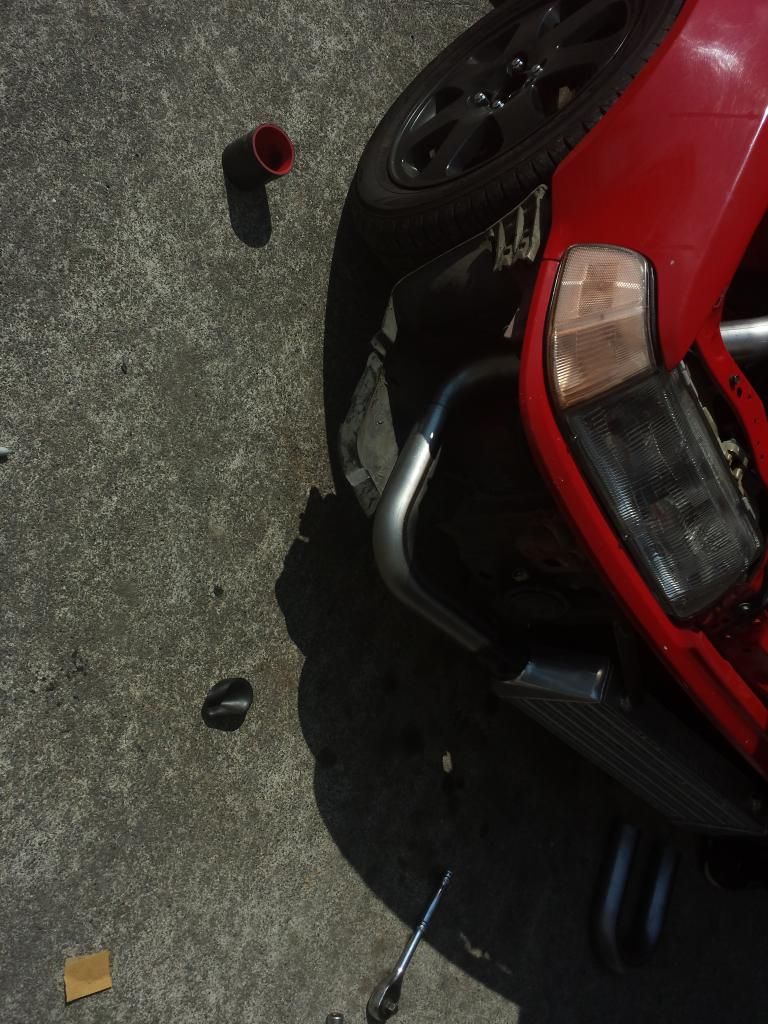

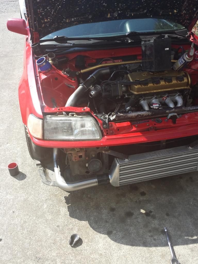

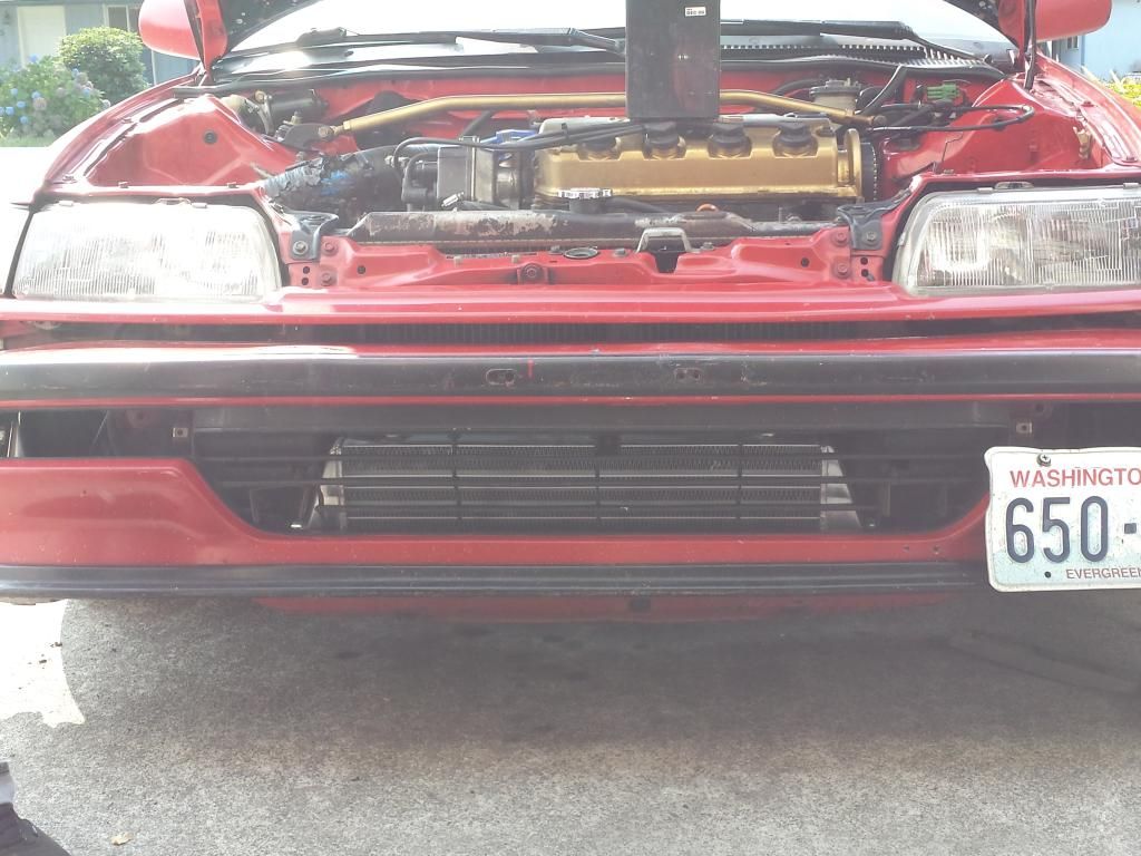

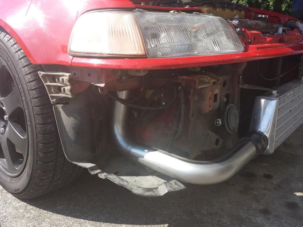

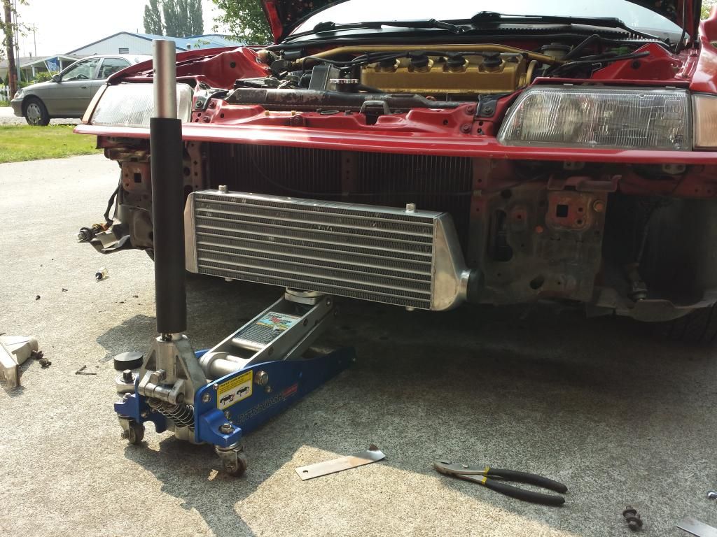

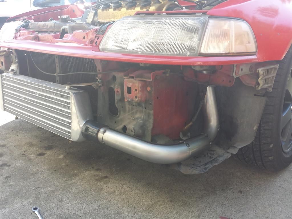

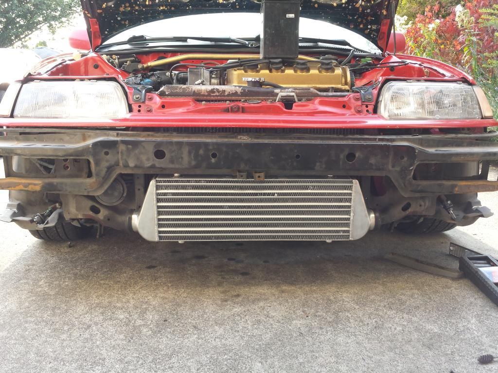

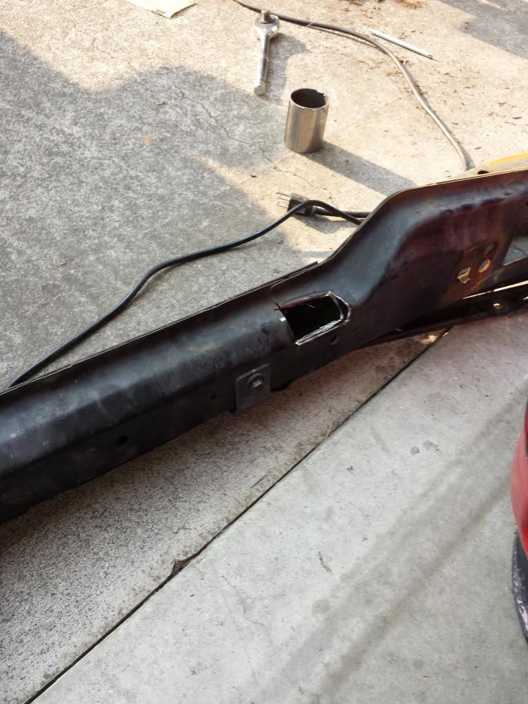

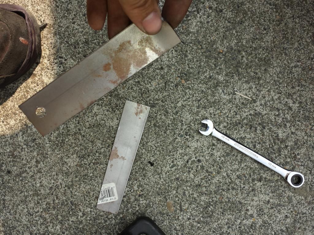

made a little bracket...

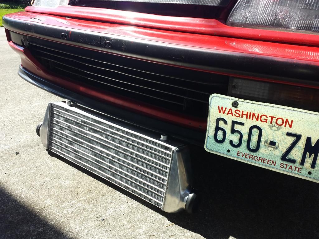

preview with just the skin on.. my buddy was giving me shit because I put the brackets too high... :?
fixed
bumper support fits, bumper skin fits. intercoolers mounted.

need to flat black it

wow, looks good.  :mexi:

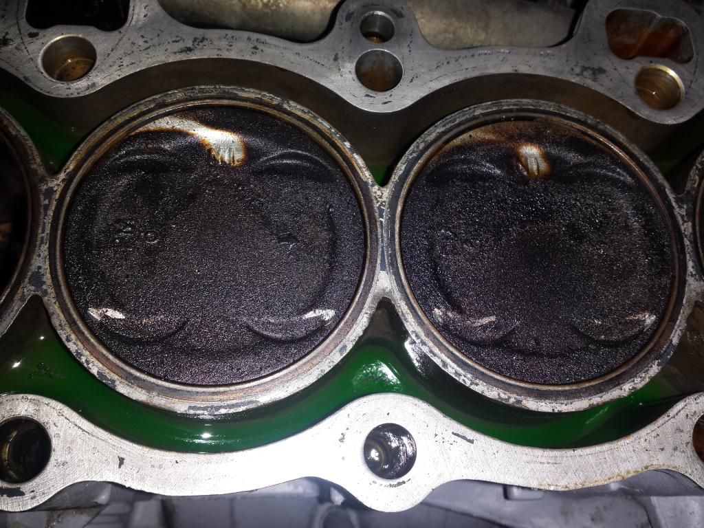

When I pulled the pan to swap for the tapped one, I found a SHIT ton of bearing material. I was really worried so I pulled all the rod caps. All were perfectly worn looked new, not even a scratch.
So Im thinking either we didnt clean the pan good enough, it was in the pick up or my mains are fucking mashed.
We shall see. :D :noel:
