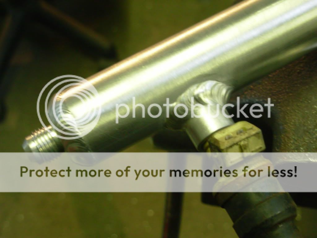

Here is what I did for the slappymobile. We have piles of the injector adapters for the 14mm bosch injectors to the smaller honda injector holes. I just drilled some holes for them into a piece of tube and welded them on.

This is what I did. Cheap and easy. Found the proper drill bit on eBay for like $8.

I drilled and tapped the rail then made brackets that bolted to the holes and bolted to the intake where the stock rail mounted.
Search 14mm drill bit.

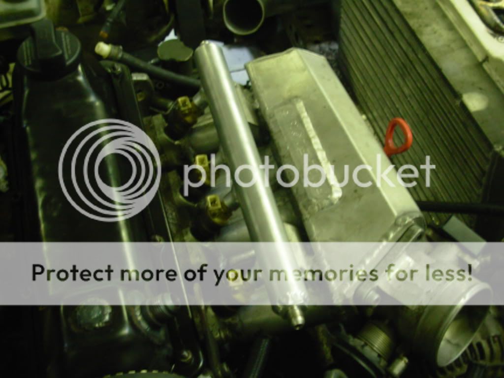

« Reply #15 on: January 31, 2014, 10:50:39 AM »
I did the same thing.  no welding other than a mount bracket for the fpr.  made little brackets that bolt it all together.   you can see the bolts holding it to the intake mani and the bolts go in the bottom of the rail are m6.
